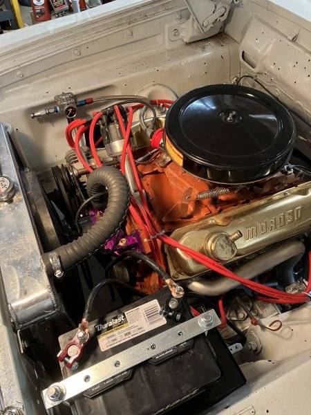

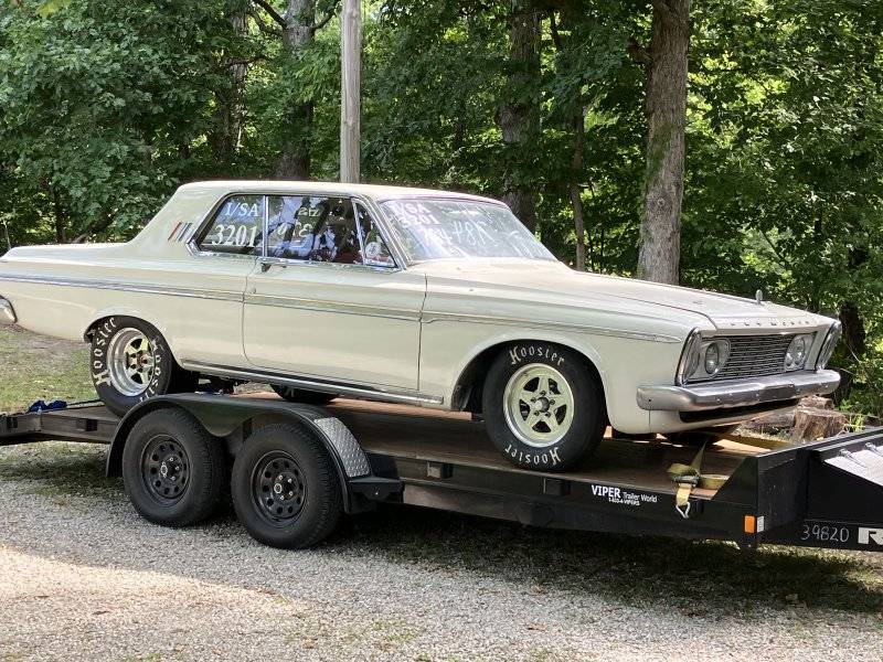

Finished the Sport Fury today with the exception of a crank pulley that should be here Tuesday or Wednesday. Going to KilKare outside Xenia Ohio next weekend to race with the Buckeye S/SS group for their final points race of the season. Only have 2 passes in the car and they were 1/8 mile. Anxious to get some 1/4 mile passes on the car.

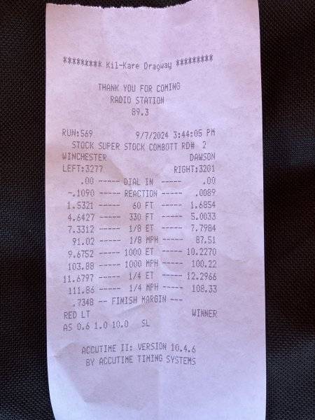

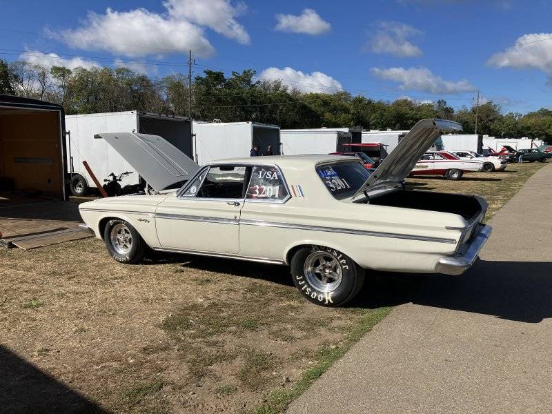

Overall a good weekend with the Buckeye S/SS group at KilKare. First time I've raced a different car other than my 79 Aspen with this group. Made 2 good passes with the Sport Fury but for some unknown reason I backed out of the 2nd run early. Not sure why I did but I'm almost 70 so I'll blame it on an old farts "brain fart". Paired up with for 1st round against my friend Derrick on Sunday and just as they were pulling us out to the water box my break pedal went to the floor. Limped the car back to the trailer, the culprit was the junction block on the rearend housing has a small crack. Whew! So thankful it happened before we made the run! The engine feels strong, I'm sure the car will run 12 teens as it sits but the biggest gains wil be with a good trans and converter. Should run at least 11.80's maybe quicker.

Yes it is a natural G car. When I take it to an NHRA race it will have to be moved up to H. This was a S/SS combo race which doesn't scale the cars or fuel checks. They do require that class cars run under their indexes though. I didn't think it would run under the H/SA index which it didn't. Therefore I chose I/SA for this particular race. If everything goes as planned I'll move it to H for the Fall Classic at Indy next month.
