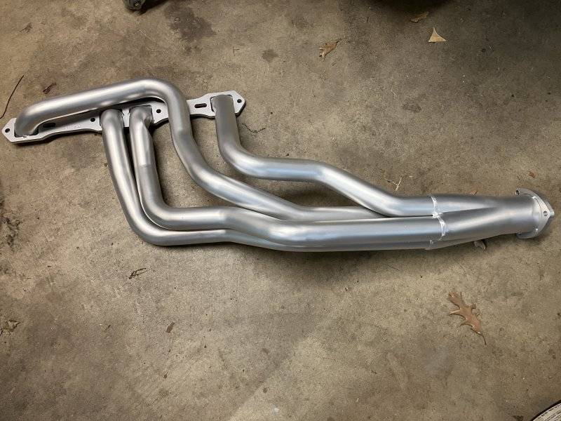

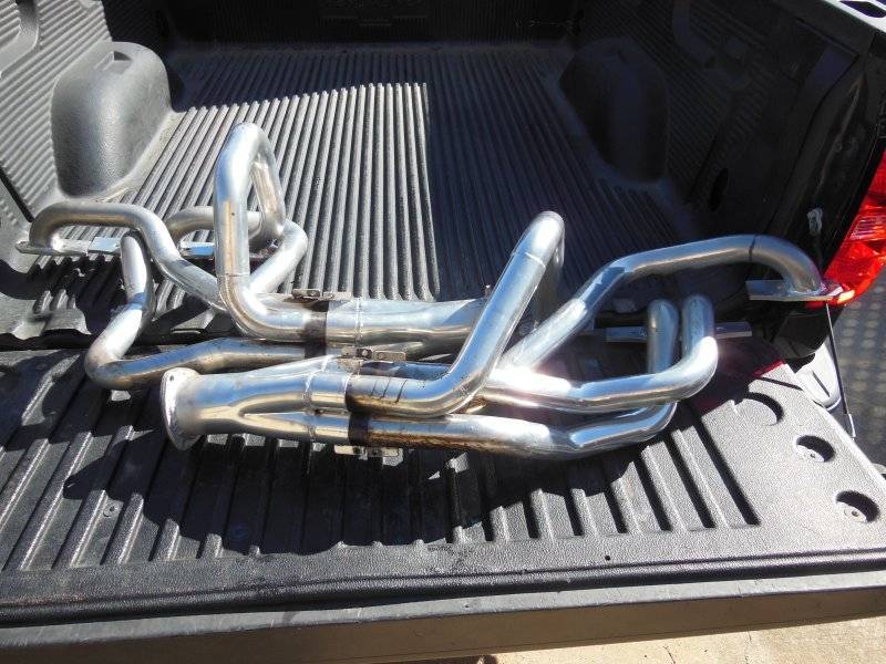

Nice looking build, I have a 63 also but mine is a Savoy post car. I have a real nice set of 2" headman adj. race headders if you get to the point of thinking they might help you. Are you coming to the Mopar show/race at Norwalk in Sept. ? Good luck
Yes, that looks like them, do they have the collectors canted in to the center of the car instead of straight back ?
Well well well, now I know what headers I bought last month, no name but took awhile getting them together right (in a pile) btw I’m thinking of doing a 65 same way either 383 or 426. Forgot to ask how did they fit?
Mine fit good on my 63 Savoy, stock motor mounts, manual steering. In the process of hooking up 3inch exhaust with "X" pipe & cutouts. Can't wait to take it for a ride and burn off the cheap rear tires ! Like they say "smoke 'em if you got 'em !
I do have a set of those headers, 2" primaries might be too much for the 383. That's why I decided to go with 1" 3/4. Not sure about Norwalk, it's quite a tow for me.
I am in Wisconsin and looking for another set of 2 inch big block B Body headers if you are looking to move a set.... If not, sorry to jump in here.

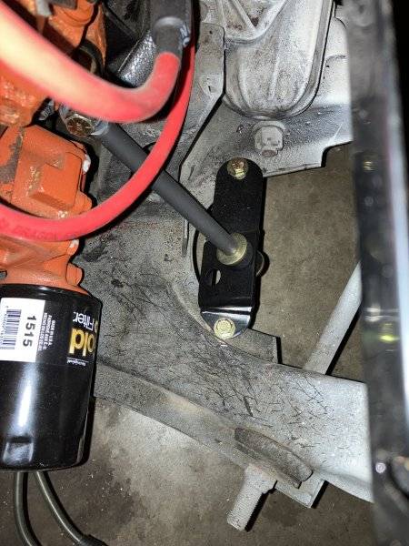

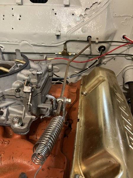

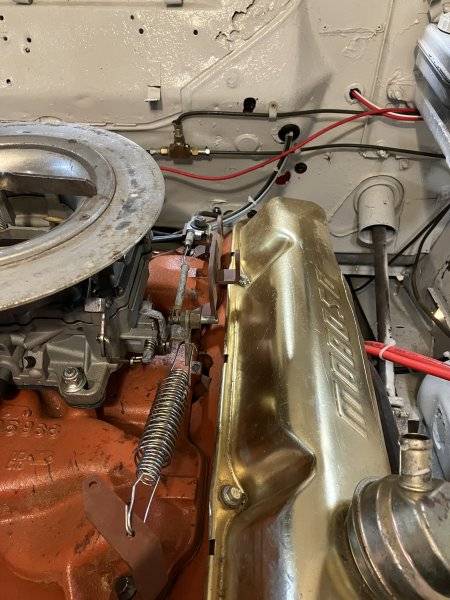

Changed out the throttle linkage yesterday. Started by changing the gas pedal and linkage that I found on ebay. Works much better now.
What gas pedal did you go with? I honestly hate the gas pedal setup in the '62....

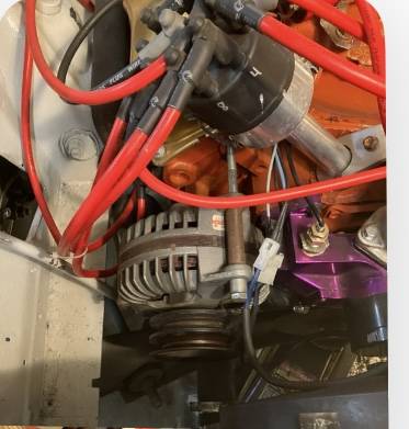

If that's your brake line on the firewall, it won't pass a real NHRA technical inspection
That's a new one on me. Every Dodge has them on the firewall.
Fuel line, no.
