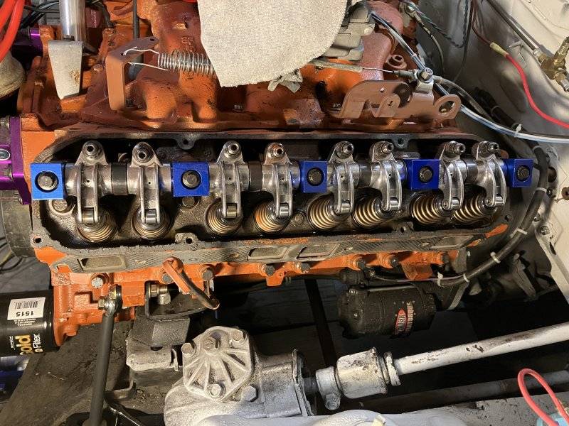

More changes...new headers are on. First time I've had the rocker covers off, valve train looks good.

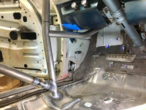

cjd1963, do you have any pictures of where the cage bars attach to the floor/rails in the trunk? Curious about that area as I'm doing some mods in the trunk on my 65 for a fuel tank switch.
well some but some where deleted for street use , but mine has support bars running into the trunk floor from the top bar tube . but here's some of another 63
well it's all laid out in the rules for what class you're running in . my 63 will get the front bars and front frame supports as well , with my next power plant . but build for the next level .
Looks like the bar terminates above the shackle mount on your photo.

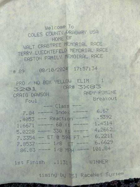

Took the Sport Fury to the local 1/8 mile track Saturday for some testing. Overall I would say a success. Maiden pass was a 7.89, 7.86 is the I/SA index for 1/8 mile. Accidently short shifted from low to second. 5200 rpm, shift light is set at 6000. Picked up on the second run to a 7.85 even thoughI short shifted (again) but this time going in to high gear. Have a few things to address on the car but happy with it overall. It showed me there is potential and can now start looking for some quicker ET's.

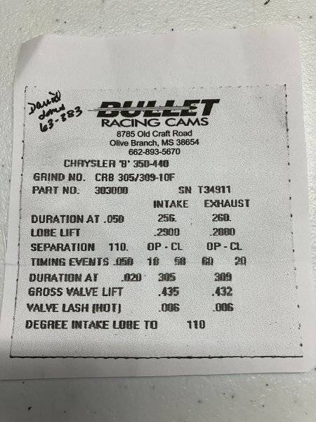

Do you know the cam specs?
Did you happen to check to see what the flash stall speed was?
If those “advertised” duration(.020) specs are correct, that’s a bunch of seat timing for the .050 numbers.
I suspect that 305 number actually happens at something other than .020”(probably more like .006”).
Any idea what the V/P situation is?
Have you done a cranking pressure test?
If built to spec, do you know what the CR would be?
Sorry for all the questions.
Edit- I found what I’m pretty sure are the lobes used on your cam in the Bullet lobe catalog.
Looks like they’re in the “hydraulic” listings, so those 305/309 numbers “should be” at .006”.
Not that that changes anything……it’s more just curiosity on my part.
This engine/cam combo was built by Brad van Lant for one of his customers. I bought the car from him last year with only break in time on the engine, 0 runs on it. It is a hydrulic cam with stock lift from the factory. I believe the stock comp. for this engine is 10:1. Can't answer the other questions since I'm not an engine builder, sorry.
