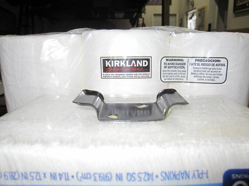

It routes near the accelerator pedal mount area and a bracket that fastens to the pedal studs holds the cable up in that section of the route. Do you have the bracket?

No, the original speedo cable was cut near the firewall grommet.
OK. I took a couple of pics. The dimensions are: 1/2" high X 1 7/8" wide X 3 5/8" long. Slotted hole to front.
