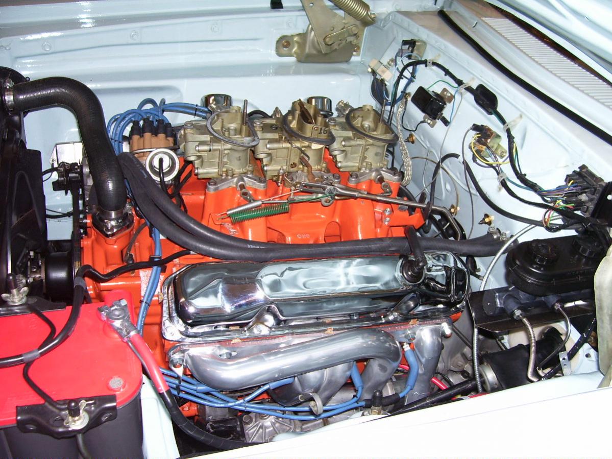

hey!, my dad has a 65 coronet with a 440 six pack 727. he currently isnt running a kickdown and i was trying to help figure out where a guy can find a setup for this that you wont have to cut/modify too much? he has been running it for 8 years and had no problems without it but im sure its not easy on the tranny, any info would be much appriciated
Is he running a manual valve body? If so, he doesn't need kickdown. If not, I'm not sure if 64 and 65 use the same style. 64 is one long lever. Mine was for a 2 barrel.
I welded on a longer threaded section using a bolt, so it will work with a 4 barrel.
the only way i know to do it is make one.
