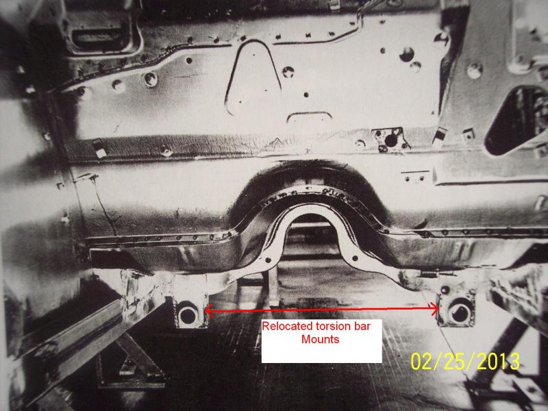

The altered wheelbase hardtop bars are not confirmed but they are probably from a 65 Y Imperial and were 50" long.The part numbers are 2275508 rt and 2275509 lt. The length accommodated the 10" forward front suspension move with the rear mounting moved forward 1".The bars were painted semi gloss black.
The torsion bar anchors in the hardtop body were cut off and ground flush with the surface of the crossmember.The new torsion bar anchor mounts were made on a bench to assure proper relationship between the centerline of the anchors and the mounting edges of the side plates of the assemblies.
The vertical centerlines of the torsion bar anchors in the crossmember were located and the centerline of the new assemblies were lined up with them.The side plates of the new assemblies were butted against the lower surface of the crossmember and held in position while the centerline of the anchor was checked.The assemblies were then welded in position.
The info is from the Ramchargers and an authentic guide for Altered Wheelbase Cars.
The outfit who did the chassis work on my AWB didn't lower the rear mounts! I did use the 65 Imperial bars with no modifications! Did have to use a 1" spacer! The bars are 50" and they need to be 51". Spacers keep the bars from moving back and forth! I think they lower the rear mounts for clearance .My k-member is moved the 15" forward as originals were!The rear is moved 10" forward also!
