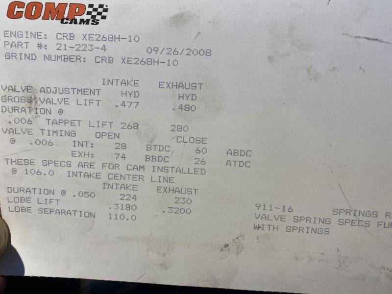

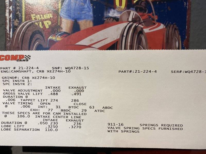

The engine had a pinging problem since it build in a special shop, with stock manifold and the 268 cam with a 10,5:1 compression on iron heads .
After I get a bearing failure , we change to the 274 cam , change the stock manifold to a Indy dual plane and put thicker head gasket to get a 10.0:1 compression , but engine still pinging, mostly just for a Second under load when the transmission shift from 2 to 3 gear and the rpms drops unter 3000 rpm . The fire core distributor has already the two black stiffest springs inside , if I change it to the blue ones it will pinging very quickly also in a 2000-2500 rpm range , . With the black springs mostly the pinging I will recognize in about 2600-2800 by shift up . If you accelerate in Drive in 3 gear from 2000 rpm to 3500 rpm it normally will not pinging .

- While you're in there having fun, throw a dial indicator on your #1 intake rocker and check the cam ICL. If your timing set is advanced a bunch it would make both old and new cams knock.
