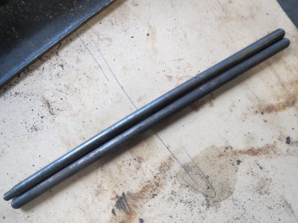

Both 440 pushrods, one from '66 or 7 with the small end and the other is a '68 and later that you can still use today.
Yeah it's pre-1968 that used the pushrods with the smaller end.
