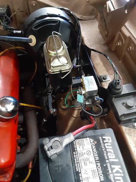

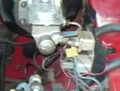

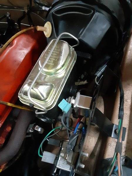

I’m assuming they told you the components on the relay panel can be shuffled around some to maybe get you some clearance. I’m still not sure what the exact orientation was that Chrysler used originally. 55 years later it seems to vary on every car now.
Can you post a clearer, head on picture Fran? Are you thinking it’s all original configuration? Any reason to believe it didn’t vary from plant to plant?
The way I have it currently is the factory orientation. I had the original panel and now I know why that was removed and a 383 harness on it.
I was working late in the shop last night, weather went from 92 on Wednesday to 67 on Thursday and 65 on Friday, so it was decent working weather, and I was hoping to get this wrapped up. I got all the engine wiring and stuff hooked up,heater hoses,etc, so I decided to start it up. I got in and hit the key, nothing. Went to the relay board, and since nothing is marked and I didn't have an old one to go buy, I had the ignition and horn wires switched, lol. I swapped them and it cranked over and eventually started. I shut it off as I still needed to put coolant in it. I dug my fresh booster out that Booster dewey redid for me and slid it into place. I climbed under the dash and got the 3 nuts back on, still need to come up with one more, but that's what it had when it came in. I got out from under there and scoped out how it looked under the hood, and that's when **** went south. I thought, man that looks awful close to the relay panel, so I grabbed the MC and tried to slip it on. Crap! Nothing some red label Weller couldn't handle. View attachment 1347435
That's likely why Chrysler used that bracket on the firewall for the booster on Hemi cars. As well as clearance for valve cover.

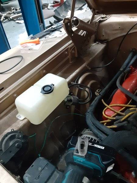

Brakes are done. I adjusted the brake light switch, what a treat. Not as easy as it sounds. I had to get my wife to come out and tell me if the lights were out after tightening it up. Finally got it as best as it can be. I pulled it back in the bay and installed the washer pump and reservoir. I also replaced the trans output shaft seal that was leaking. Can't wait to drive it.

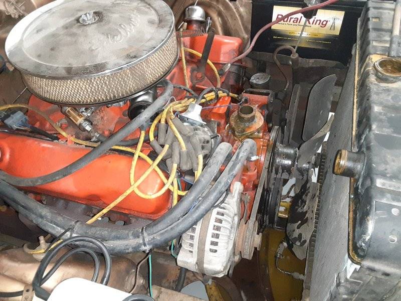

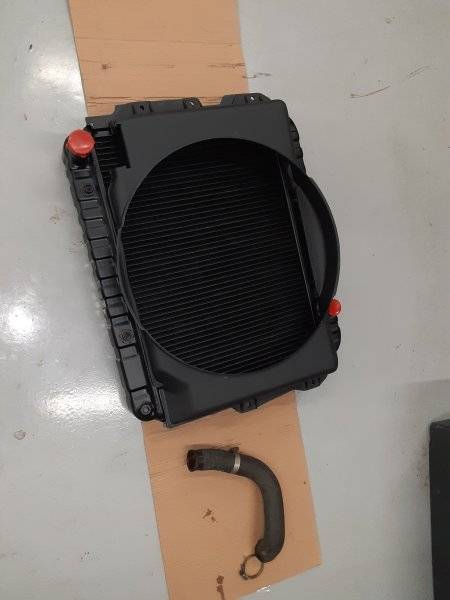

Today I dug out the aluminum radiator I ordered for the 500 back in June and didn't receive until September. I got the fan shroud I got for the Belvedere since it doesn't have one on it now. I'm going to remove the thermostat and see what temp it is, make sure somebody didn't put a 195* in it. If it has the 180 it should have, then I'm going to swap radiators and fan shroud into it. Hope that will cool things down a bit. I want to be able to drive it and enjoy it before the snow flies. Pics when I dig into it.
Had to order pipe bushings to go from 1/8" pipe up to the 1/4" pipe holes in the radiator, and order a petcock to go into the 1/4" hole. Also got a thermostat gasket. Nothing in stock. TBC tomorrow. Old radiator was a plugged up POS.
