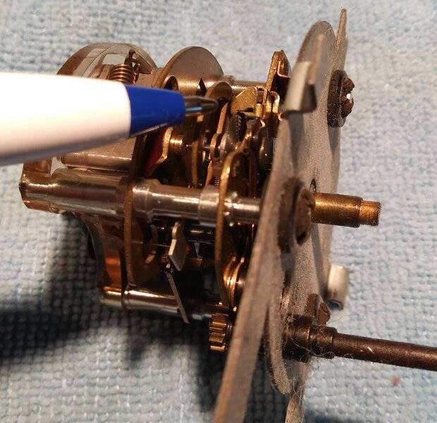

In the case of our older mopars there is a moveable mechanical arm that contacts the hairspring for added or reduced tension. This arm is designed to move in the direction needed during manual time corrections. It may take a number of adjustments until the wheel speed is correct.
I really appreciate the info. Both clocks supprislingly keep accurate time. After 20 min of running they both are right on. 1 clock with my stopwatch and human delay seems to reset every 2 min 17 sec the other resetsbevery 1 min and 50 sec. I'm better off just leaving alone as I dont want to damage anything and I'm gathering this is normal.
GREAT PIX.....aren't mechanical mechanisms wonderful.....how would like to make the assembly drawing of the clock, complete with gear mesh centerlines.....not....
