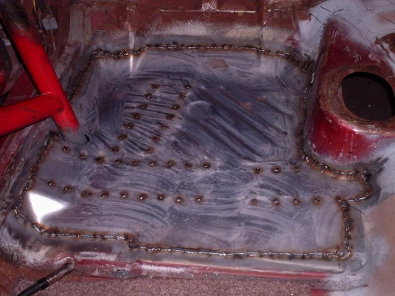

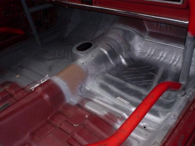

I got front floor sections from Paddock in 2006. $80 each, they were a great fit.
I know they went bust, I dunno who supplied their panels?
I bought a no-name for passenger side and AMD for driver side,Fit was good with and the AMD was easier for me to weld.
