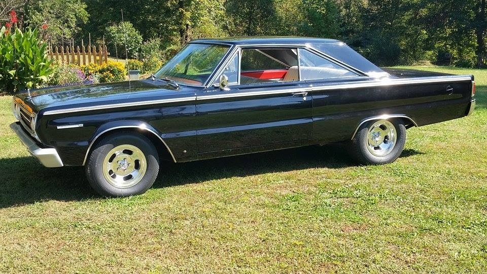

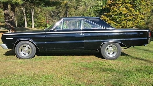

new 456,457 springs with ext.hangers-- now body below tire down on rim. 15x8 4.5 bs 275-60r15 tires. how do i get it back up??

Ok, my springs where to low and i put 275/60 r15 tires on back and used new monroe Airshocks! Shocks lost air everyday. So to fix problem i bought 3400lb. super stock springs 456/457 with extended hangers. installed them with new gas shocks and let it down off lift , just kept sinking til it was an 1 inch or more below top of rim. Tires where rubbing and couldn't be driven. Heard about Smith spring in jackson ohio ,took old springs down next day they rearched them and added one full leaf below main just a little over a $100. bucks with new u bolts too. As you can tell from pics it raised it up and already settled some and has a great ride not stiff at all. Thanks Craig
