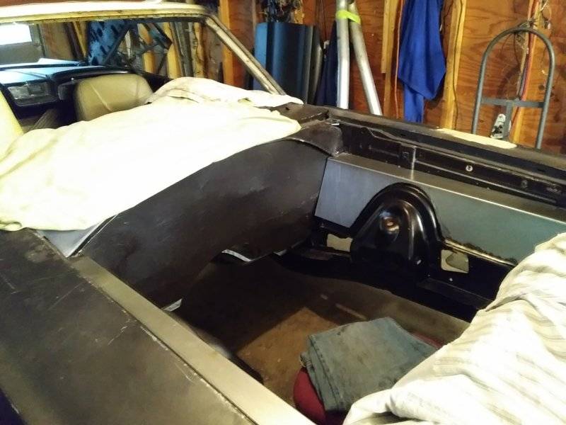

Hell if you can put quarters or patches on you can weld perches. I found it much easier than I thought it would be. Getting the angles right is key though. Once I cut them off and cleaned up the housing, I set the it on the leaf springs and played with the position of the pinion until I was happy and tacked it up.
