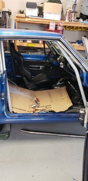

Picking away at the roll cage too.
Nice I doing the same picking at the roll bar. Doing a great job

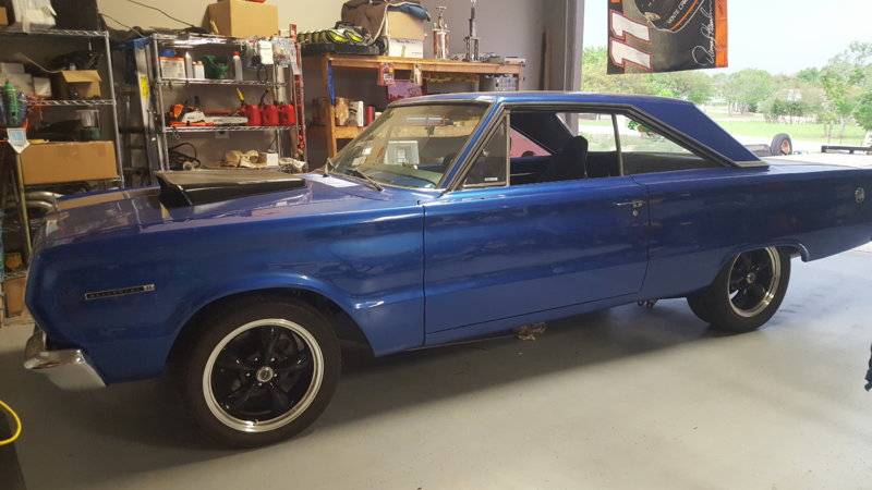

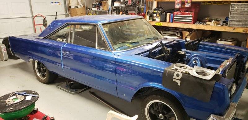

Can we get a whole shot of the car I know it's not done yet but I would like to see it
