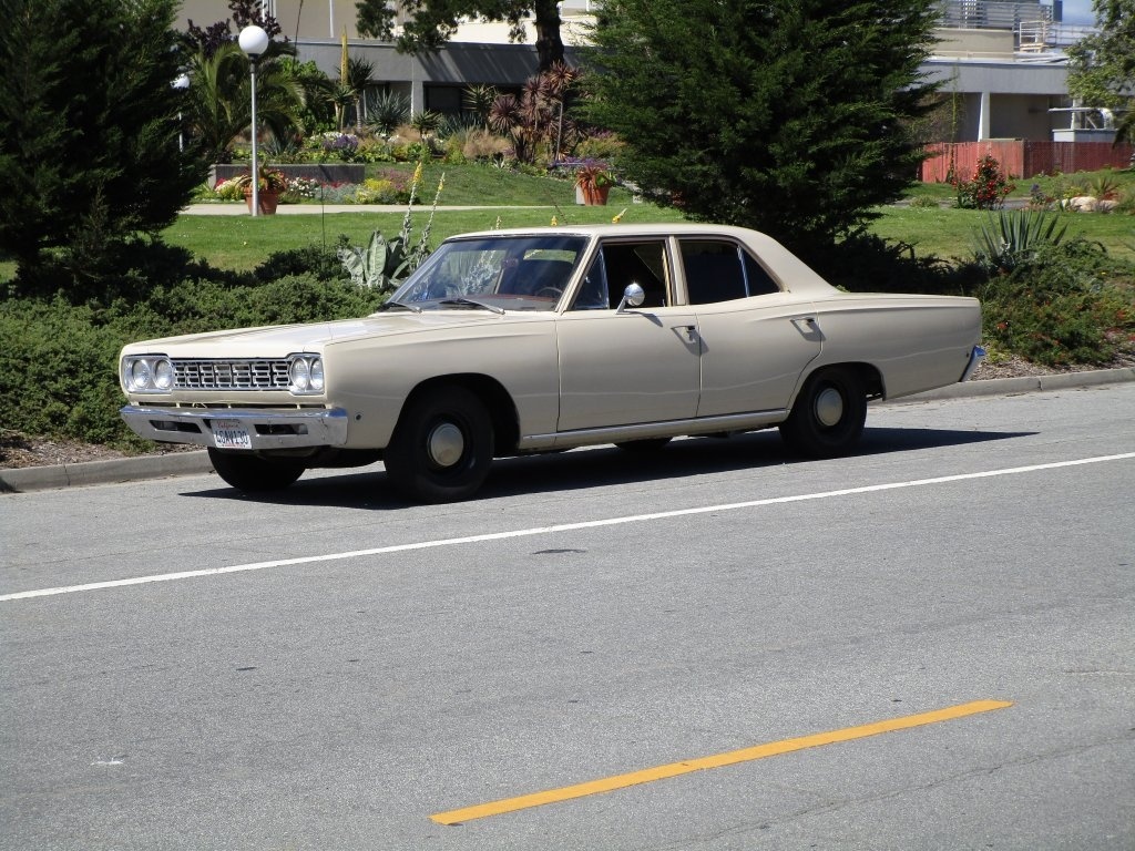

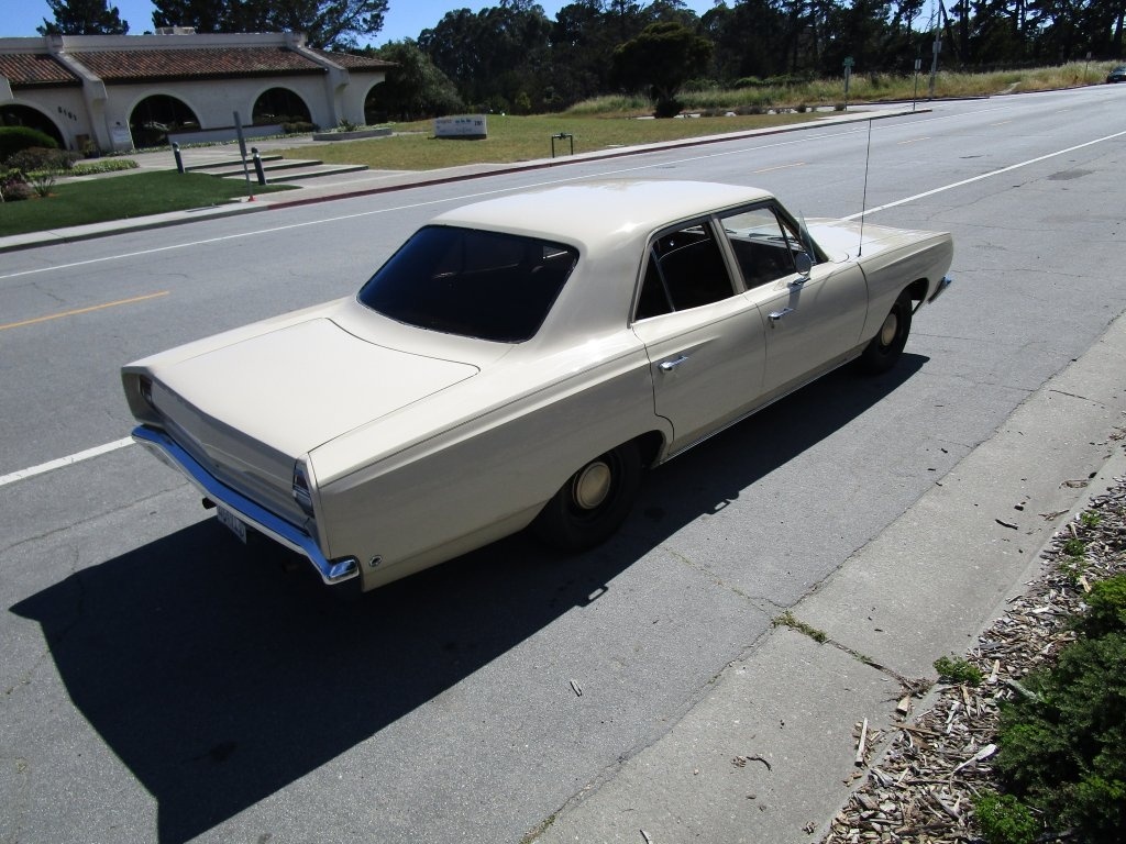

Recently bought a 4-door Basic with a straight body, ok paint, 318, dog dish hubcaps, the whole bit.
Needs most of the interior.
I just cruise it by the ocean.
4bbl and dual exhaust. Otherwise pretty taxi/cop car stock.
Loose; wanders (need to dial in some toe-in).
I love it though. It's my project car. Runs good, but needs improvements (especially suspension/steering). It's a barge.
Have a catalog for parts, but looking for alternative (cheaper) ideas.
Thanks guys!
Yeah, for $4k it seems like a lot of stuff won't require the nickel/dime bloodletting.
Glass is all intact. Lights work (except dash).

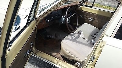

Welcome! I owned almost the exact car back in around '94 (long gone). Same color, brownish interior, 4 door, 318 auto and MANUAL steering. Does your also just have rubber matting or carpeting?
Looks like it. That may be from the owner previous to the owner I bought it from for $4k.
They did some work to it, but ultimately wanted to put more money into a couple other sixties MOPARS they had.
The Ebay add I saw that certainly was this car has been taken down as soon as I bought it.
I saw the ad you linked while researching this car. Not sure if it's the one I bought, or one just like it.
The wheels are a dead give away.
They wanted to keep the chrome aftermarket ones just like your linked pic shows.
Fine with me!
Mine is bare steel above and below.
Stripped except for seats and door panels.
Original color a bit more light brown.
It got hit and repainted by Miracle Auto maybe 15 years ago. Slightly more yellow/cream now.

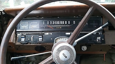

On the dash lights, I'd say there's been plenty of folks here who have gone through the same thing with theirs (including me). Nothing a bunch of volt/ohm metering (and maybe some back-wrenching upside down under the dash) can't cure, trust me.

That dashboard is a high priority too. The only lights that work are oil pressure, and high beam (pretty dull red glow, but sorta there).
Looks like pulling the panel (since there's no dash cover presently) might be the easiest way.

Yep, been there. My dash (pretty much identical to yours) had all sorts of issues also. Nature of the beast with these, apparently.
I pulled the cluster and spent an entire afternoon/evening with it on the workbench, methodically cleaning every contact point on the PC board (a pencil eraser works wonders, honest!) and replacing all the bulbs and their sockets with new ones, which are readily available.
I even hooked up jumper cables from the cars' battery and clamped the other ends to my wooden workbench (don't try this at home, kids) so I could test each circuit with 12V as I went; having a factory service manual for wiring diagrams helped a lot, too.
I replaced the voltage limiter at that time also. HIGHLY recommend you do this, regardless of whether or not you think it needs it. Trust me.
I got every gauge and light working eventually on the bench before finally installing the cluster back in the car.
It's a royal pain in the *** to remove that cluster if you don't have any of the trim/padding already removed...
but once done, it turned out to be one of the more satisfying projects I've undertaken on the car, not to mention a bigtime money saver. Companies out there that restore these instrument clusters want big $$$.
It's simple stuff once you're into it. Have at it!
