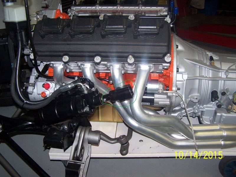

I like it and would recommend if you are in need of a p/s box change. The feel is just as they say, more like cars today. Still easy to steer and turn the wheel but not as easy as when you could steer with just your little finger in the wheel. The box is a little bigger at the corner closest to the number one header tube so on a Hemi you have to dimple it. Other engines may clear easy.
