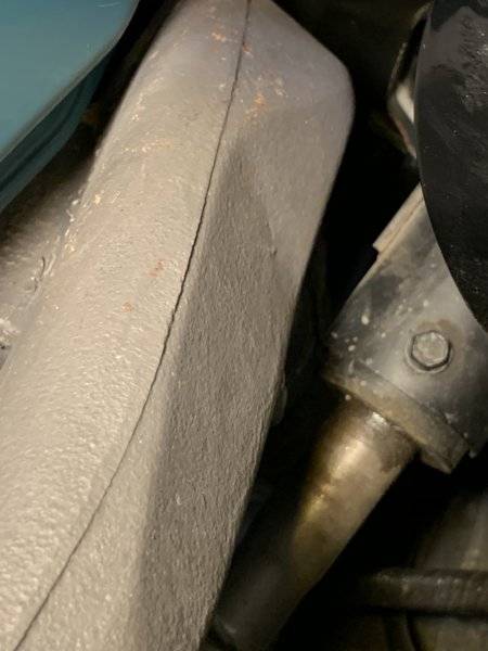

Cleaning up a few things. Would like to remove both exhaust manifolds, blast, re-coat. The main drive is needing to remove the manifold to be able to remove one of the head bolts as the spark plug brackets are installed wrong. Also want to put on spark plug heat shields.

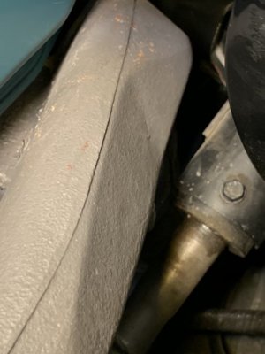

Having a preliminary look...it seems extremely tight for room the rear drivers manifold bolt to come out reference the steering column. See photo.
Any advice.
Never had a problem, but don't remember if it came all the way out or if you backed it out and removed it or if it came out with the manifold.
On my 68 I had to jack the motor up to get the drivers manifold out.
That was gonna be my suggestion.
Do you still have the factory studs? If you do, the manifold will have to come about 3/4" away from the head before you can jiggle it out.
Yes. Factory studs. Think there is room to get the manifold out and up. But not sure there will even be room to remove the rear bolt reference the steering column.
You're talking about one of the long nuts on either side of the down-pipe area? If you have enough room to get it loose from the stud, just leave it in the manifold as you remove the manifold.
I was able to take the drivers side one off without moving anything.
I could not get the passengers side one off. It would not slide off the studs before it hit the inner fender. The engine I realised is quite far offset.
