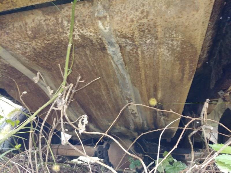

I have a 68 rr and this is a bad pic of the rear end under it.... can anyone tell just by a couple of bad pics what it is...
what are all the possibilities of rear end for this??
I have very very little knowledge on this subject....
ANY AND ALL help would be appreciated

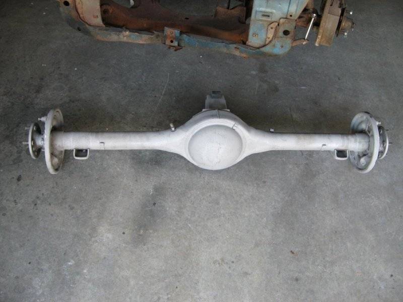

Heres a 8 1/4...

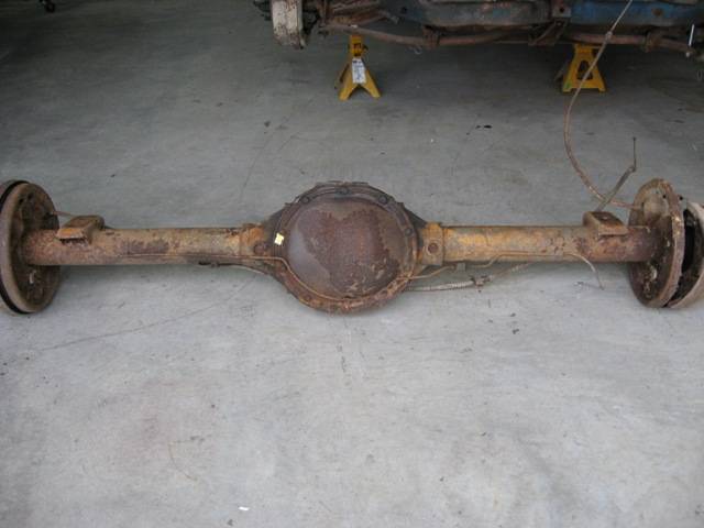

Heres a 8 3/4...
The 8 1/4 has a cover bolted on the back. The 8 3/4 doesn't have a cover on the back and the center section is removed from the front.

Heres a 8 1/4...
Heres a 8 3/4...

Thank you very much for the great info and the pics... I think you both nailed it... looks like 8 1/4 to me also
