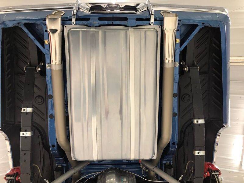

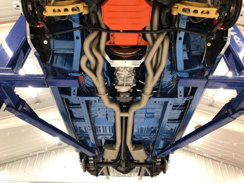

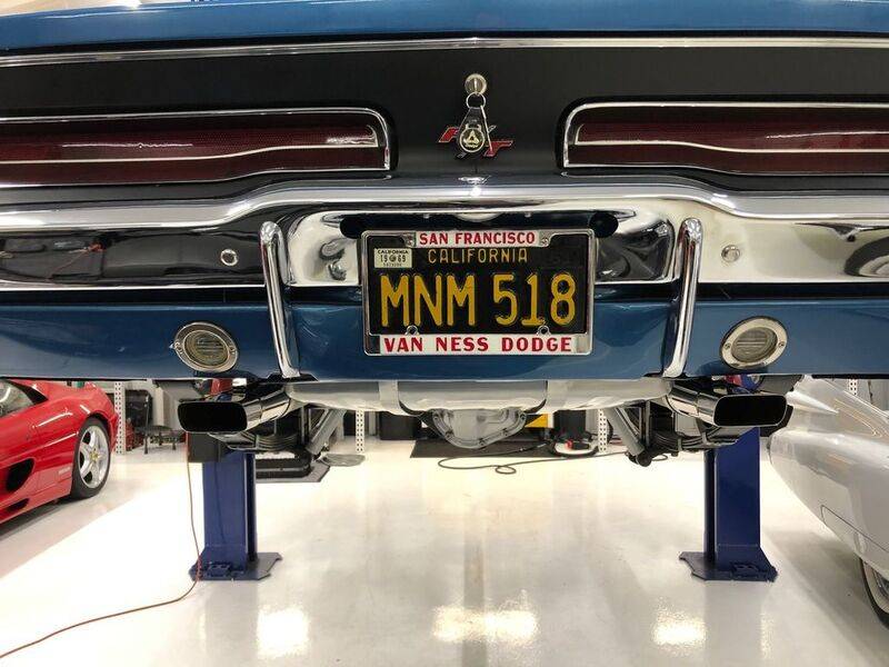

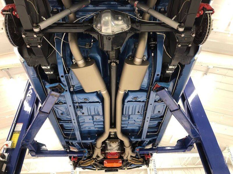

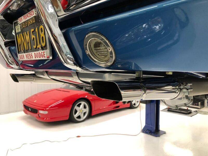

Nailed it.For exhaust, I bought a "stainless" system from ebay a while back. It's not stainless and not entirely sure it was made for this car. Had to cut up every part of it to make it fit. Used some 3.5in bends from the headers, reduced to dual 3in near the crossover. Pypes "race pro" mufflers (which despite their name I find to be quiet), and stock style tips from Accurate exhaust.
All coated in the same finish as the headers.

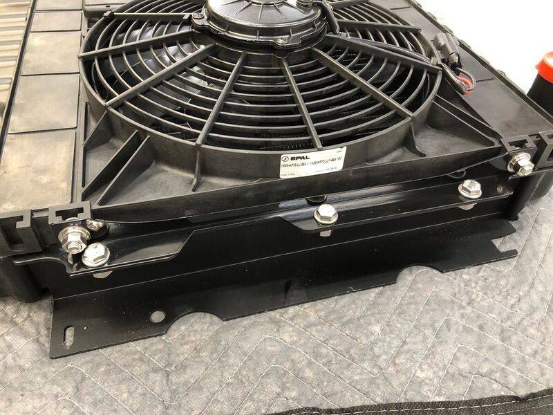

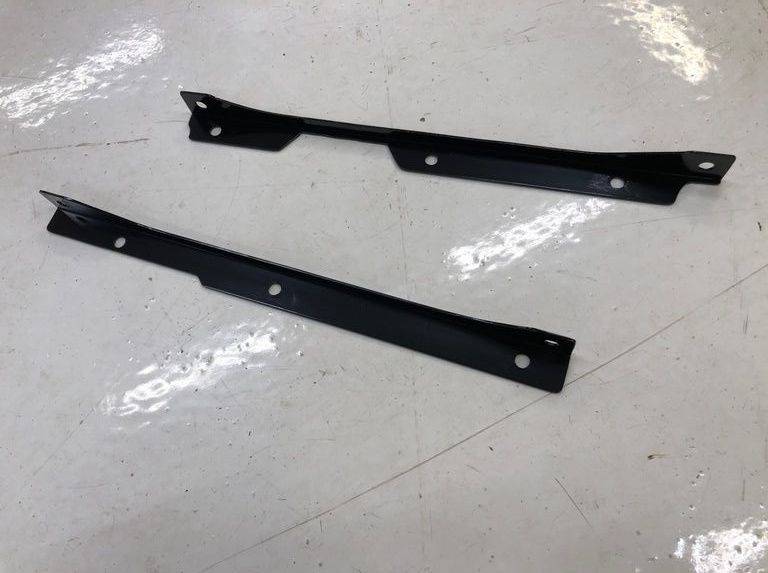

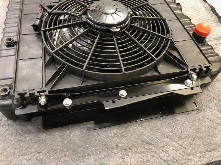

Also made some brackets to mount the Spal fans to the radiator.
