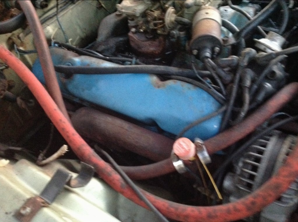

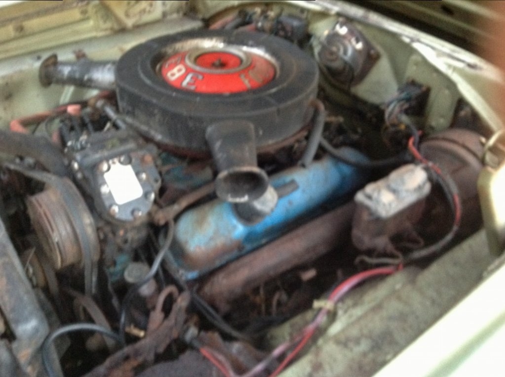

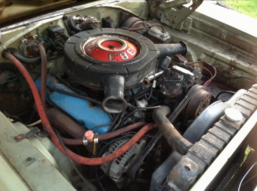

Thanks for the input folks. The wagon is an auto (D32) with AC. As mentioned, it is an H code (in the VIN) and E63 (on the fender tag). I haven't checked the numbers on the engine yet but was at least visually trying to ID it via engine color.
Recently there was a debate here or on FABO about motors from this year being turquoise and/or blue and people's interpretations of the two taking into consideration years of fading/color change. I have had/seen both colors and the motor in the wagon looks more blue to me. I'm going in for surgery in a few hours and will be sidelined for a couple of weeks or more so I won't be under the car for awhile to verify if this is the motor the wagon came with. The Holley carb is also a possible sign. I'll post a few pics. Let me know what you think. Thnx.
The valve covers appear to be corporate blue and it's hard to really tell if the intake and the water pump housing look turquoise maybe? Or am I just seeing things...
Should be turquoise. Rocker covers could, and look as though, they've been painted .
