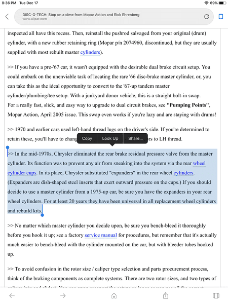

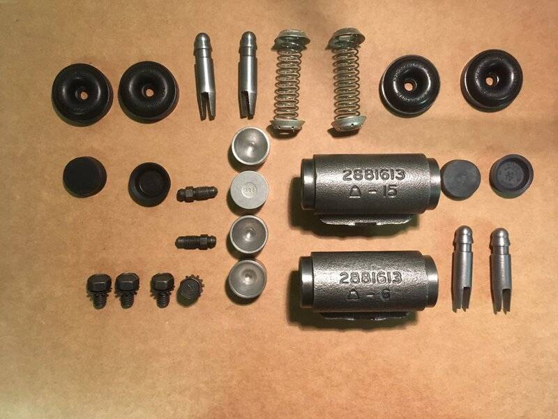

Hi Joel. Saw your posts re your master cylinder/air bleed problem and I recalled an issue during a recent rebuild of my rear wheel cylinders. The WC’s are the original 15/16th cylinders for my veh, a ‘69 RR-11” all drums-w/a 1” bore manual MC. Surprisingly, the inner components were also original. The inner spring ends were bare where they contact & apply outward pressure to the inner boot face. However, the Bendix rebuild kit contained “caps” for the spring ends as shown in the photo and appeared to apply more surface/pressure contact. Of course, there were no instructions with the kit, or info in the service manual, other than the original 69 MC contained a rear brake residual pressure valve to prevent air from entering the system. I found an article where Mopar, in the ‘70’s, discontinued these RP valves in their MC’s, replacing them with the above caps, called expanders, to prevent air from entering the system. I’m no expert in this stuff, and you’d need to verify, but maybe if your using a newer, or after market MC that doesn’t have the RP valves, and your rear wheel cylinders don’t have the newer expanders as mine didn’t, it might be allowing air into the system. Edit: I later relocated the article & attached....Jim

All my wheel cylinders are the newer style and I was told by Dr Diff that all of the new wheel cylinders have the expanders like you stated. I think my problem was that there were those 2 small bubbles of air that just didn't want to come out of the system. The pedal is a lot better now and inline with what others on here are saying they have for travel with their 15/16" bore master cylinders.

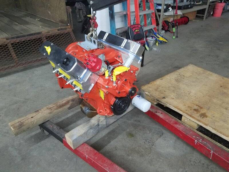

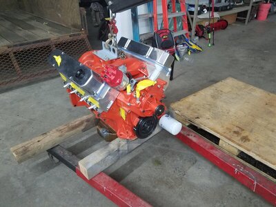

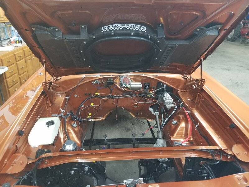

One step forward and 10 steps back with the Bee project. Been fighting to get the new motor to run on pump gas without detonation for the last month and a half. We finally figured out the the engine builder made a math error and the compression ratio and cranking compression is to high. So I got to yank the motor and now need to build a crate to get it sent back to CA. It never seems to end..... Good thing I have 2 other cars to drive this summer.

What did the compression ratio come out to be? Can't run a cometic thicker head gasket to compensate a bit? Or was it way off?
10.53 and 180-185 cranking compression. Yes, one option is to replace the. 080 head gaskets with .110 or so. The other option is to replace the flat top pistons with dish, .040 head gaskets, and turn it into a quench motor. The builder will do whichever way I want. I have to decide which way to go....
Shes pinging with that compression huh? Weird I run about 10.6 in my Charger with aluminum heads and 93 octane and have no issues. I run about 34 total timing and 18 initial. I wish you luck my friend. I'd have a hard time crating an engine up for head gaskets though.....I understand wanting the builder to fix it, but man that's alot of bullshit shipping it for that. I get it if your going the piston route then it makes sense for sure. Whichever way you decide, hope it all works out for ya. Always something it seems.

This sucks....
At least you've done it enough times you know you don't need to take the hood off! The only positive..

Yes, it detonates as soon as the secondaries open. Either smashing the pedal to the floor or just gradually opening them, and that is with the timing backed down to 30 degrees and the 2 stiffest springs in the distributor. You are lucky to have 93 octane, that would make a big difference. We only have 91 100% gas around here. When I mix in 5 gallons of 110 race gas with 15 gallons of 91, it runs great. The motor also has 180-185 cranking compression and no quench. Those 2 factors are what is causing the problem. The guy who built the engine admitted that he made a math error and is going to take care of it. 99.9% certain that I am going to have him rebuild it with dish pistons, a quench, around 9.5:1 compression ratio, and probably a different cam that will bleed down better also. If nothing else, I am learning a bit more about how engines work.
