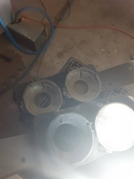

Today I started working on the nosecone assembly. I had removed one of the headlight buckets because someone wanted pictures of it. I got the bucket reinstalled. I had to remove the whole Z bar assembly to get it back in.
