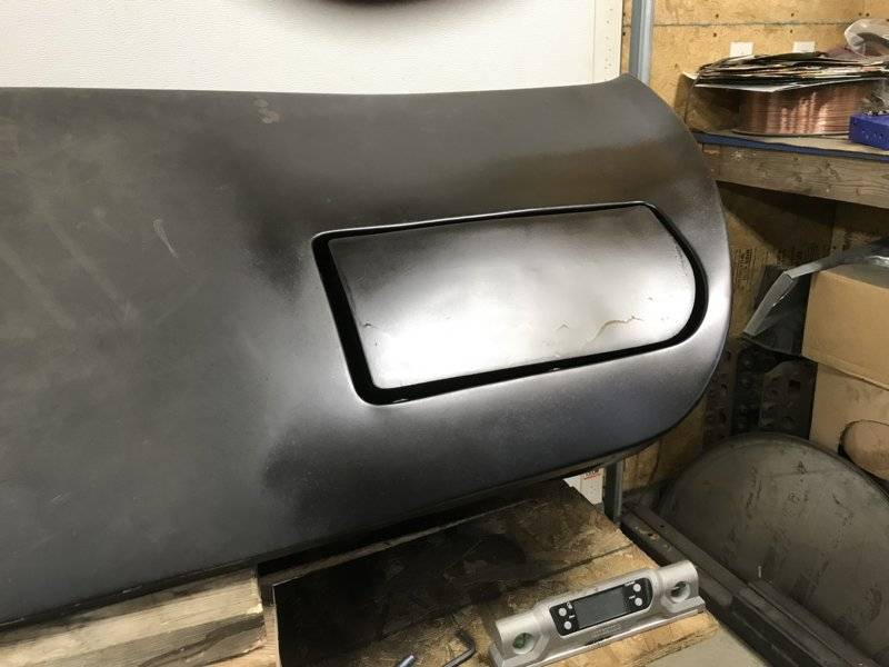

These headlight doors are a complete PIA to get right. I got one to an acceptable working condition. Tons of hours for so little progress.
Man does that engine look wicked, nicely done!

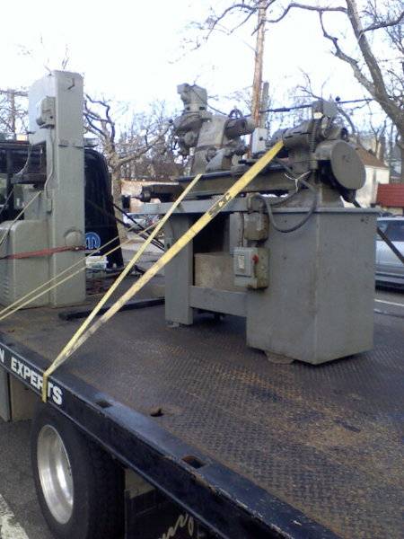

Can't wait to get a mill in my garage, it's sitting right across the road just need to come up with a plan for transporting it:realcrazy:. It's a Cincinnati Toolmaster.
Takes some elbow grease and finesse!! A flat bed operator with a half a brain helps:thumbsup::lol:
