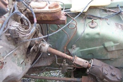

Pulled the master cylinder off the 70 RR today and it is full of mud. Looking through the catalogs and I see both bolt on type lid and wire lever. Which one do you recommend?
The one I removed was screw on lid. Front disc, rear drum, NO power booster.

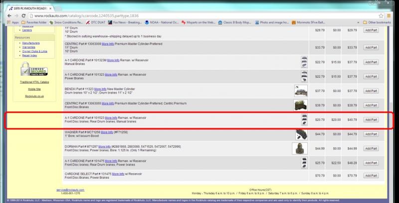

Manual Disc/Drum Master 1970 Plymouth w/bail:
http://www.rockauto.com/catalog/x,carcode,1240535,parttype,1836
Personally never had a problem with a bail lid leaking, but to each their own.

OK, so now Im more confused than ever. I just got done removing the firewall plate that the m/c mounts on. It looks 100% original and doesnt appear to have ever been messed with - No booster was ever on here. BUT, I see nothing that makes me think front disc brakes were added.

What are the numbers that are stamped or cast on the bottom of the MC do you have a pic? What size drum brakes are on the rear 10 or 11 inch? Your front disc brakes could have been added somewhere along the line and where not on there from the factory because it sounds like your MC is original
The one that Propwash showed above is for power disc.

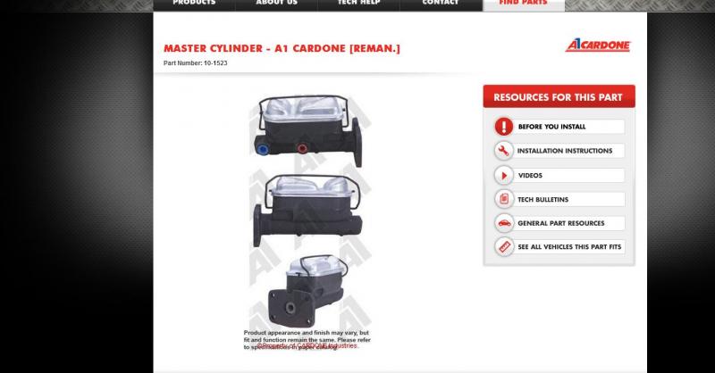

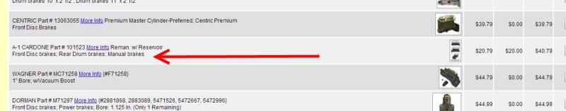

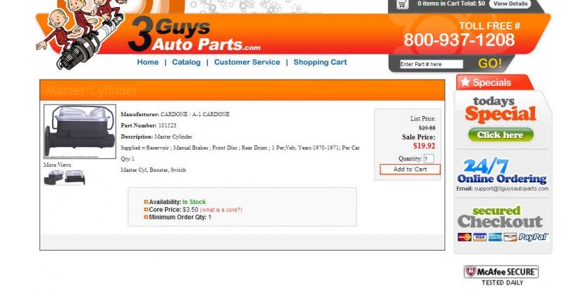

Are you sure Mark? If you look at the line item for the part, it refers to manual brakes on the listing, as well as quick cross referencing of the part# against other MFG's of the master, states it as manual disc/drum master as well. Google search of A1 Cardone 101523 and checking out other sites also list it is a disc/drum master for manual brakes.
I think you're thinking of A1 Cardone 191475, which is a disc/drum master for power brakes. It looks pretty much identical and is the master cylinder I have on my '69 roadrunner with power disc/drum brakes.
Pretty much irrelevant though, because you are 100% right....Manual Disc/drum brake combo's did not come as an option till 1972. That's not to say he can't make manual disc/drum brakes work with 101523 in his '70. Like you mentioned, larger reservoir, should get him there.
