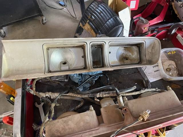

I need some help from those of you who have functioning 71 Chargers with the base (non-RT) taillights. I need to know that the functions of the red lenses (one on either side of the backup light). Obviously they illuminate for parking/running, stop and turning but I need to understand which lens does what function/s. I am going to try and build some LED panels to fit under the red lenses (and the backup as well) given what a PIA it is to replace a bulb plus I think LED will be brighter and in my case the left side sockets were toast, severely rusted and unusable. I could replace the sockets with some Dorman replacements (which I already bought) but I thought I'd try my hand at making some LED panels.
So, any help is greatly appreciated. I am attaching a pic of the right side lights.
Both are the same
Gray wire is parking… while brown on left tail light assembly and green on right tail light assembly ( or backwards, allways forget that ) are turning/brakes/hazzards.
black, ground.
That is correct - Both Red are the same
With Taillamp ground wire is standard plastic taillights
R/T Or 500 Taillights where pot metal , so grounded thru assembly
Need to correct my reply.
black is parking, gray is ground… LOL.
and right and left are reversed… brown right and green left LOL.
