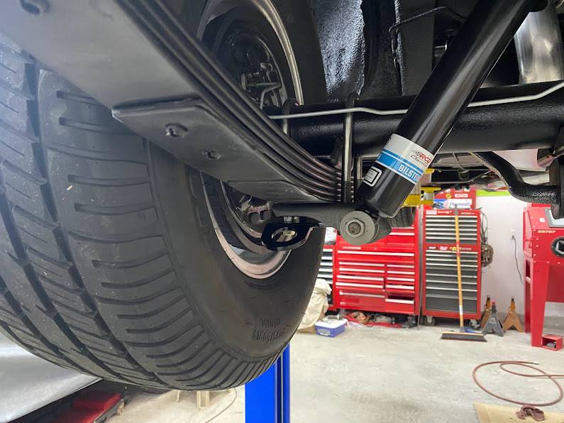

Added some floor mats and rear tie down brackets for the trip to Carlisle.
What is your plan for front tie-down brackets?
On the front I will use tire straps like the U-Haul trailers have, this way it will ride on its suspension on all 4 corners.

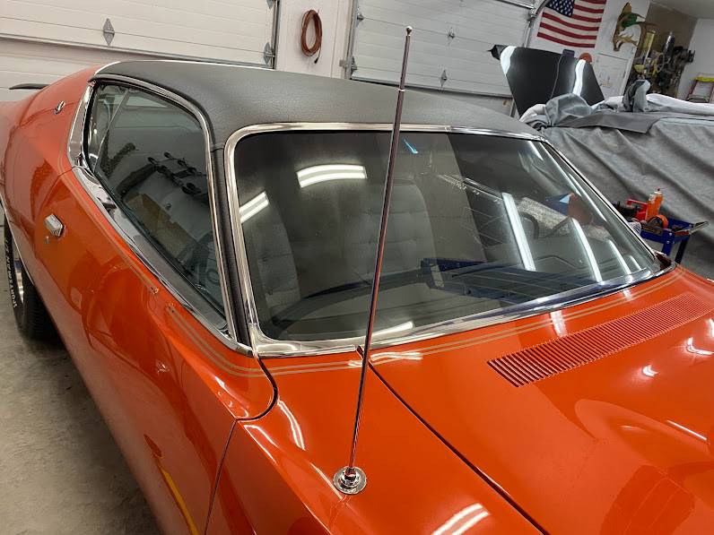

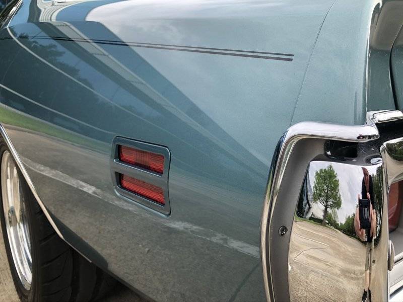

Raining today so its pin stripe day. I used a 1/4" stencil kit from Xcaliber and One Shot sign painters paint. Tried to reproduce the original. Its a little wider but I am happy with it.

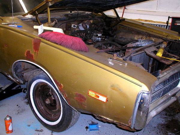

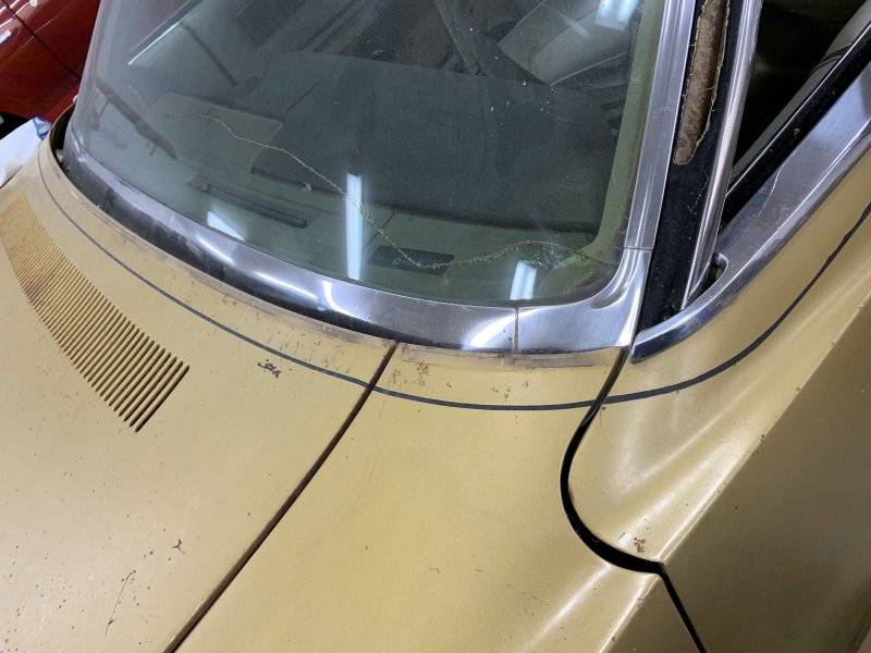

These are 72 pinstripes I collected off the internet. My car was originally like this although a 71. Just thought you would be interested in seeing. Your car is coming along great.
The early 71 stripe is a single one like mine. At some point they changed to the side stripe like yours.
I did not know that. I had seen both versions but did know have an explanation. I'm glad you told me.

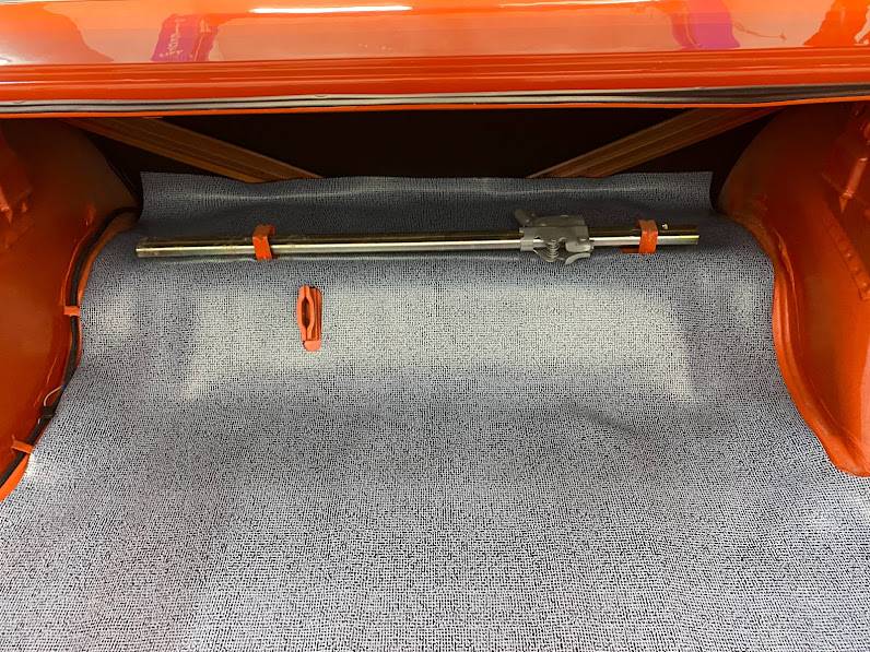

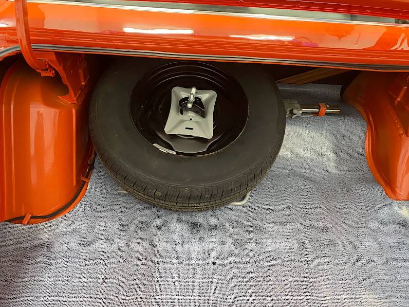

Got the trunk finished up and going to it's first show tomorrow.

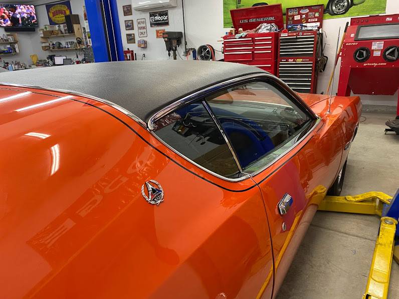

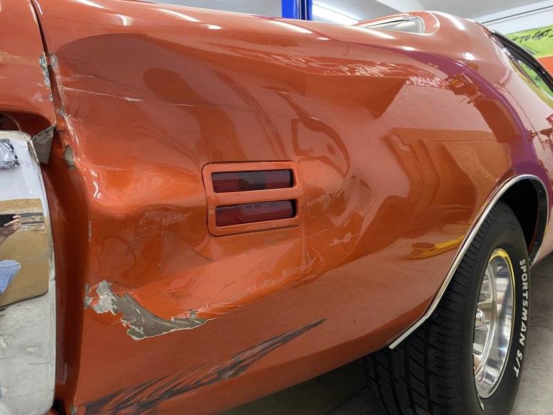

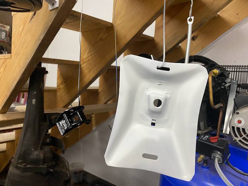

The Legendary rear upper panels I ordered at Carlisle last year showed up today. Very nice. Now I have some work to do while the car is at the shop getting fixed. For anyone that missed my post last Saturday I got whacked in the right rear going into a show. The shop that will do the work has me down for a June 5th drop off. Fingers crossed it's fixed in time to bring it to Carlisle.
