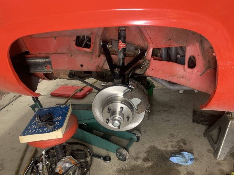

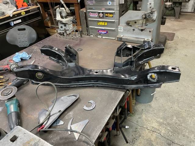

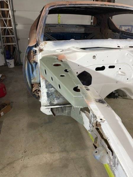

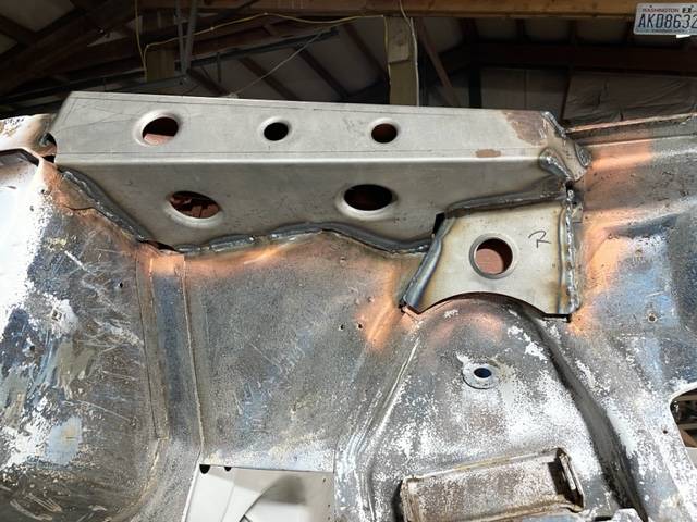

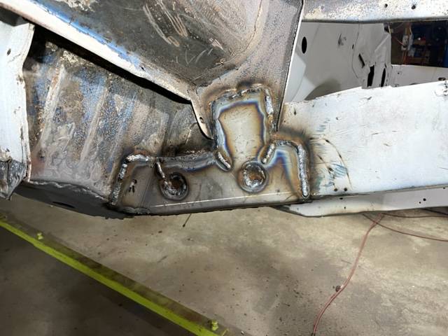

I was finally able to get the passenger side done today. Next will be the K frame
Thats awesome, I've got a 70 RR sitting here waiting on a 572 Hemi that will be going to Brisbane.All great information just doing a 71 satellite into a resto GTX Hemi 6.4 / 8 HP 70 car has just landed in Australia hope to have it in the next Month this is where i at waiting on the Terminator X max & Holley VVT mid sump

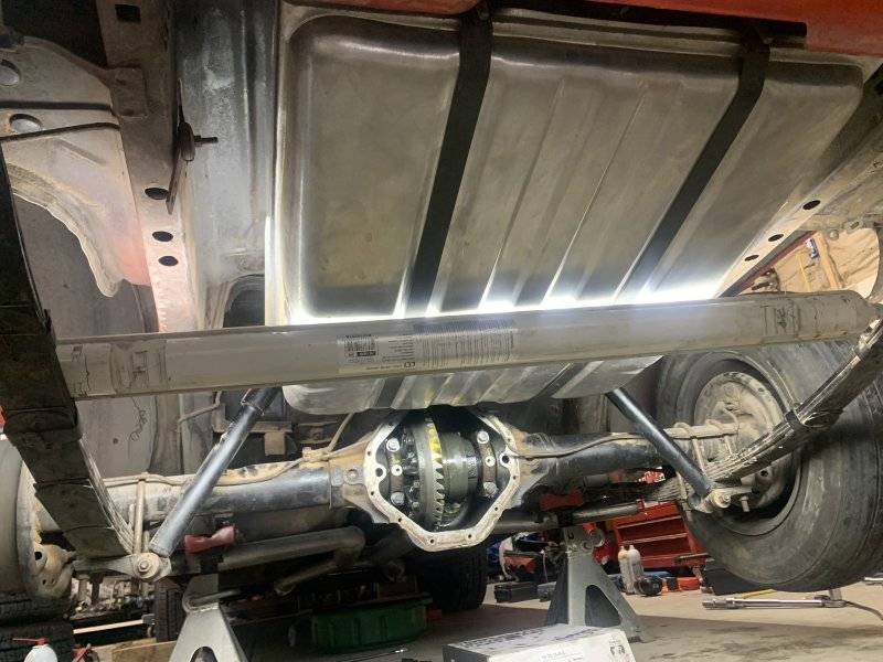

How was the fit with the frame connectors I fitted a set to my Challenger & they needed a lot of workI was finally able to get the passenger side done today. Next will be the K frame
They weren't too bad. I have installed quite a few of them and they all need work, one of the bigger tips is to beat down the floor some once you get them tacked in especially in the floor pan areas they get beat up over the years. Bottom line is that they are in no way a perfect fit to every ridge and depression on the floor and will require some filling in with the welder. I always use .035 wire for this task.How was the fit with the frame connectors I fitted a set to my Challenger & they needed a lot of work
Why is it easier to use an .035 wire for the subframe connectors? I thought it would be more likely to push through the thin metal on the floor pan?They weren't too bad. I have installed quite a few of them and they all need work, one of the bigger tips is to beat down the floor some once you get them tacked in especially in the floor pan areas they get beat up over the years. Bottom line is that they are in no way a perfect fit to every ridge and depression on the floor and will require some filling in with the welder. I always use .035 wire for this task.
Because the .030 or .035 being bigger fills bigger gaps easier and with sub frame connectors there is going to be gaps. I have installed them using .023 as well but at least in my case I end up having to make a lot of passes in some areas.Why is it easier to use an .035 wire for the subframe connectors? I thought it would be more likely to push through the thin metal on the floor pan?
