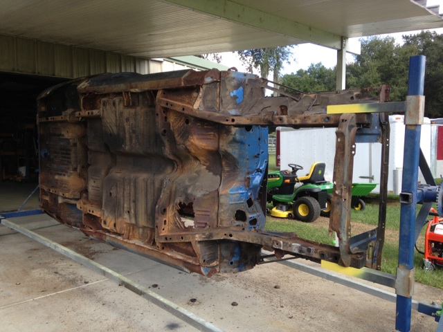

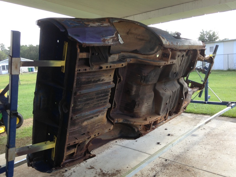

Removed the gas tank, vapor canister and shields, fuel and brake lines, original muffler and tail pipe hangers, rear rubber brake line bracket, all of the rubber and plastic body plugs, and trunk lid torsion bars. It may not sound like much, but I photographed every inch of how the lines were installed and how the clips secure everything to the car body. I also took a bunch of detailed pictures of how the original hangers were installed too.
Then I started blowing out the inside of the frame rails.
Once this was done I had a big mess to sweep up. Years of road dirt and some of the undercoating came off the car.
It still doesn't look like too much was done. Here are a few photos of how the "Wicked Bird" looks now......
For now it probably should be called "Dirty Bird" instead................

That underside looks solid as well as the frame rails. I hope you don't find anymore holes other than what we can see on the driver floor.
