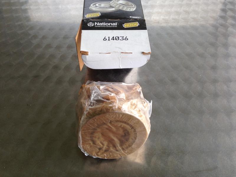

Here is the new throw out / clutch release bearing to go with the McCleod disc and pressure plate I have for the RR.
part # BCA 614036. With the housing and clips.
It fits all mopar 23 spline manual transmissions. The Hemi / six pack 18 spline is different.

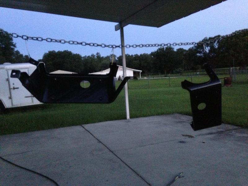

image.jpgimage.jpgimage.jpgimage.jpgToday I accomplished something on the car worth posting.

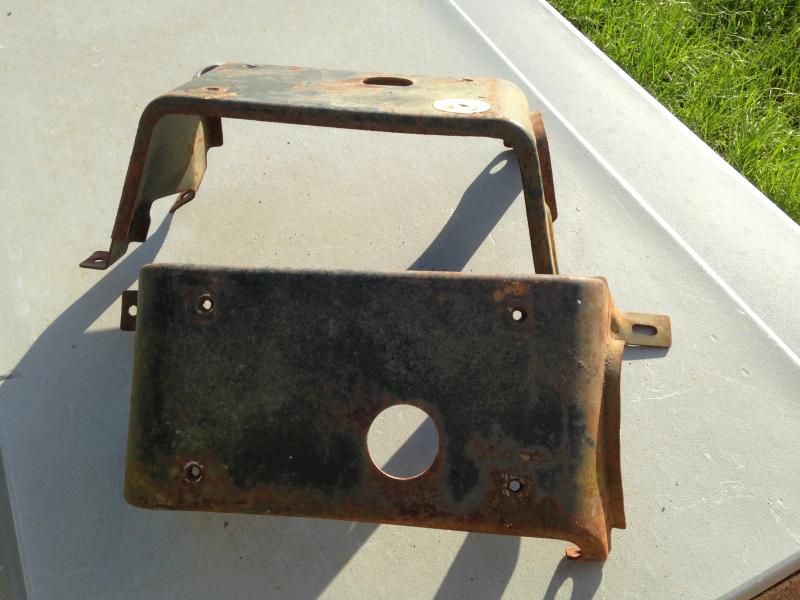

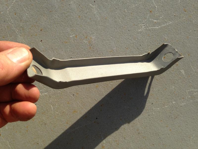

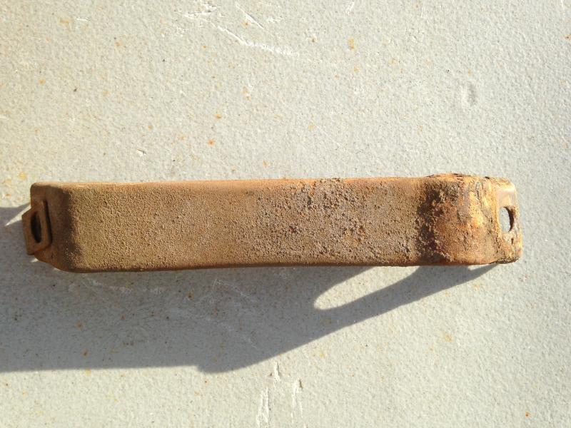

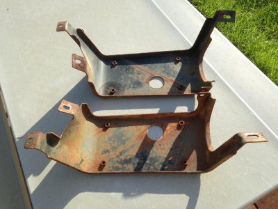

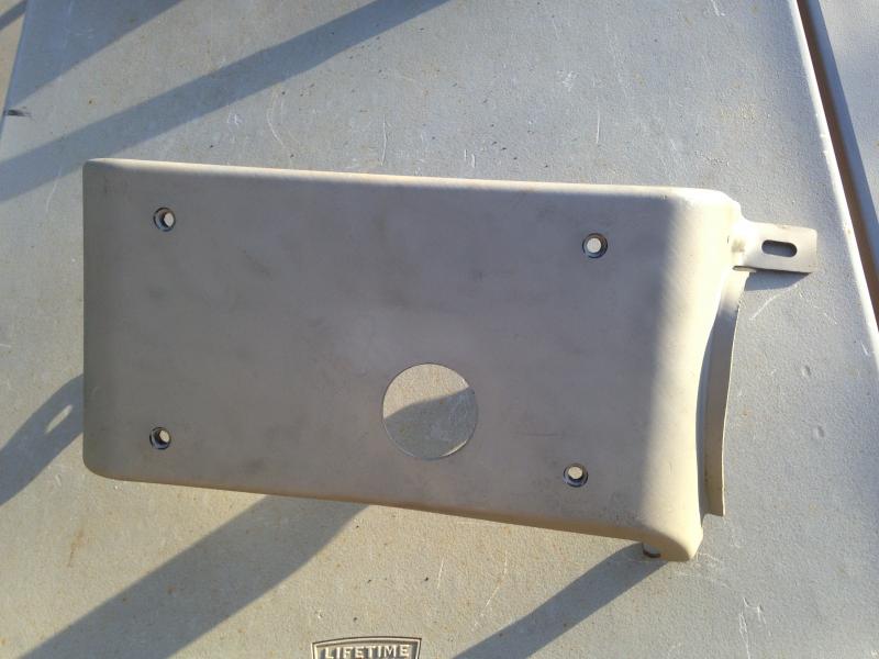

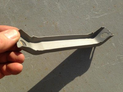

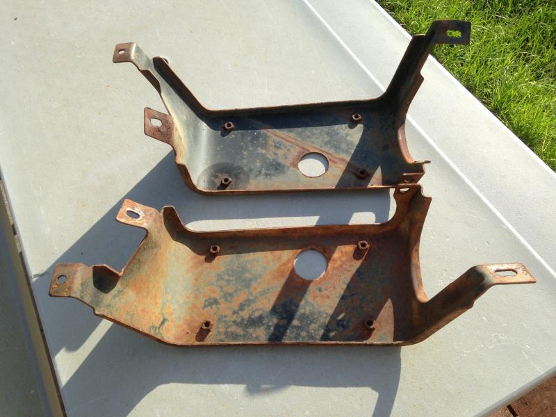

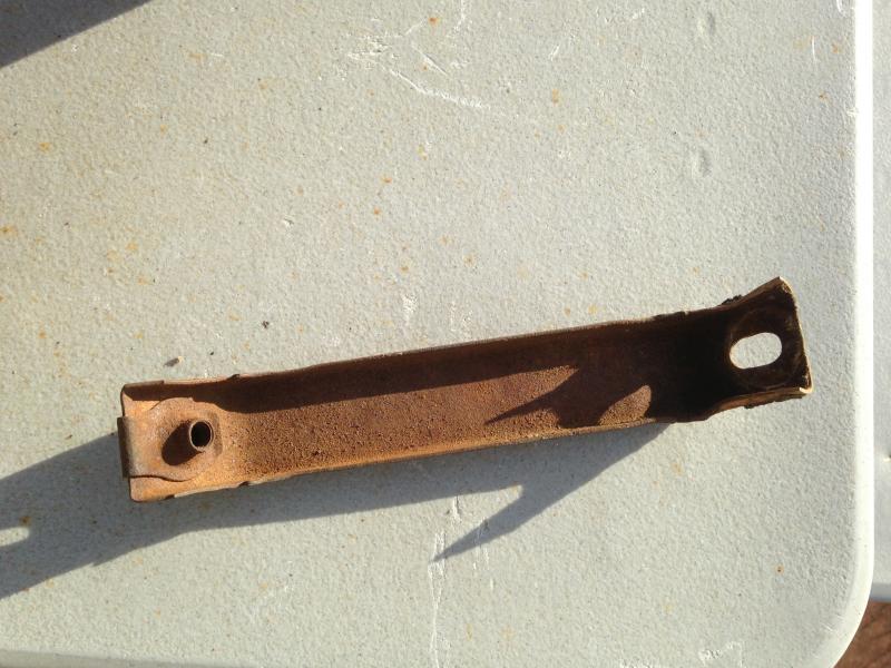

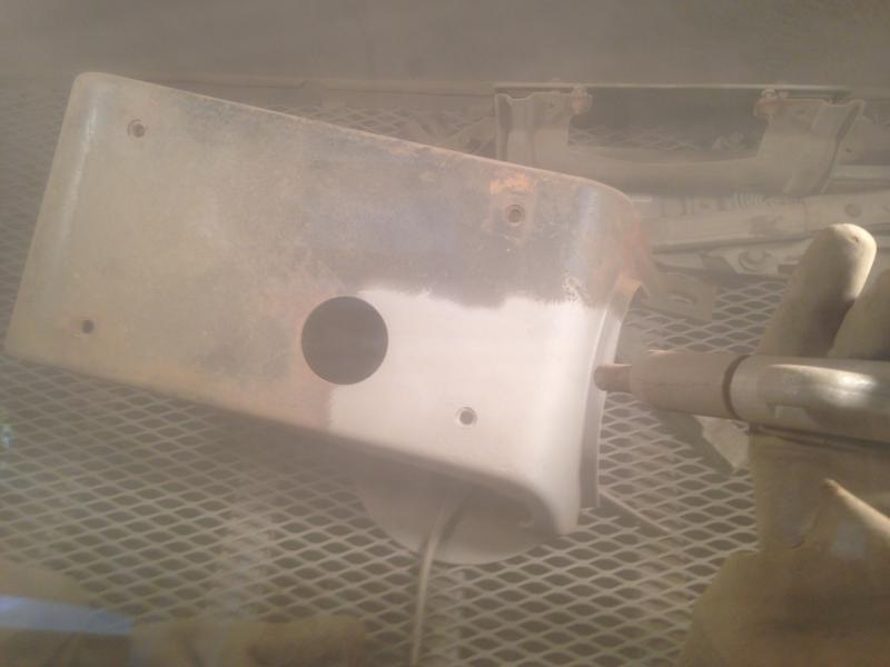

I blasted the rear bumper brackets and was able to save the original battery tray brace. Here are some pictures of the process. It's kind of boring stuff, but it's necessary if you want the car done right.
these first pictures show the parts before anything was done.

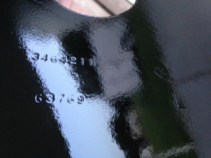

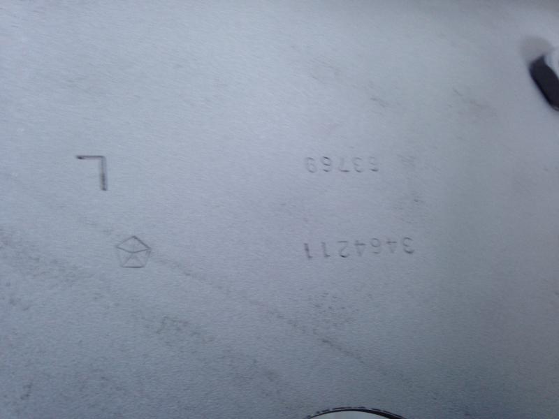

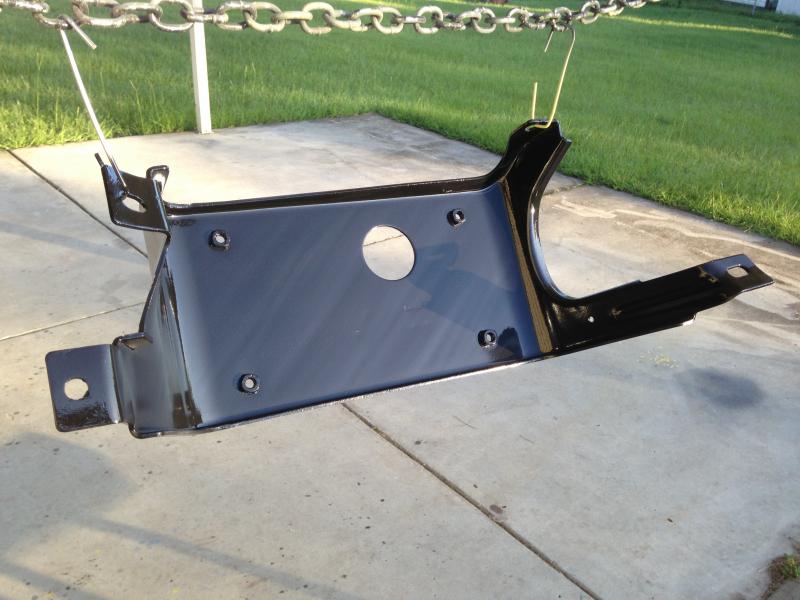

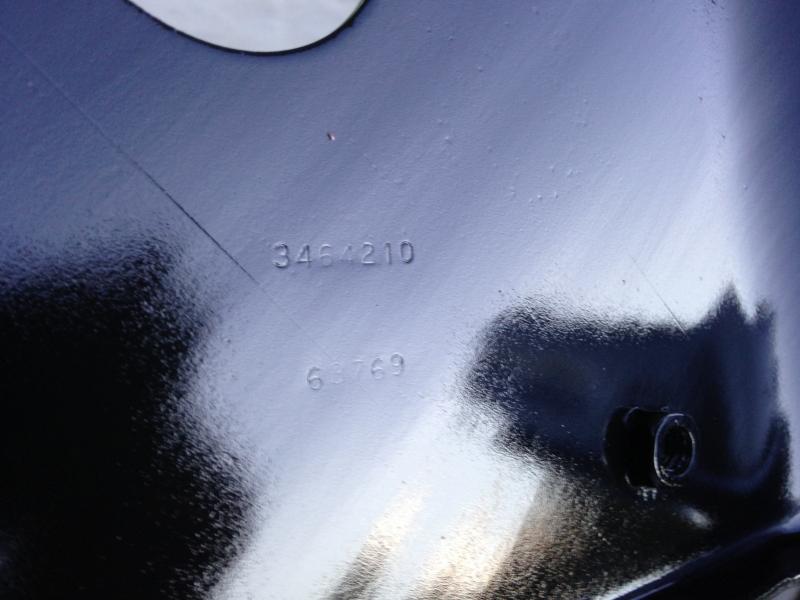

These pictures show the process of cleaning the rust and old paint from the brackets. Amazingly a lot of times this will reveal original numbers that were stamped into the part. I tried to get a close up of this.
image.jpgimage.jpgView attachment 125686image.jpgimage.jpgimage.jpgimage.jpg

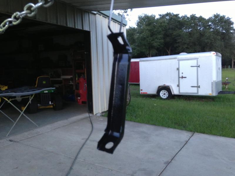

This is how they turned out after painting. You can read the stamped numbers and see the Chrysler Pentastar plain as day.
I'm happy how they turned out .
Stay tuned. Tomorrow is another day. Thanks for looking and have a safe Holiday weekend.

I like the way those brackets turned out. I just may have to break down and get me a little sand blaster.
Looking good! Thanks for the updates the brackets did turn out great..

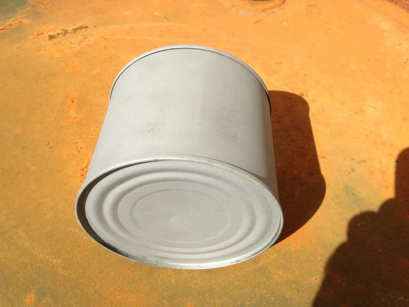

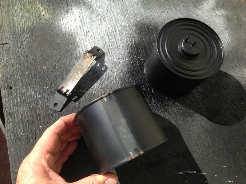

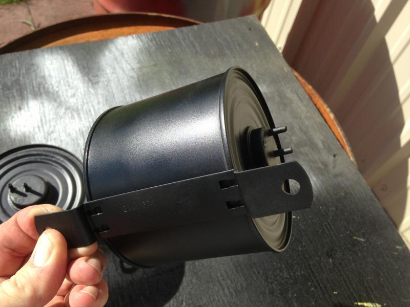

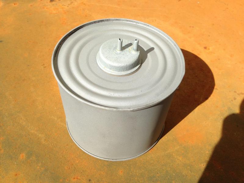

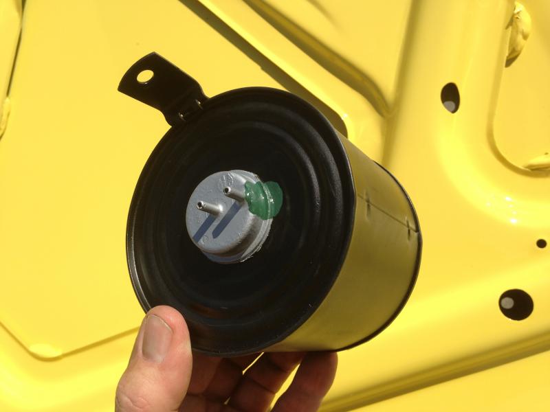

image.jpgimage.jpgBack on post #64 I was working on restoring the vacuum can for the air grabber actuator. After I glass beaded it I found several small pin holes. I had another can from a different year / body style car. It had a good can but the brackets were different.
Follow along and I'll show you how I tackled the problem. It was a pretty simple fix.
image.jpgimage.jpgThese pictures show the new vacuum can after I removed the mounting bracket and glass beaded the can down to bare metal. It's easy to remove the brackets. All you have to do is hold the can firmly and bend the bracket away from the can. Don't ever do it, just bend it enough to remove. Do this on both cans.
image.jpgimage.jpgThen take the original bracket and install it in the same position as it was originally. Then simply bend the bracket back into position. Take a straight punch and lightly tap the clips down tight.
Then paint everything, detail it and your done!!!

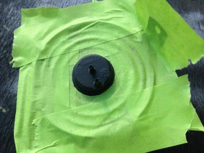

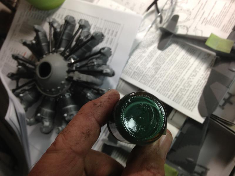

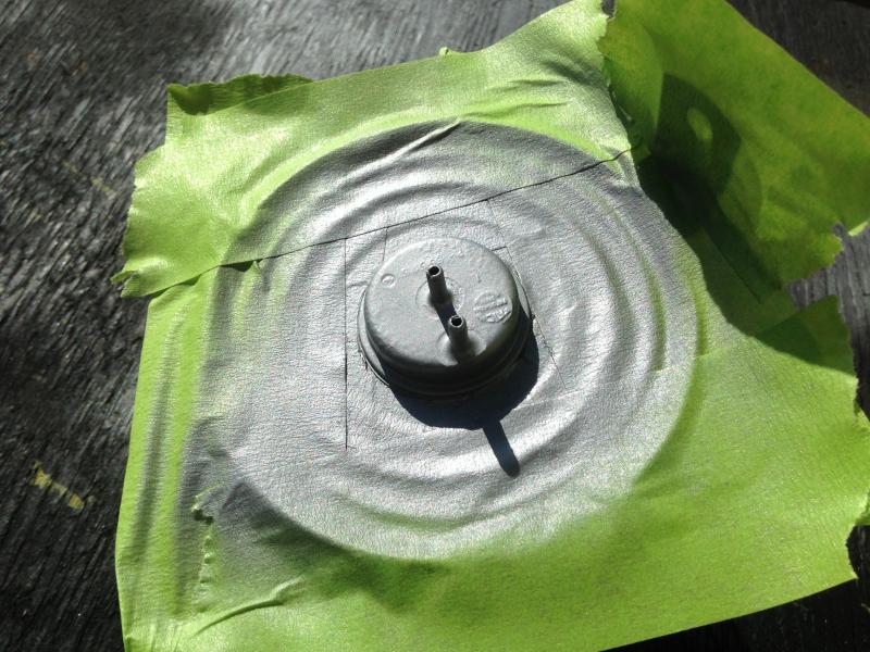

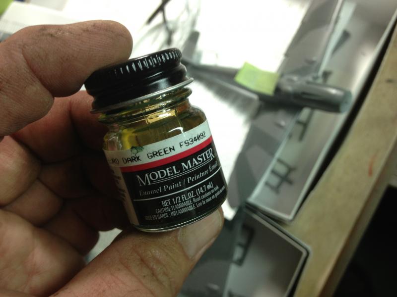

image.jpgimage.jpgimage.jpgThis color is a model enamel paint and is very close to the inspection paint mark that I found on the original canister. It's made by Testors and is in the "model master" enamel paint line.
Its called Dark Green FS 34092
I used the underside of the Duster's hood for a good color contrast to show the finished part.
BTW I used Rustoleum metallic spray paint to duplicate the original finish on the center of the can. The color is called "Metallic Matte Nickel".
One more thing I can mark off the list!!!
Take care and enjoy the rest of your weekend.......
Thanks for the how to and by way everything pops against that yellow duster backdrop so good choice
Great tips on the vacuum can resto, 71airgrabberRR. If anyone else finds pinholes in theirs, these cans were used on a lot of different makes. I have the identical can (just matched it to my '70 RR airgrabber) that I pulled from a 1973 Olds Cutlass, where it was used for controlling the heater/AC doors. Presumably it could be found in a lot of similar cars. Like yours, the bracket itself is different, but you just showed us how to fix that.

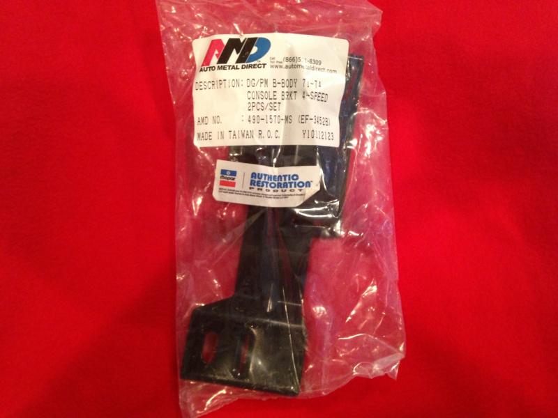

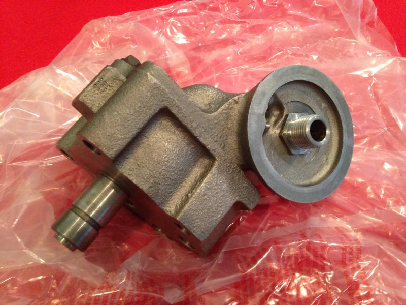

image.jpgimage.jpgimage.jpgHere are a few pictures of the parts that came in yesterday when I was at work.
The high volume Melling oil pump , part # M63-HV and the AMD 4 speed console mounting brackets came in. I'm expecting a lot more parts to start arriving during the next few days.
anyhow here are the photos..... Enjoy

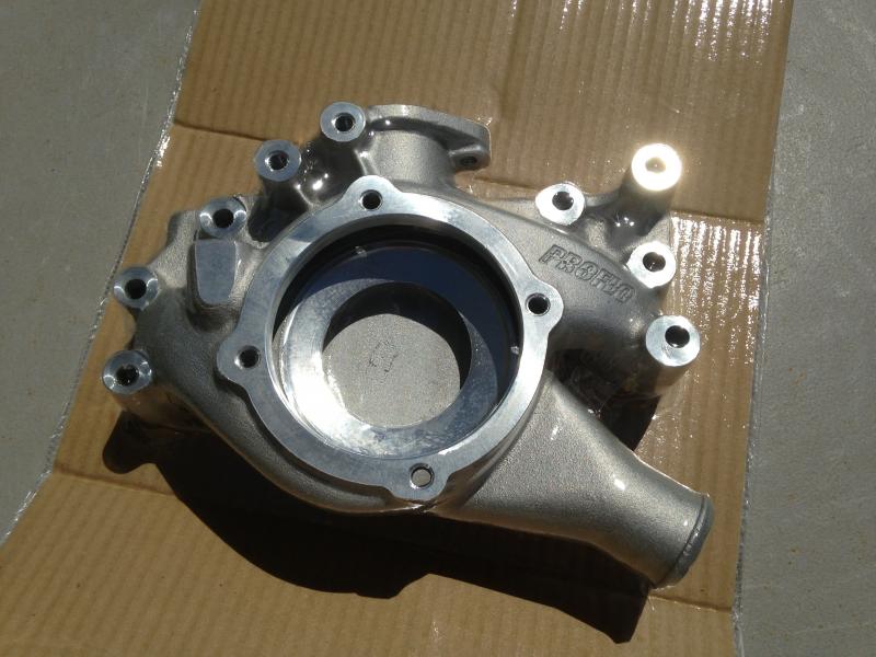

image.jpgimage.jpgThe FedEx guy just dropped off the aluminum water pump housing that I ordered from Summit a few days ago. When I ordered the part I spoke to a sales rep to make sure the part had Mopar casting numbers like shown in the pictures on line. I am going for a stock looking engine with hidden "upgrades" shall we say.
When I opened the box inside was a nice looking housing but NO FACTORY STYLE CASTING numbers!!!!! (Or Mopar pentastar)
Damn it man.......
So if you plan on ordering a new housing with casting numbers on it.... Don't order this one. It does look to be a good quality part though. I can fill in the logo and no one will be wiser. CVR part #7426
At least the part was made in Canada and not some Chinese crap like some of the other stuff we need for our cars that's not made here at home.
Hey things don't always go as planned.
So now the dilemma..... Keep the part or order one from Chrysler......
Whats your opinion???? Learn from my mistakes.
Does anyone know if this is the same housing offered by 440 Source???
