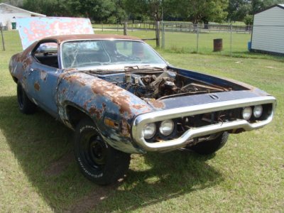

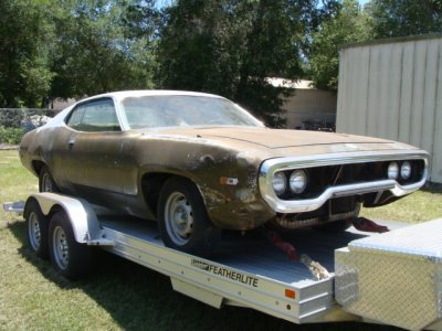

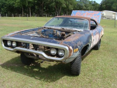

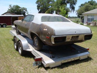

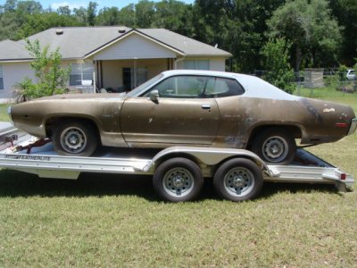

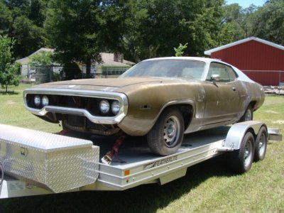

We picked up this car that was on eBay. It looks a lot worse than it is. The frame rails, trunk floor and rear floor pans are perfect. Someone previously sanded down the exterior and began spreading body filler everywhere. Then the car sat in storage for years.
It is a true N96 air grabber B-5 blue Road Runner that originally came with a full black vinyl top. It also left the factory with a 383 and a column shifted automatic / bench seat.
We have been talking about making a 440 six pack / pistol grip 4 speed with buckets out of it, since the original engine / trans are long gone.
What do you think??? I have a correct date code 383 and 440 for it. Which way should we take it??
I want to keep the original color combo.

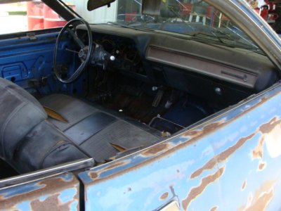

The interior on both cars are pretty much in sad shape. The driver side floor pan on the 71 RR has a huge hole right where your feet would sit. I removed the original carpet and head liner. Surprisingly the black plastic door panels are pretty nice. The 3 spoke steering wheel was missing the center cap, but I located a decent one and should have it in a few days.

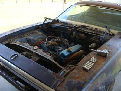

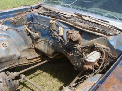

DSC03578.JPGDSC03579.JPGDSC03580.JPGDSC03581.JPGDSC03582.JPGHere are some pictures that were requested by you guys yesterday.

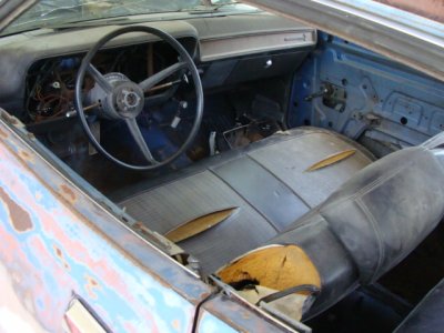

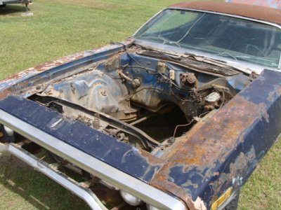

They show the engine compartment and the interior after I removed the hood, carpet, and head liner. The last photo shows the good / uncut rally dash bezel and frame that I scored locally. The original parts were hacked to allow for an aftermarket radio. I want the interior to look bone stock, and will be installing an aftermarket radio that looks stock, but cranks out tunes pretty decent. My favorite music is made by the firing order 1-8-4-3-6-5-7-2......

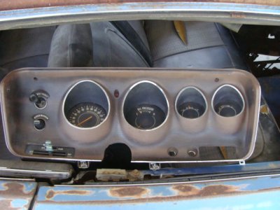

I transferred my original gauges over to the new frame and added the new bezel. I reassembled everything on the gauge cluster because in a year or so from now it will not be so easy to do. (hence the pictures)
I also have a lot less of a chance loosing anything if its all reassembled. When I restore the dash assembly, that's when I will take care of the instruments.
When I start a project like this, I always photograph everything in it's original state. It makes life a whole lot easier down the road with reassembly, and documents what the car was like for originality. (plus it's cool to look at how much progress you have made...)

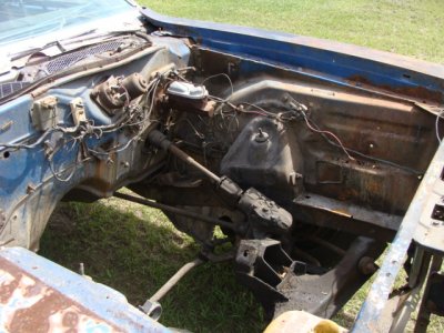

The picture of the passenger side inner fender well shows the location of where the vacuum canister for the air grabber is located. It's amazing at how sloppy the seam sealer was from the factory....It must have been 5 O'clock LOL. You can see it in the top left corner of the picture.
It is supposed to be in between the fender and inner well. Half of it missed the mark and ended up on top of the inner fender. It was then painted over in B-5 blue. These little things like this are what to look for if your going for a 100 point car.

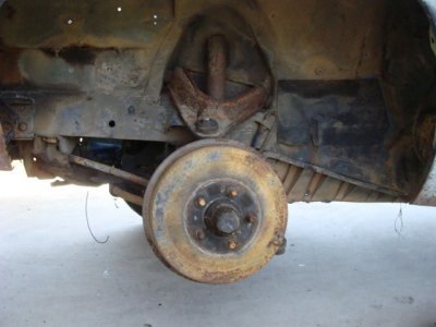

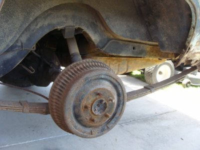

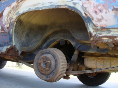

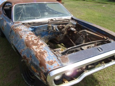

DSC03583.JPGDSC03584.JPGDSC03585.JPG These pictures show the condition of the frame rails and wheel wells. You can see the car came with drum brakes on all 4 wheels.
Like tallhair said. "go to at least discs up front, to make it whoa and go, use the 440,".
I plan on driving her, so she needs to stop when needed. It's a manual brake 4 drum car. In the interest of safety, that will change. On the plum crazy Challenger, I went with a Wilwood 4 wheel disc set. I'm not 100% sure what route this one will be just yet, but it will have at least 2 discs up front.
You can see the lower quarters are pretty sad. I plan on replacing them with a set from AMD.

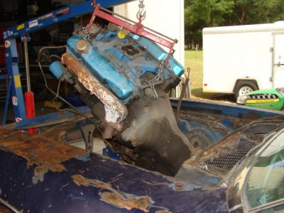

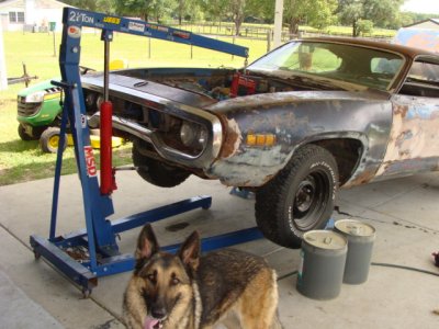

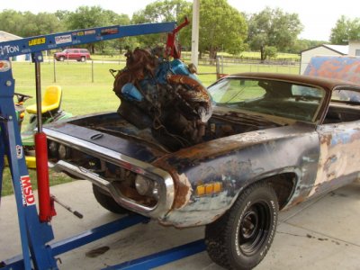

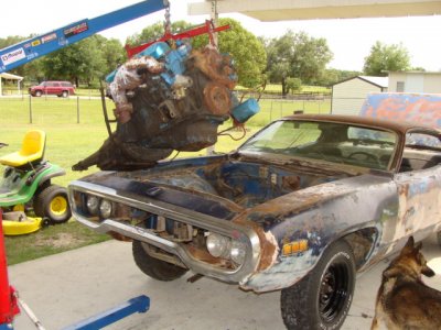

Here the cast crank 400 and 727 transmission are coming out. My German Shepard likes to help !!!!
I sold the long block engine along with another 400 I had to a local racer, who will be using it as a replacement stroker engine and spare. He has a nice Dart that runs in the 9's on throttle alone, until a rod decided to ventilate the block......
I pulled all of the accessories like the distributor, motor mount brackets, intake and exhaust manifolds, etc. and stored them for later. I plan on using a 440 source or Mancini Racing aluminum water pump and housing up front to shed a few pounds. I have a new set of aluminum 440 source Stealth heads that will help the weight diet too. Once everything is painted Hemi Orange, you will never know. (Especially the blue oval and bow tie boys....) :)
Any weight taken from the front of our old Mopars always helps with handling and stopping.
DSC03599.JPGDSC03600.JPGDSC03601.JPGDSC03602.JPGDSC03603.JPGDSC03604.JPGDSC03605.JPGDSC03606.JPG

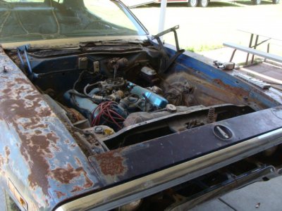

Here is the end result. A big empty hole.......... Some would say a money pit......No wait, that was my first wife !!!! LOL
I took these photos to show how everything was installed originally in the engine compartment. I know the fenders, doors, trunk lid and windshield all look horrible, but I have some very nice replacement panels, and I always install a new windshield in my restorations. She has potential, and another bird will be saved from going to China as scrap metal......

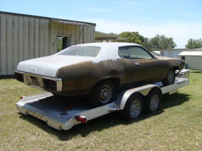

This car is actually in pretty good shape, and I have decided not to cut anything out from it. It may end up as a future restoration...
This body shell has some rust in the lower quarter panels, and a small amount by the top of the driver side "A" post, but everything else is perfect. And it has A/C, P/S and Power Disc brakes. The 318 in it runs great. We drove it on the trailer.
