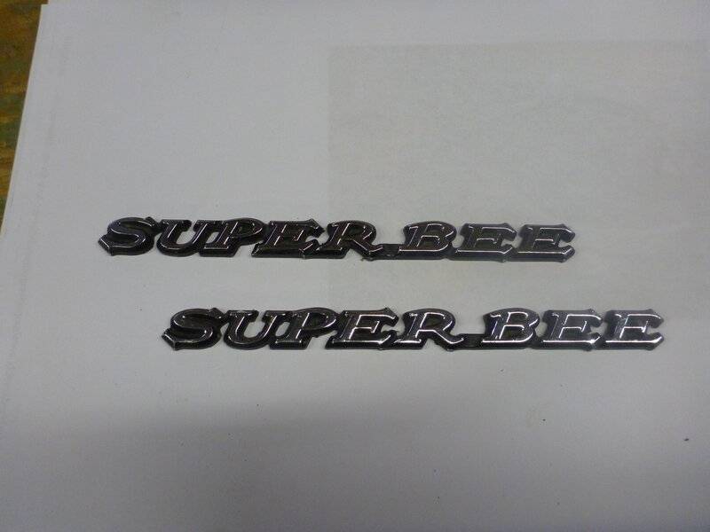

You might need a pair of these...
I removed this pair from a '71 in 1978. Clean as they get "used".
Edit.. ya make me an offer. Decoration in the shop these days, but I could let them go to a good home.

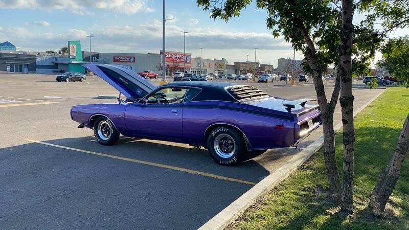

I bought an original, unmolested ‘71 in ‘76 that my friend still owns. It did not have louvred tail lights.
Lime green/yellow car, chrome bumpers, 383 auto.
Sold new up here in the sub arctic, it’s in northern Alberta now.
