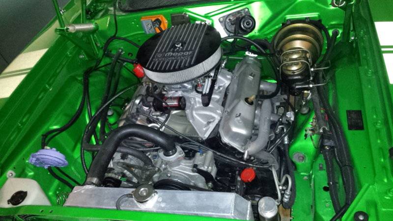

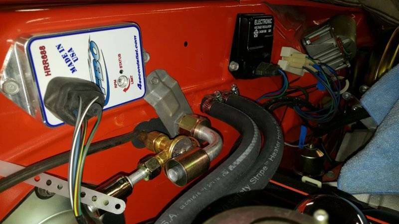

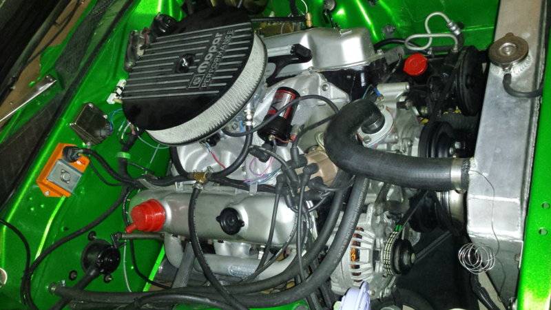

Here are photos of engine bay to give you an idea of components etc.

It will be fuel or spark. Remove the breather and look in while you pump the carb linkage. You will see fuel from the squirters if its getting fuel. If so then remove a plug wire place a screwdriver in the boot from the plug hold it close 1/4 inch from a grounded metal part and crank it over you will see a spark or have someone hold it by the metal end of the screwdriver and see if it makes them jump. This will normally let you know which it is. then go from there. It could be as easy as a fuel pump or filter or a cap, rotor or coil. Let us know what you find. Good luck.
Most likely the orange box, they have a fairly high failure rate. It's not recommended for use with the old style points regulator, although many seem to do it.
I like to pull the coil wire out from the distributor it should spark more rapidly than using a plug wire, but either way is fine.
It should spark blue and be crisp, not yellow and lazy.
The wires would not just go bad, especially if they are newer.
With key in run position make sure you're getting about 6-8 volts from the ballast resistor and 12 volts going into it. That will eliminate key and ballast resistor. It looks like he has the electronic regulator.

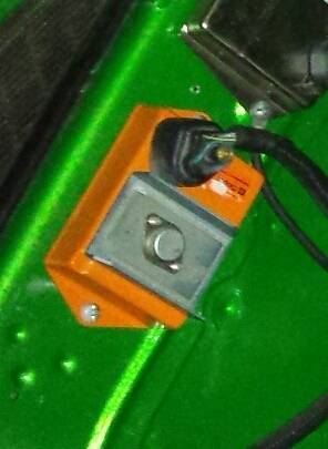

Just a suggestion, sand the mounting screw area on both the box & the firewall. A good ground is needed.

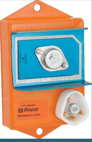

Here are pics from the classic site and from my engine bay:

The orange box ($54.99) is treated up to 6000 RPM, whereas they have a chrome unit ($89.99) rated at 8000 RPM, might it have less of a failure rate than the orange? Naturally I'll ask classic but just wondering if there's experienced input here

make damn sure you have metal on metal at the ignition box and firewall, firewall to engine ground, engine to battery and battery to body grounds. that will kill spark in a second without it.

OK battery is in trunk, so I doubt there is a direct engine to battery connection. But car had been running fine for a while prior. I'll check metal contact at ignition control box.
