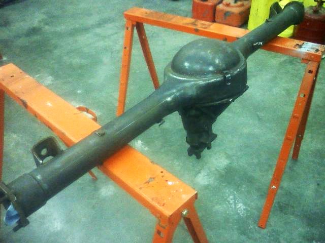

ALso have a brake questions!!! Will be running a 8 3/4" rear from a '71 up bbody, which has 10" drums. I would like to run 11" but where on earth would you find a 11" brake setup? Ican get everything new except for the 11" backing plates I think. I see the 9 1/4" rears with 11" only have 4bolts holding on the backing plate where the 8 3/4"rears have 5 bolts! I was thinking maybe a '74 older pickup since they have 8 3/4" rears on the half tons? If not, will just go with the 10" combo! Ideas?
Thanks again for the help!
-J

Thanks for the info!
Actually all I would use on the truck axle would be the rear backing plate if it was 11" and use my 71 axles (5 x 4.5"), and then buy all new 11" drums etc. for the small bolt pattern. (Ya you are right, the trucks up till '74 used the 5x 5.5", then they went back to 5x 4.5"). I think it's gonna be a hassle and timeconsuming to find a 11" backing plate, so I may as well just go 10", ya those 11" drums are kinda heavy! Got it all cleaned up for paint, will replace axle seals and start assembling brakes!

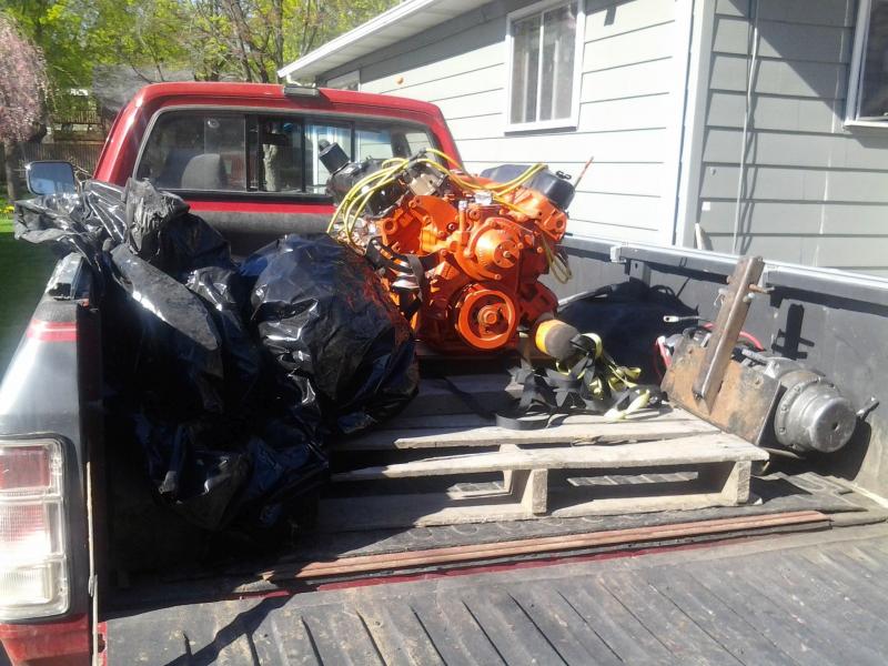

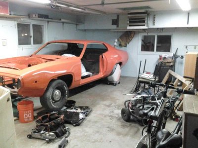

'72 Satellite Project
Kinda tough to move a dismantelled car and parts and pieces this year to our new place!
Finally got settled in to a little garage but should be enough to get the Plymouth back together!
Check out the move!
-Jimbo
