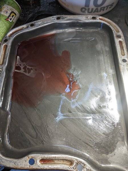

The shop pulled down the trans pan and it was full of metal. It might be cheaper to replace the transmission and am wondering what I should be looking for? It looks like some 727s are big block specific, does that sound right? Are there any suppliers I should avoid? If I'm paying the labor to get it swapped I want to do it with minimal drama.

Was it working ok? There always is some debris in the pan. Seeing a picture of what It looked like might help. Myself I would just rebuild what you have. FYI the 727 is available both small block and big block.

What kind of metal? Shape? Size? Is it magnetic? How much is there? Was the trans experiencing issues beforehand? No way is it cheaper to replace than rebuild. Unless the shop doesn't know Torqueflites. Lets see a picture of the debris. If it's operating correctly there may be no issue. Let me know. I build a bunch of these.

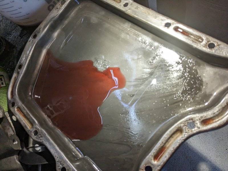

Thick blobs of sparkly paste. I've got a spare 727 available that I'll probably try.

It would be nice if you answered all the questions. People try to help but without relevant accurate answers its any ones guess. As far as thick gobs of sparkly paste that could be very much be normal on a transmission with no service history.
Thick blobs of sparkly paste is normal accumulation of band and clutch friction material. Steel chips detected with a magnet usually mean a torque converter failure. Disassembly of your transmission and inspection will tell you what went wrong. I have used A&A Transmissions, near Indy, as a supplier of rebuild parts in the past. Also, take DVW's advice. He has been around these Torqueflights for a long time, too.

There was another container that had more, but no real chunks. Just a LOT of glitter.
Install new filter adjust bands install new fluid and see how it runs and shifts.
You never answered the question of "was it working okay"...
If it was and that's all that was in the pan, run away from that shop as fast as you can and keep driving....
