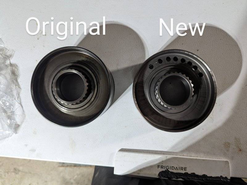

Hey quick question, I'm rebuilding my 727 transmission (first time ever doing so) and the low/ reverse drum had a crack in it so I ordered a new one. But the one I got is slightly different from the original stock, will the new part work or not?

Ask @dvw, have read a lot of his post

That amount of balance holes doesn't seem logical to me though. I think I would try to test it somehow for out of round and balance before I'd be comfortable using it.
