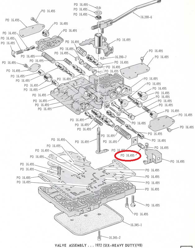

larry,
drop your trans pan and find this (see attachment):
turn the hex-headed screw so that the tension on the spring becomes less (you will see the spring become longer), about 3-5 turns. This will lower the pressure within the valve body a tad so to create less firm shifts.
BUT.. when you put in a shift improver kit and then adjust the valve body to a different specification than what was recommended by the kit, there are some symptoms.. these can include, but are not limited to:
1. lower performance (e.g. 1-2 and 2-3 shifts will not be precise and firm)
2. clutch disc wear would happen sooner (but it will still take a long time, so its a byproduct and I had to mention it, but I would not be too worrisome about it)
3. dependent upon the improver kit, you could receive some overlap in your 1-2 and 2-3 shifts (possible.. but very iffy)
Have to say that just so you know what to look for if you are not pleased with the peformance.
