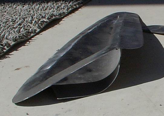

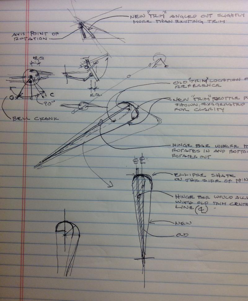

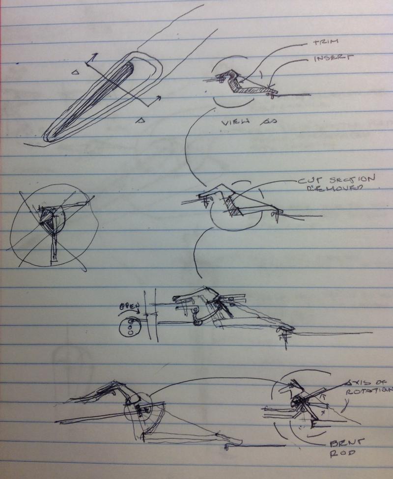

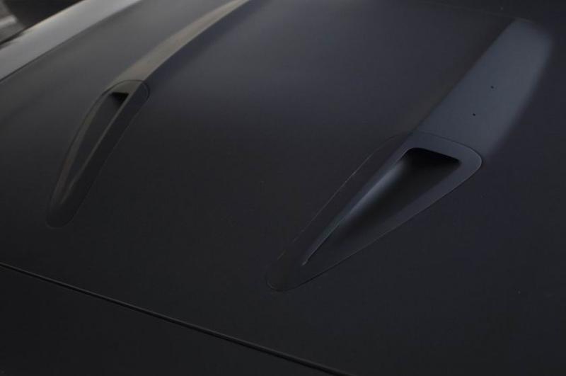

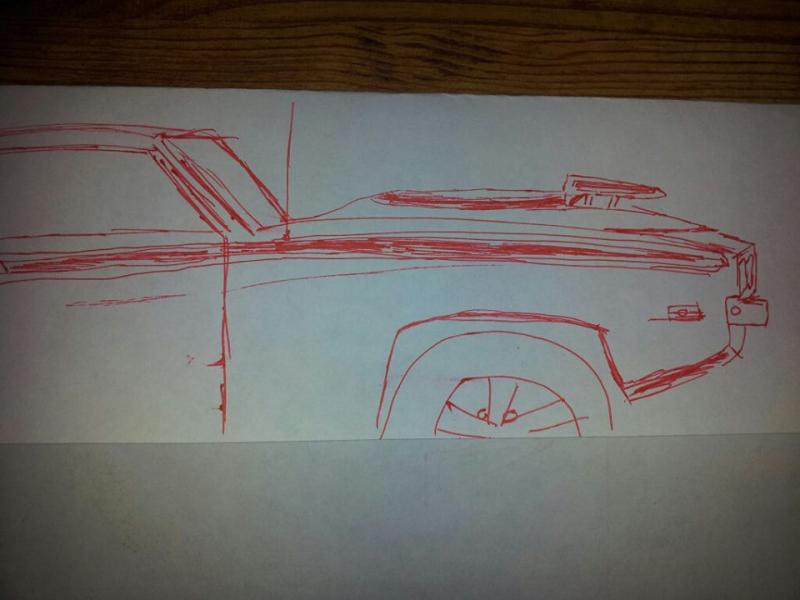

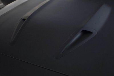

Here's the first set of idea sketches for the "nostril" vent openings into the hood inserts that would open.
By pitching out the trim " throttles" out at the base I can get a larger opening that would allow substantial increase in the open area.
