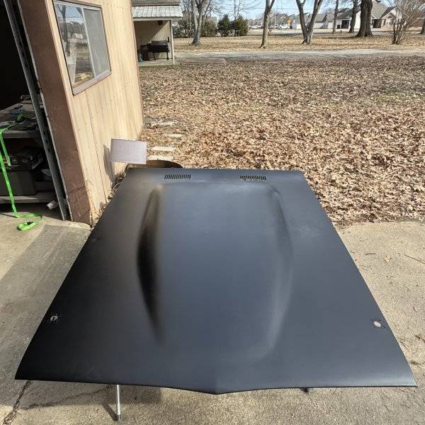

What intakes can be used with bulge hood?
Best performance option- trying to get 600+ hp. Please help. Was looking at TF top end kit with track heat intake.

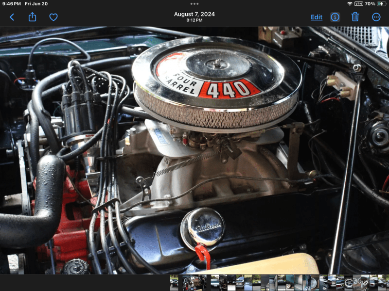

Have a Edlebrock Torker II on my 74 440 RR. Coming off this week to install dual snorkel air cleaner which is 1” taller than the 2 1/2” aftermarket in the photo. That is how tight it is.

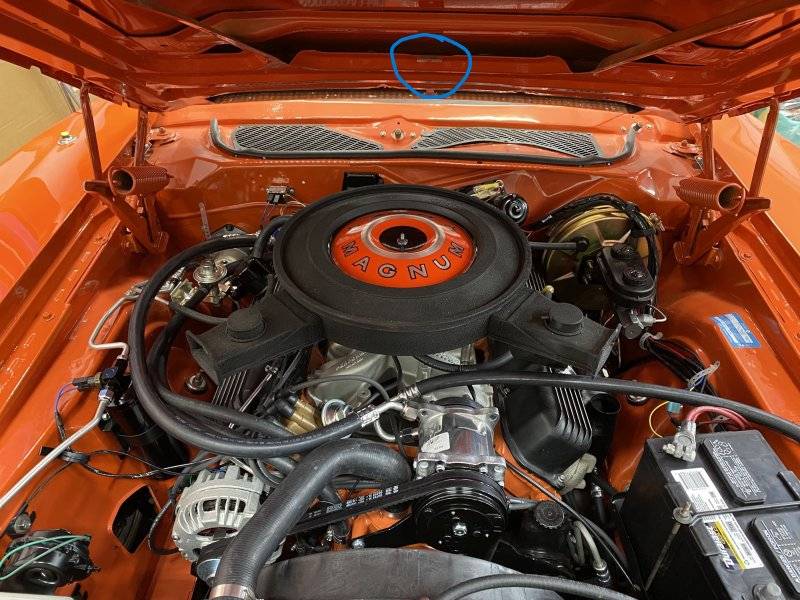

440 with a performer RPM with a stock air cleaner barley fits under a bulge hood. There is a tab that sticks out in the center towards the rear that I had to bend up to clear. I would just trim it off if your hood is not finished. Circled in this pic.
And it definitely doesn’t fit with a Torker and stock air cleaner.

With a bulge hood, you can run any of common 4bbl hi rise intakes. It will come down to what air cleaner you put on top of it, if it has a dropped base, and how tall a filter you put in it.
