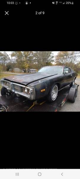

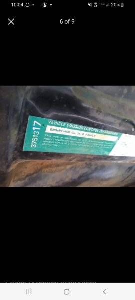

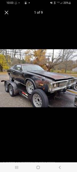

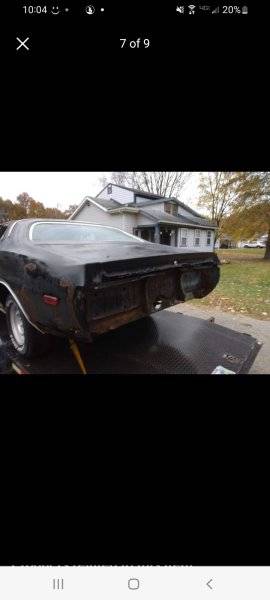

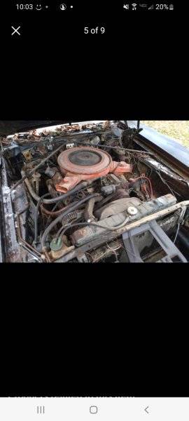

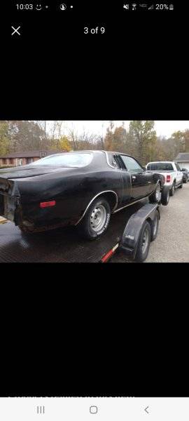

I found this 73 Charger SE with big block for sale(which I'm thinking about buying). It's one of my dream cars and it's $2900. Do you think it's worth $2900? It has rust, missing rear bumper(and taillights), and doesn't run.

It's hard to tell from the small and mostly poor angle pics.

A running 400 can be found fairly cheap. There is on on CL near me right now for under 5K, with receipts.
(I paid $300 for one with a trans I heard run about 5 years ago)

It's the little stuff that gets you as well as the big stuff. Things like hunting for a big block K-member, correct kickdown linkage, rallye cluster, driveshaft etc.
These photos have us only guessing as to the condition of the doors, fenders, cowl and floor. For sure the trunklid, quarters and dropoffs are pooched which leads us to assume the other metal is shot.
Hard to really judge by the pics but a big block tx9 sunroof car is cool. Rust is the big factor. With all that crap on the cowl look close under there. Is the sunroof assembly all there? All I can see is the hole. Big $$ to get that one in drivers shape but worth a look at the price.
