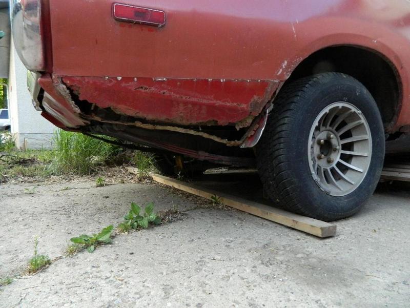

Here is the rust section I need to fix and don't know if or what needs to be done, hope pics work resize 5.jpgresize 8.jpgcharger resize 4.jpg
Pick this up a yr ago and now starting to make my list and start taking things apart, thx for any help that you may be able to give me on this....

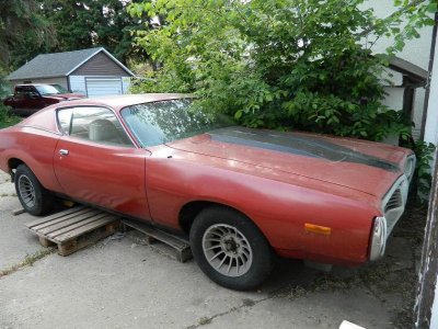

Looks like a fairly decent start other than the lower back. Since you are stroking the 400 I would go with a 511-512ci.

The engine tech are the other guys expertise. At the very least you're going to have to replace the lower 1/4's with new metal and probably the trunk drop downs inside. I see there has been some repairs made to the wheel well. Once you start sanding all that off, you may find yourself needing new quarters. Check some of the restoration catalogs, I think they make new 1/4's for the 72. Is the other side like that also?

Thx drivers side not as bad but if I did one side I would do others if needed and yes I would do it. Yes you can buy lowers quater , thx
Well I stripped the whole inside of car and trunk today except the dash yet, so looks like drivers side can be fixed up but need pass side lower quarter, rocker panel and inner wheel well all on pass side. I have 2 spots inside car that needs couple patches about 4" x 4" then couple small dents fixed, my buddy has a portable blasting machine I can use, but what media material should I use on the car, and then what is the best spray primer should I use after, just till it gets to the paint shop, I will post some pics tomorrow, Thx
