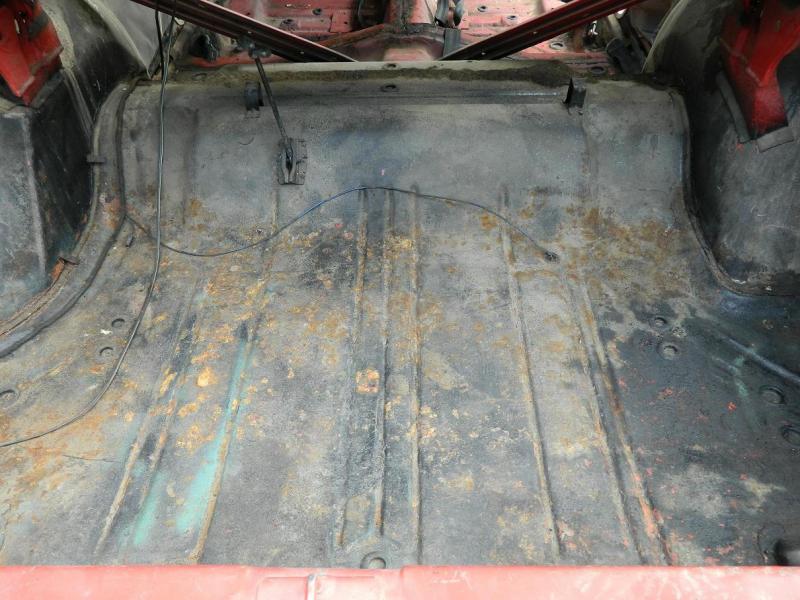

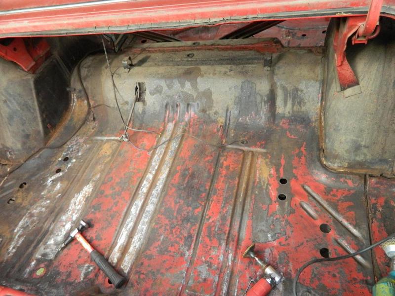

I am using a portable blaster, lol but just to do hard to get spots inside car, gonna get a shop to do exterior, only 1 small hole inside and one 3x4 size rest is good, then I sanded the roof inside by hand. Having trouble cleaning trunk as the last guy spray with box liner, but didn't clean first so it's pealing all over. The hard part is removing the stuff that stuck, hmmmmm I am using glass media in blaster, I will post pics tomorrow of the inside, still slowly getting things apart on dash, lol I ordered a bunch of parts last week and also today so mail man will be knocking lots, yahoooooo.....

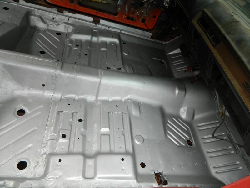

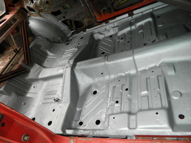

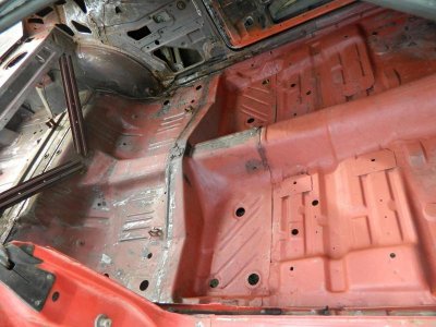

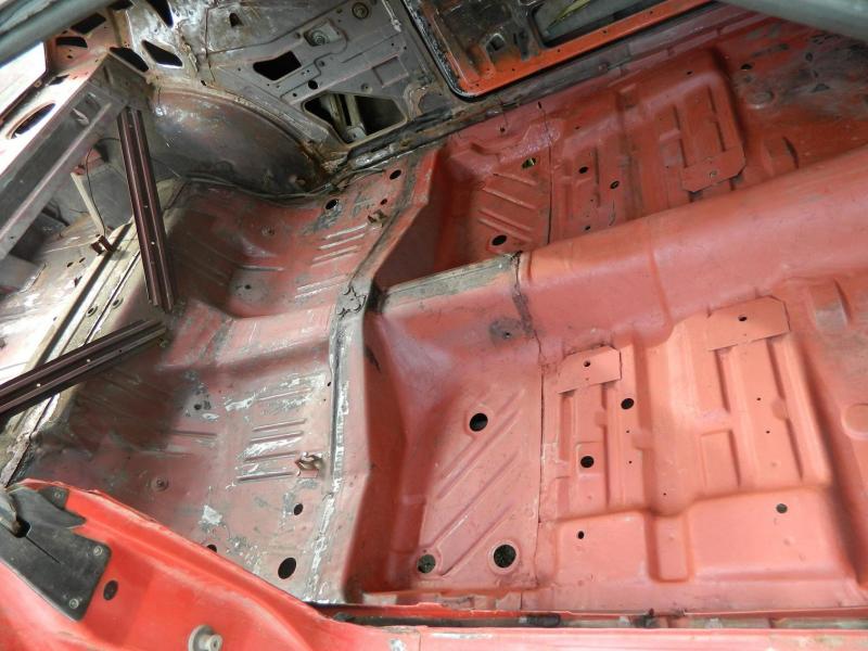

Before and afterresize floor 1.jpgresi floor 4.jpgres floor after.jpgres flor 4.jpg

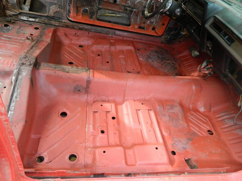

Here is the work that had to be done in trunk, it was a messres trnk orig 1.jpgres trunk 1.jpg
