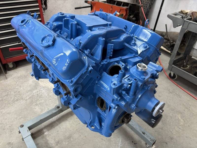

Looks great! I wonder if they make the turquoise for the 66s? I'd like to dress up the engine in my coronet, but that will be when I rebuild it at the end of the season.
Not listed on their site. Just Hemi Orange, Red, and blue for Mopar.

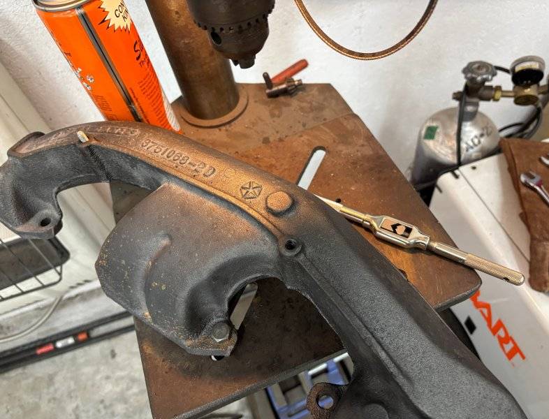

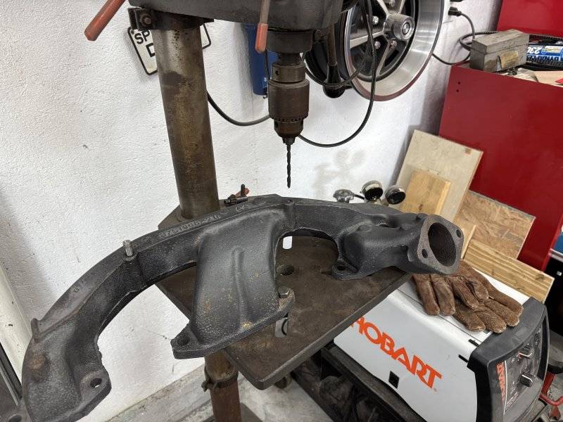

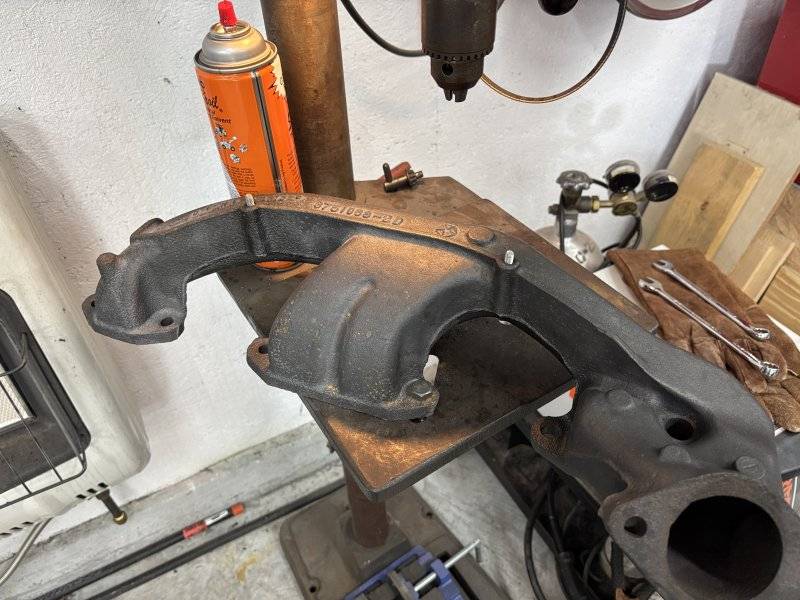

Had to fix the broken studs in the drivers exhaust manifold so I can use the factory heat shield. PITA, 1/4-20 in cast iron. Was able to get them drilled out with a #8 drill bit then tapped them to clean em up. Was really handy to be able to bolt the manifold to the press. $180 was well spent on this 70's vintage drill press. Also got the exhaust studs installed on the engine. Really happy with the paint, looks even better after setting up.
I trash picked my drill press, needed a motor...... I don't need it often; but is comes in handy......I had an old motor (40s maybe?) laying around; it spins the Wrong way; I made the belt do a figure 8..... I smell rubber every time I use it; been that way for about 20 years....but it works :D

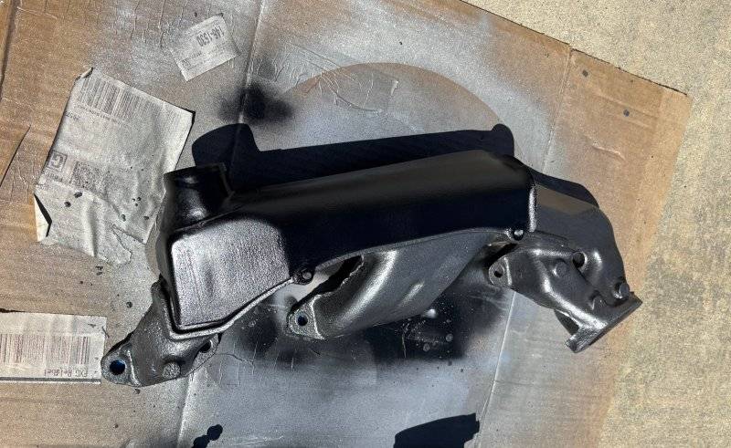

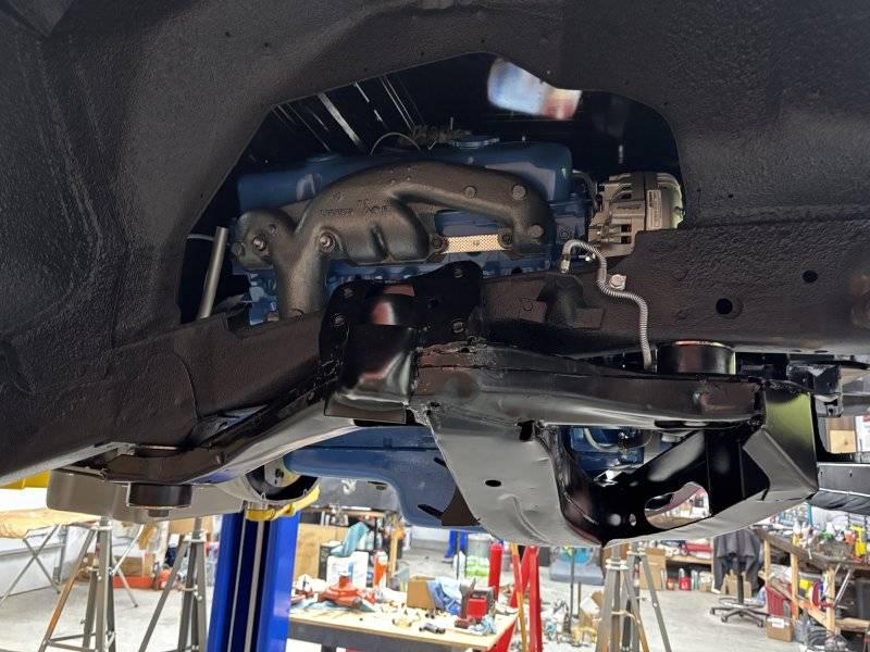

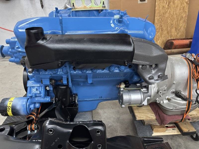

Finished the manifolds today. Had to fix the attachment points on the heat shield. Welded a couple thin washers in it. Blasted everything. Coated the manifolds with eastwood High temp manifold paint and used Satin grill paint on the heat shield.

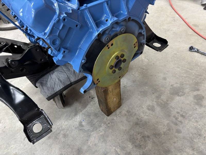

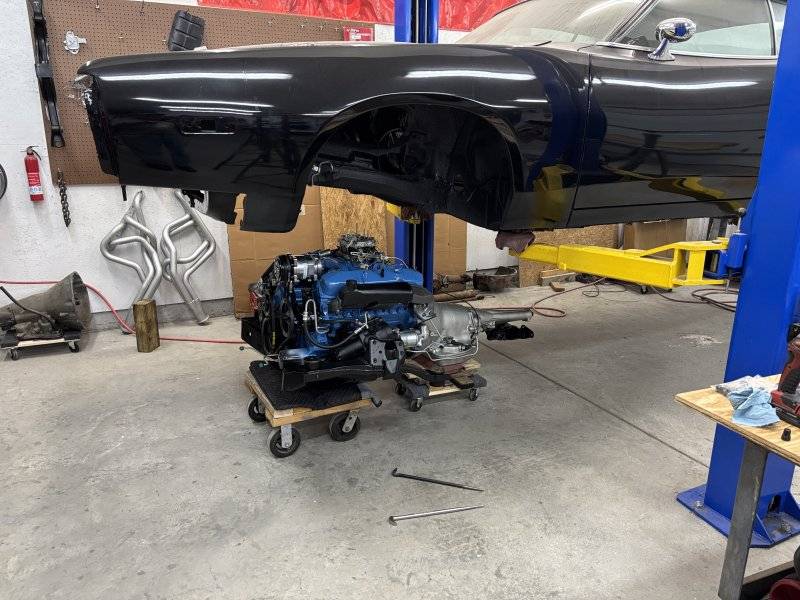

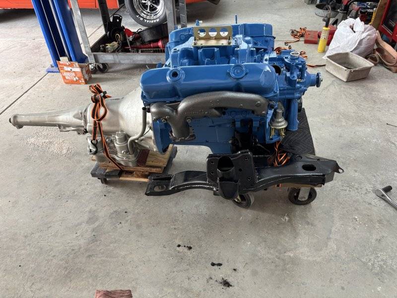

Engine is off the stand and on the K member. Trans is mated. Getting closer.

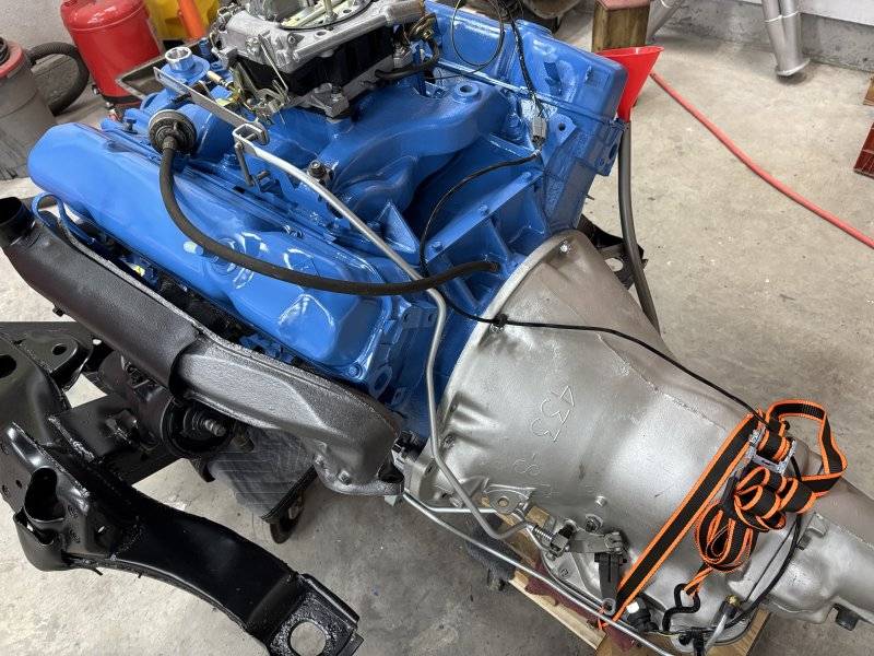

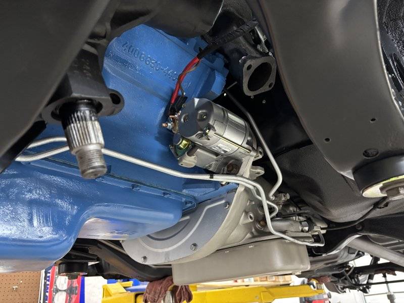

Got the starter and left exhaust manifold installed. Had to do some minimal grinding for the starter to sit properly. The exhaust heat shield was a PITA to fit right but I am happy with it.

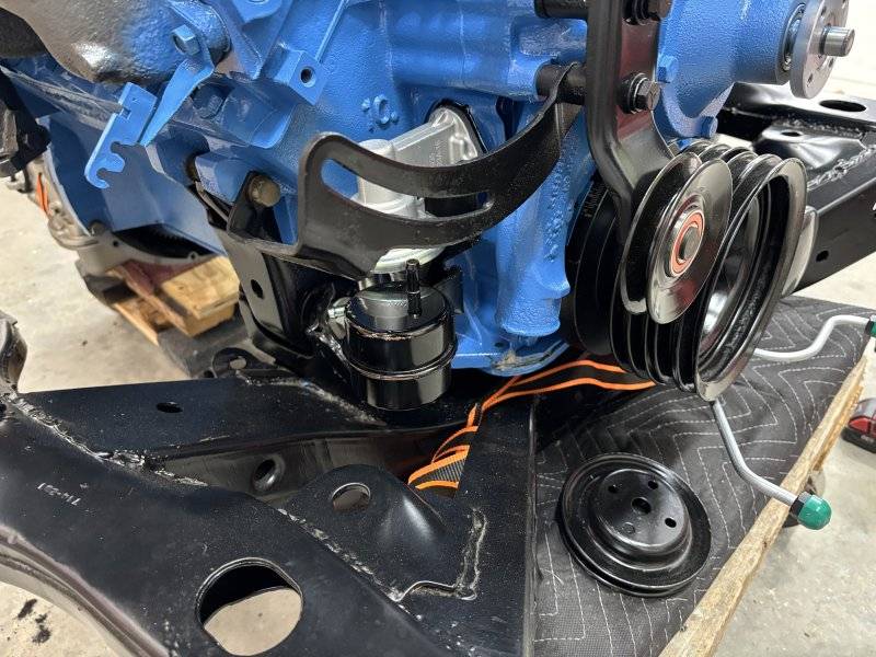

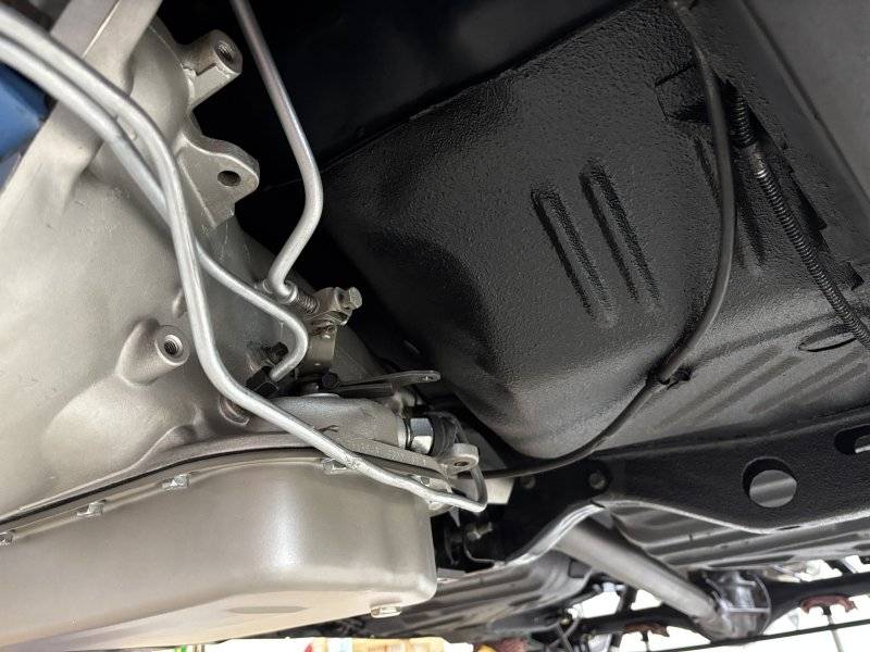

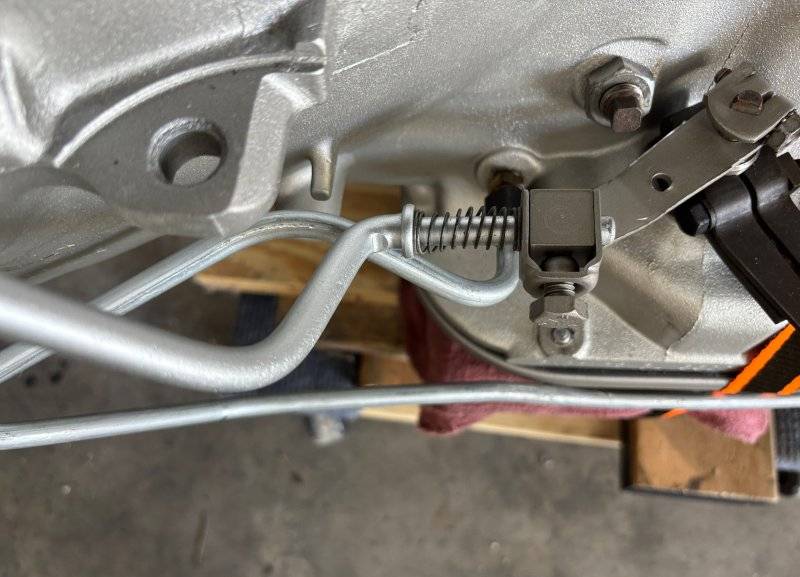

Got the steering gear and trans cooling lines on. The TQ is mounted is mounted and sorting out the throttle pressure linkage.

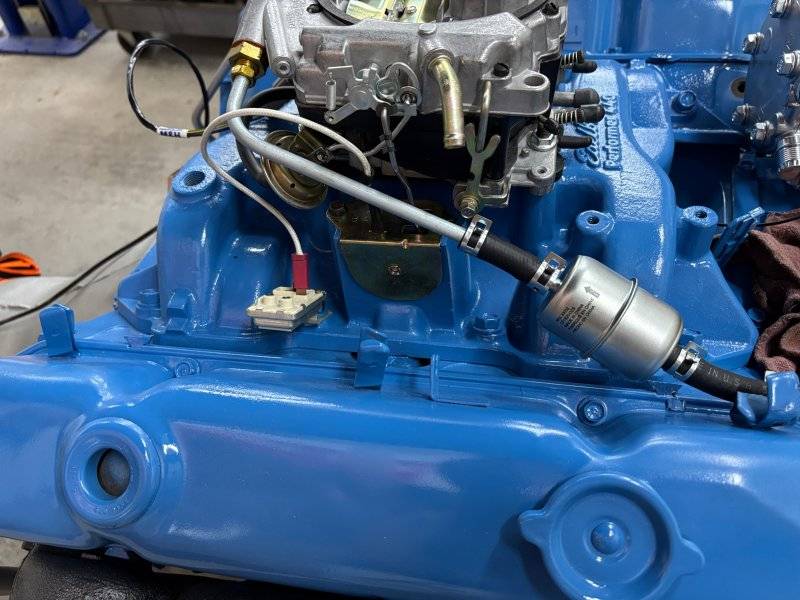

More little things. Trans throttle pressure linkage I had to piece together since there was none when I got the car. NOS fuel vapor separator and pulleys and brackets going on. Should have the PS pump rebuild kit and alternator this week.

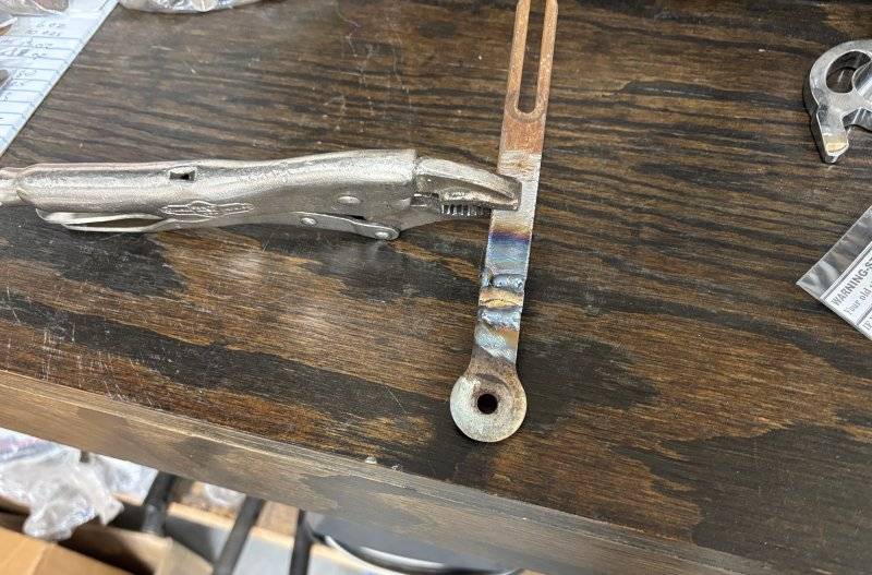

I was not happy with the amount of adjustment I had on the throttle pressure linkage so I took a spare carb link, cut it and welded in 1/2" of flat stock. This will get the adjustment more to the center and not maxed out at idle.

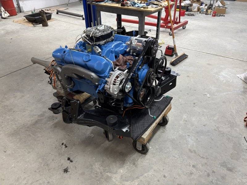

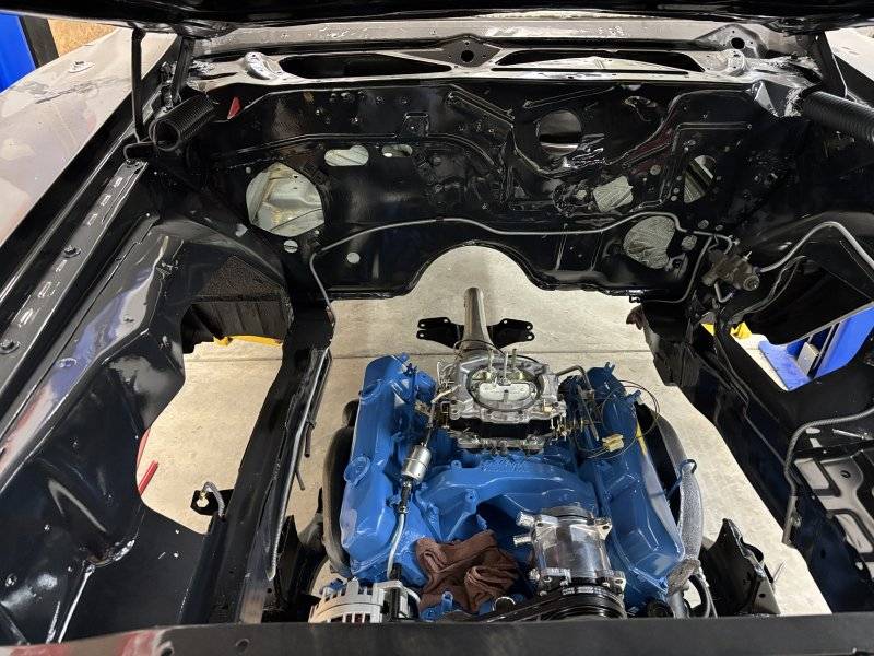

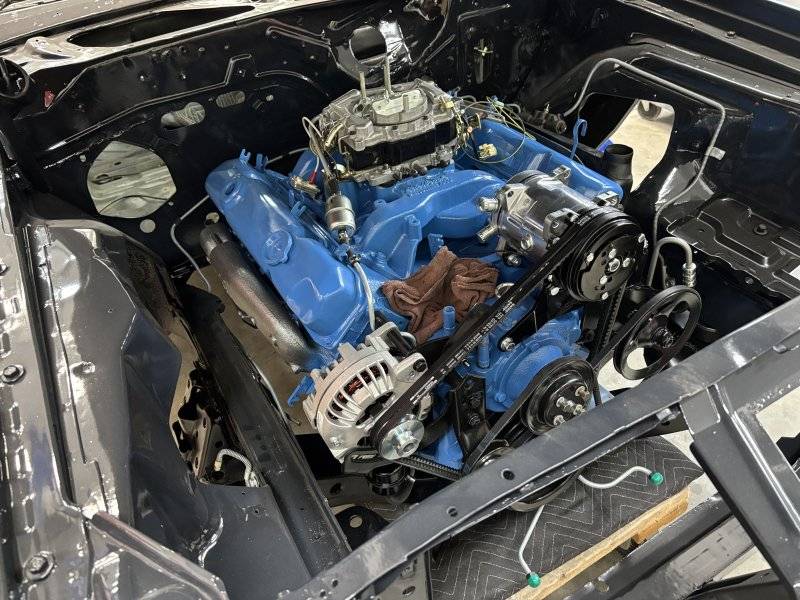

Installed the PS pump, AC compressor, and alternator. Took a lot of tweaking to get the alignment of all the belts right. I had a few test belts and was able to get measurements and ordered new belts. Almost ready to drop the car on it.

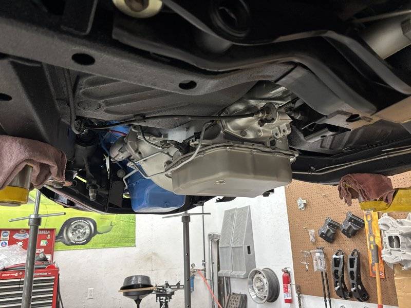

Finished up the accessories, fuel line, and choke controls and in she went. First time this car has had an engine in it for at least 35 years.
Got the new Spicier solid U-joints installed and the drive shaft in. Torsion bar cross member, speedo cable, e-brakes are in and adjusted. Torque convertor bolted up and the new battery cable installed.

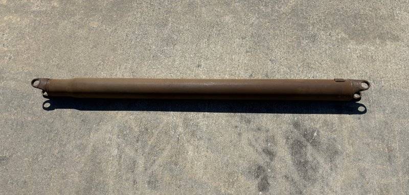

Drug the original head pipes out of the shed. They are in really nice shape. I took them to a repetable local exhaust shop and he wanted nothing to do with making a copy of them so I will lightly blast them and paint em up.
