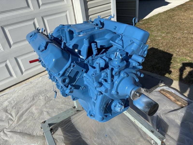

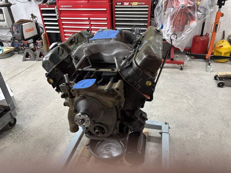

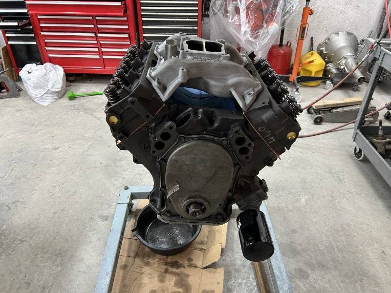

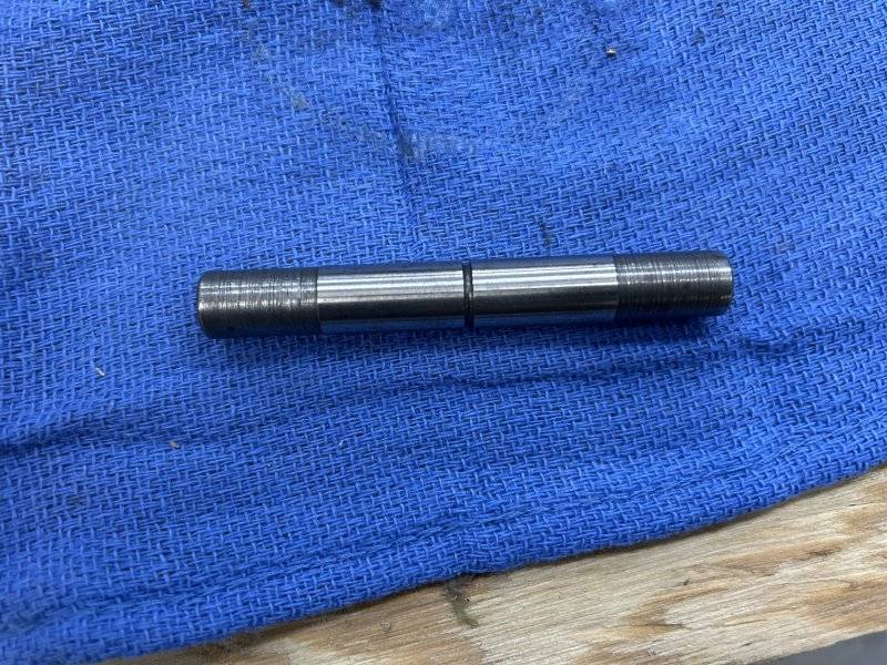

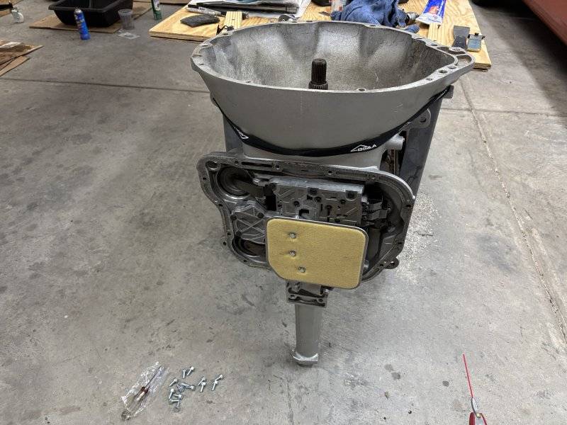

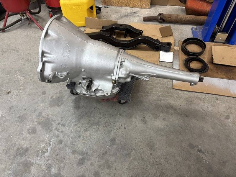

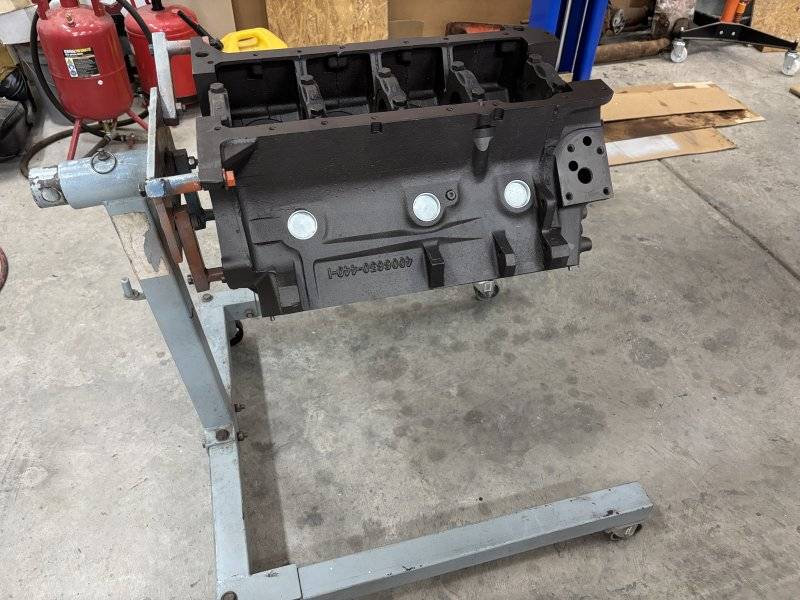

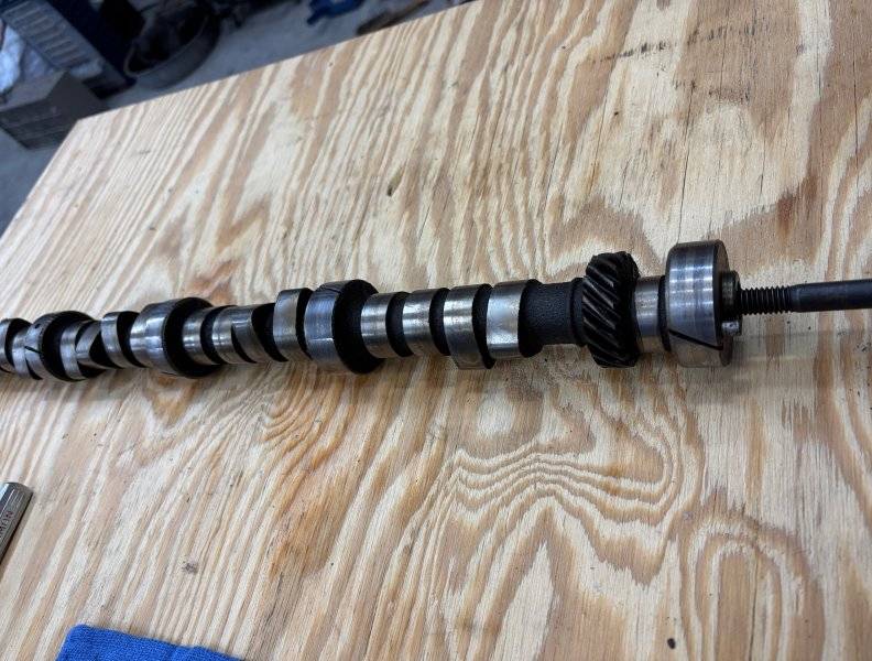

That's a great idea on the camshaft.After having a hectic weekend last week I was able to get the transmission finished up and adjusted. Next up is the engine. Looking pretty after being bagged for some time. I fitted the cam before cleaning to ensure it was not tight. I have run into this before and have a old cam with groves in the journals, pack them with grease, spin a couple times and it will clean up any imperfections.
View attachment 1770143View attachment 1770144View attachment 1770145View attachment 1770146View attachment 1770147View attachment 1770148

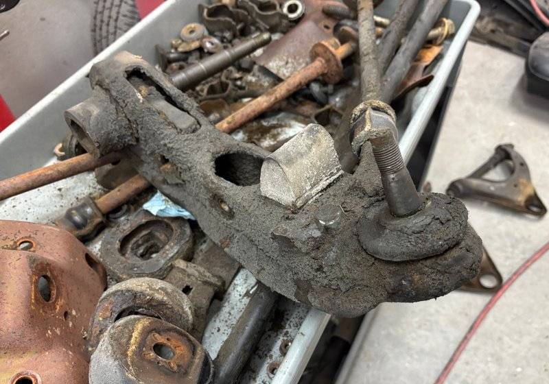

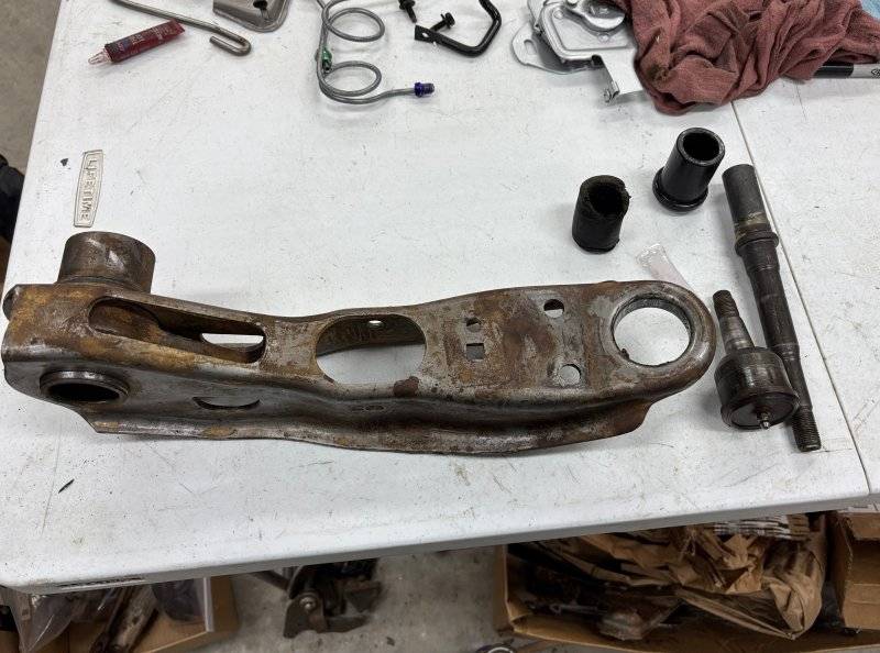

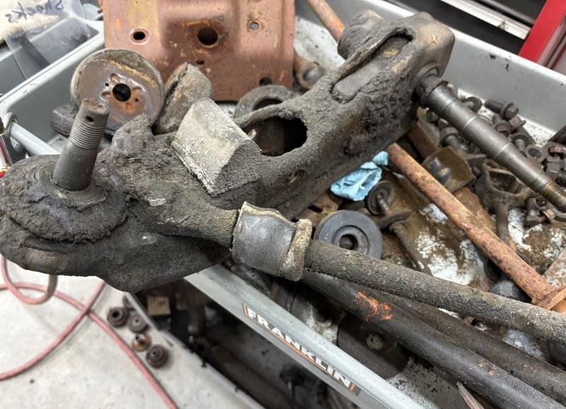

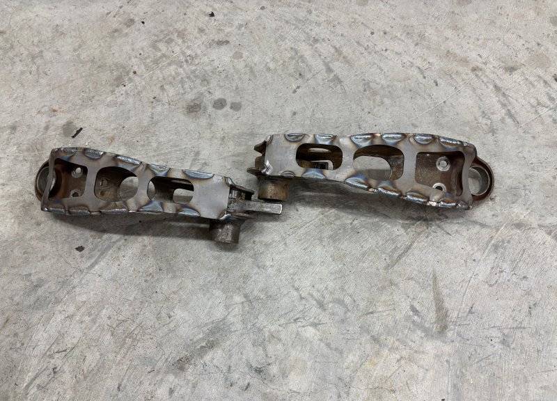

Looks good Jeff!Wife got me a new welding helmet for Christmas so I tested it out on the lower control arm reinforcements.

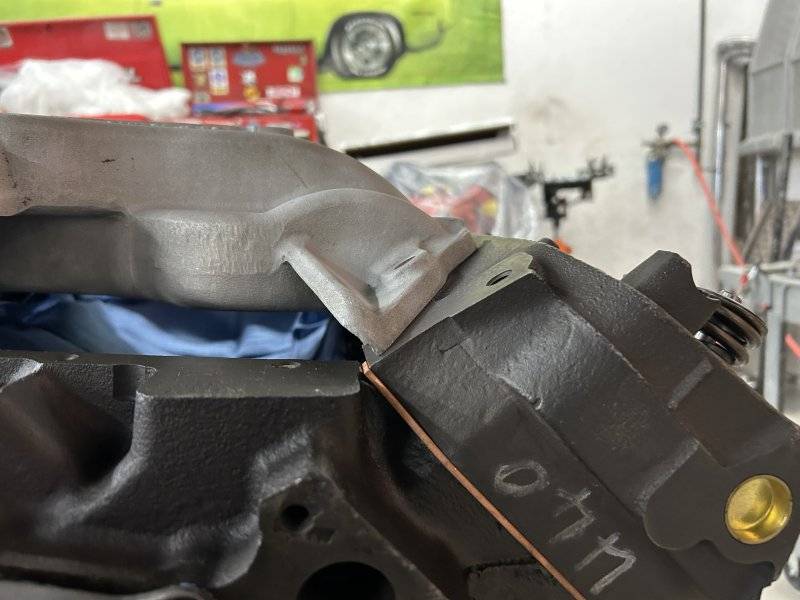

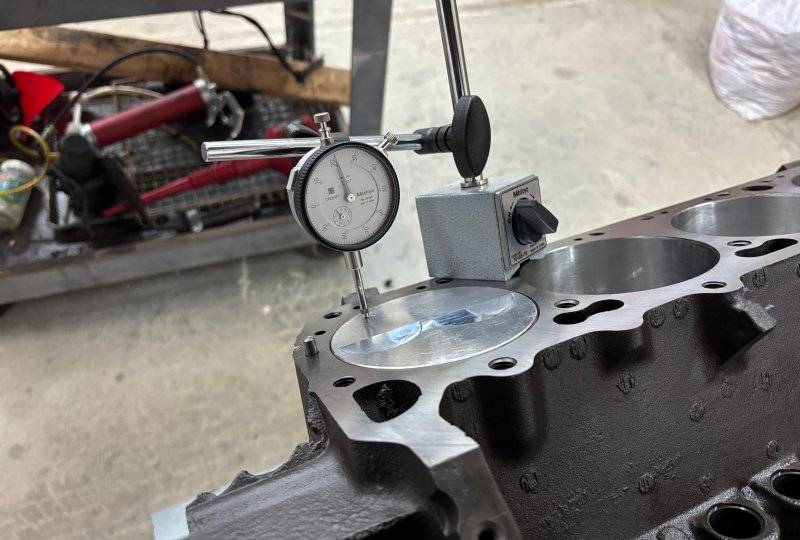

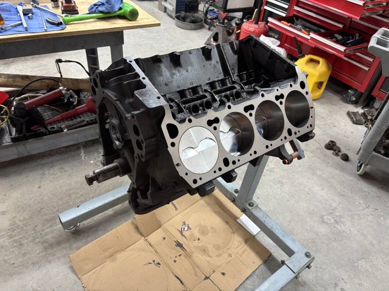

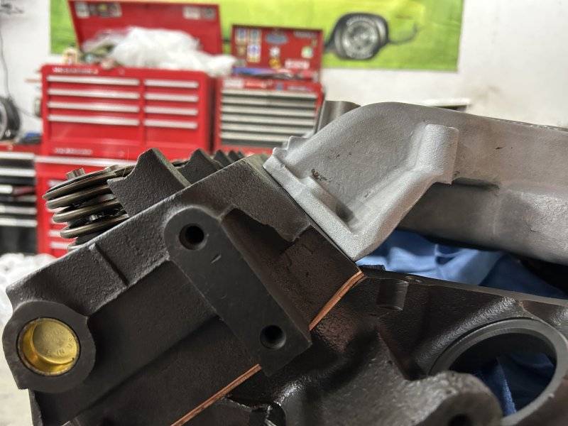

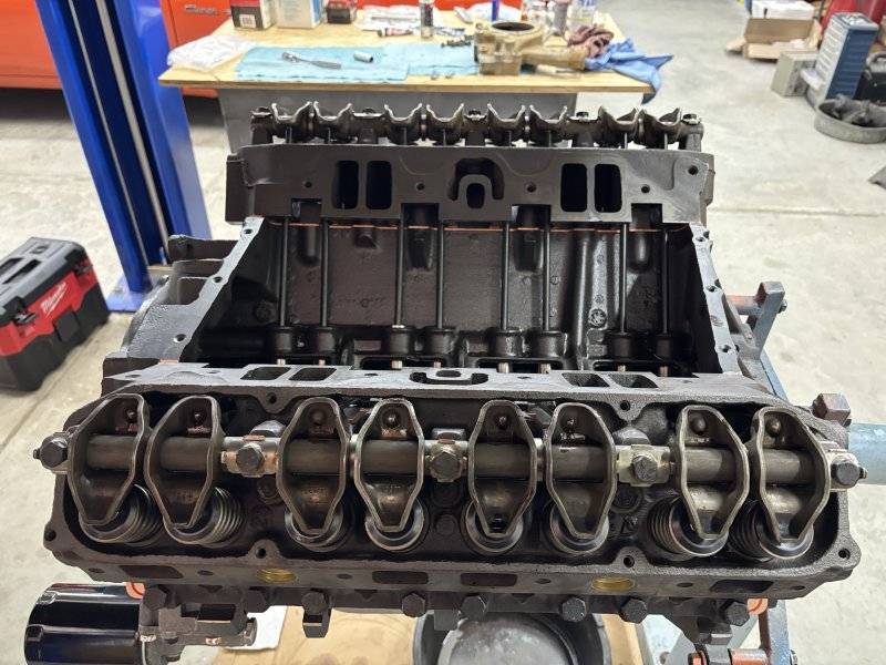

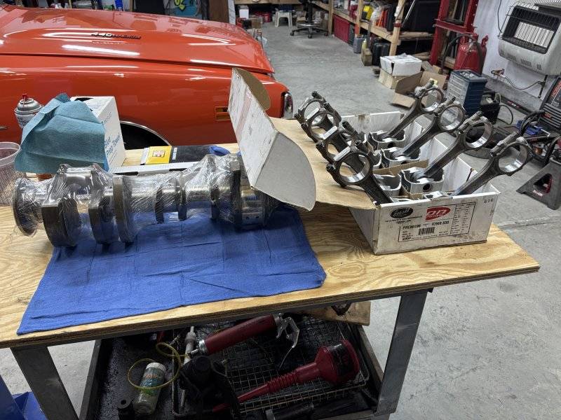

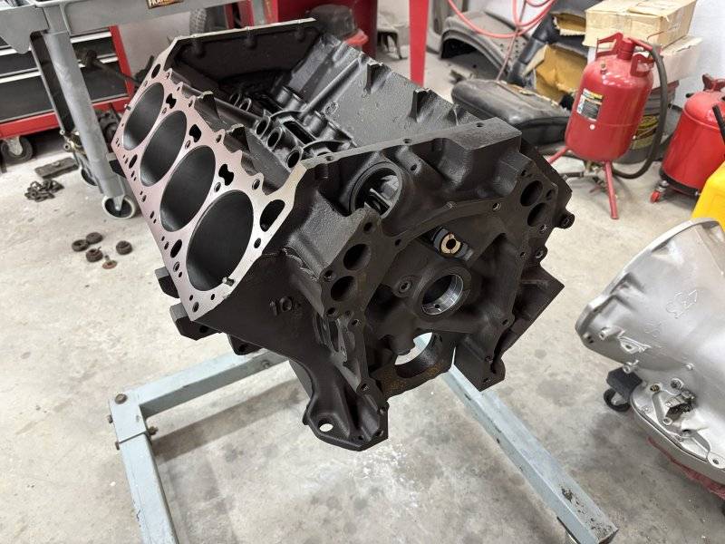

I checked it and they are .022 above the deck. With a .039 compressed gasket and assuming 88cc's with the 452 heads I am looking at 10.2-1 compression. Now I might want to rethink the cam.Aw come on now those slugs are supposed to be .2 down in the hole! That'll work a bit better for sure.
