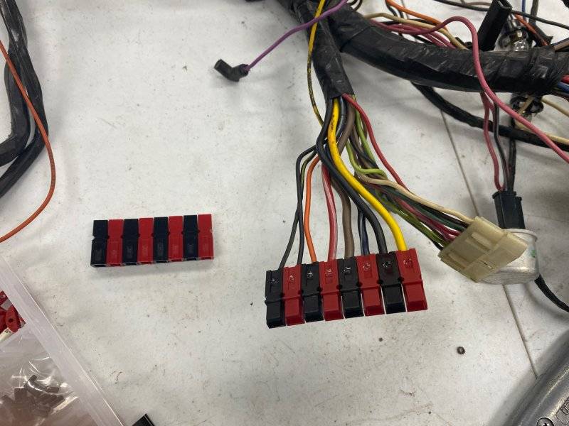

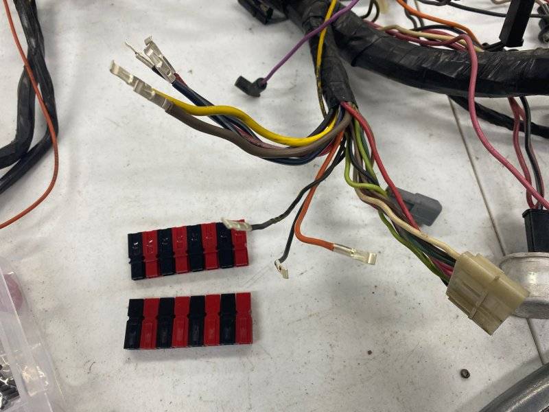

I had to address the burnt connector going to the ignition switch, tested the switch and its good. I cut the connectors off ans used Powerwerks powerpole connectors, https://powerwerx.com/anderson-power-powerpole-sb-connectors. These can handle the current as well as allow me to disconnect the column if needed. I also changed out the broken connector on the turn signal harness with a spare I had. Now I can install the harness onto the dash that's been so patiently waiting.

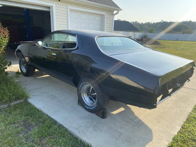

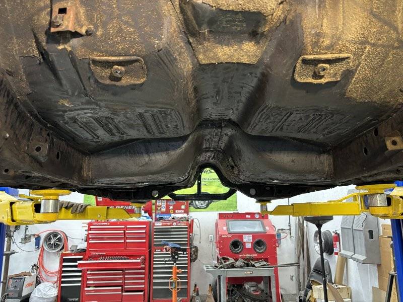

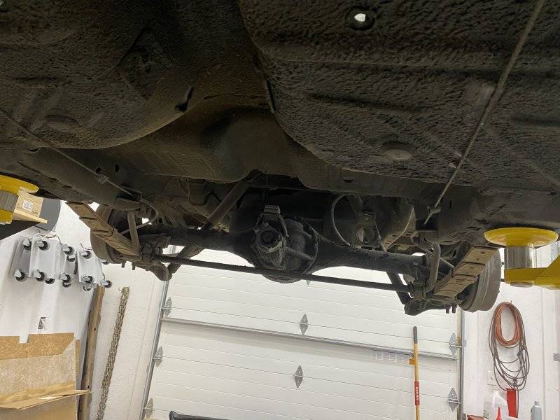

Got it moved and on the lift today. Now to rip everything underneath out!

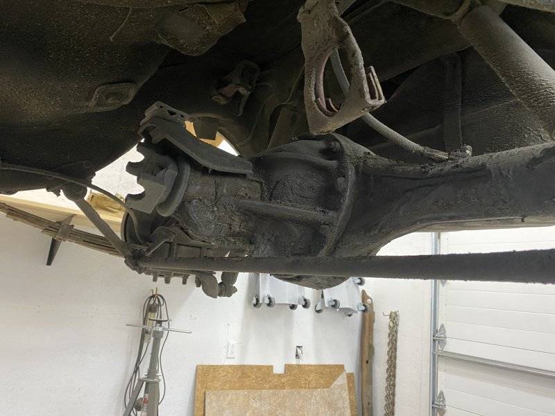

Man what a leaker it was. The entire underside is preserved with a thick coat of greasy dirt. No rust anywhere, even the trunk drop downs are mint.

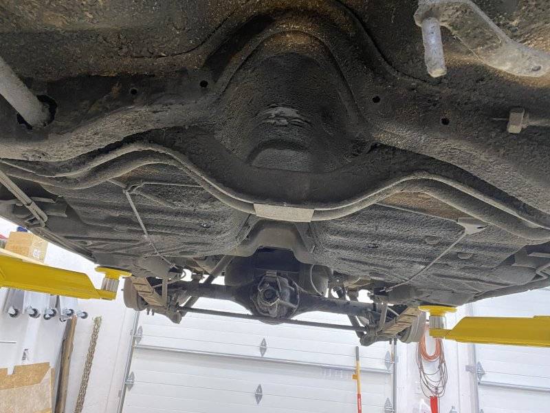

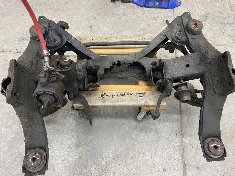

Got the k-frame back from the powercoaters and it came out great! Made a dolly to fit the 73 up k-frames so I can install from underneath. Today I dropped the old k-frame and rear end. Now I can get all the little stuff off and scrub off the gunk.

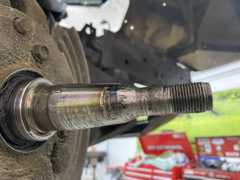

When removing the front brakes I had to pry the right rotor off the spindle. It was smoked. Had a new bearing on it though so they must have slapped it back together and ran it. Kinda like the k-frame. Don't have the right oil pan? Torch it!
A quick search of the classifieds here and a new spindle was found.

I started scraping away at the underside, was kinda tough after the Carlisle hangover and a tough work week. She is pretty much stripped underneath, only the tank, fuel and brake lines left to pull. Time to scrap, clean, and paint lots of parts.

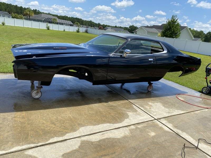

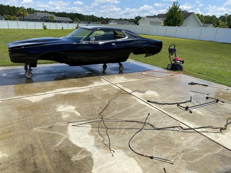

Got tired of scraping grime so I soaked the entire underside with straight Simple Green, tossed on my dolleys, and pressure washed the whole thing. Plus the brake and fuel lines, and sway bars.
I think I will keep the factory undercoating on it and just touch it up where needed. I will be a driver tha will be a b$%ch to keep clean.

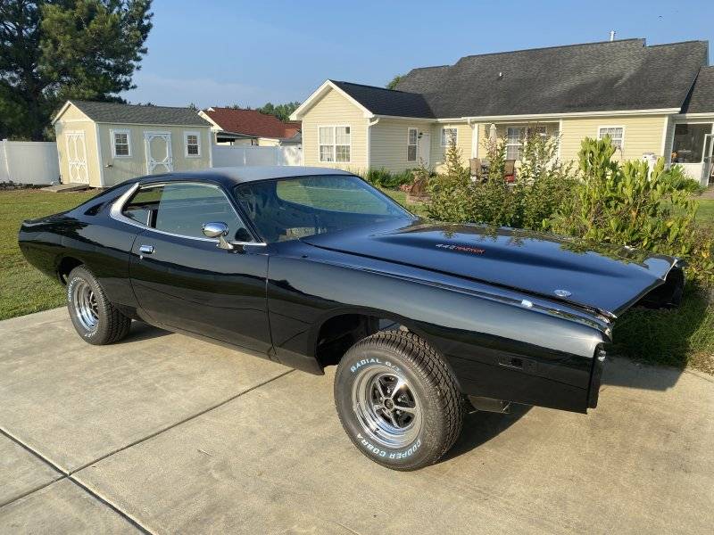

View attachment 1508723View attachment 1508724
You kill that pretty grass, Mamas going to be pissed. :poke:

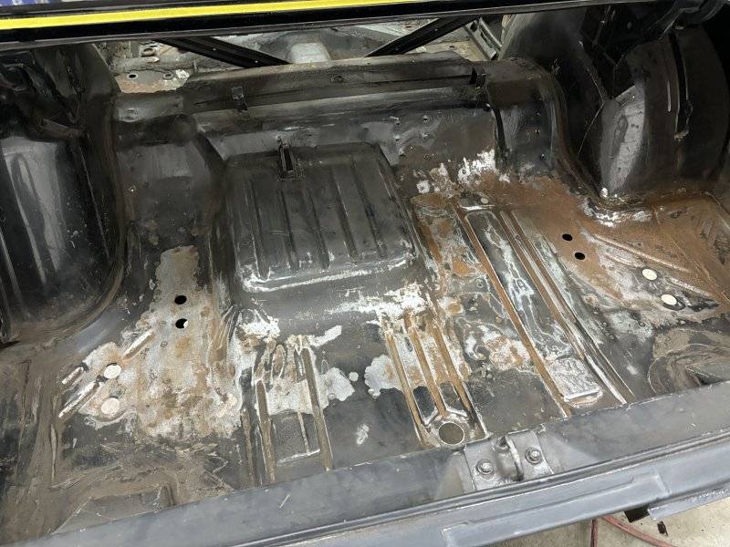

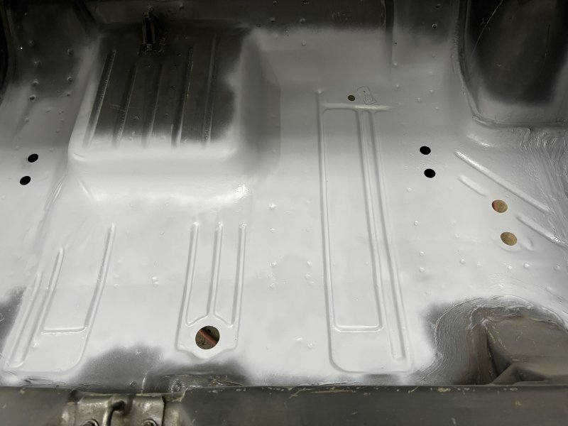

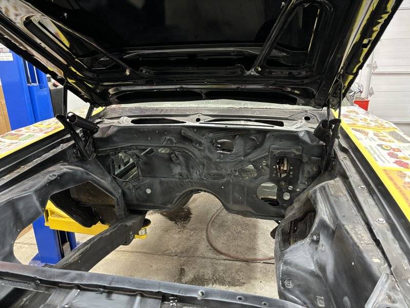

Still plugging away at it. I am done with the undercoating and started on the engine compartment and trunk to get them ready for paint. Engine compartment was half *** painted and the fender bolts were all unpainted and mixed and matched. I installed the correct bolts and prepped it for a fresh coat of paint then started on the trunk. Coming along good and hopefully I can get some Rust Bullet down and epoxy over it next weekend if its warm enough. It was fricking 18 degrees here this morning. Fortunately we only get a couple days like this a year.
Got the Rust Bullet down on the areas with heavy surface rust. New seam sealant and a light coat of primer to bite into it since the re-coat window is 48 hours and it will be a while longer before I am ready to paint.

I hope I get that lucky with the inside of my trunk floor.
