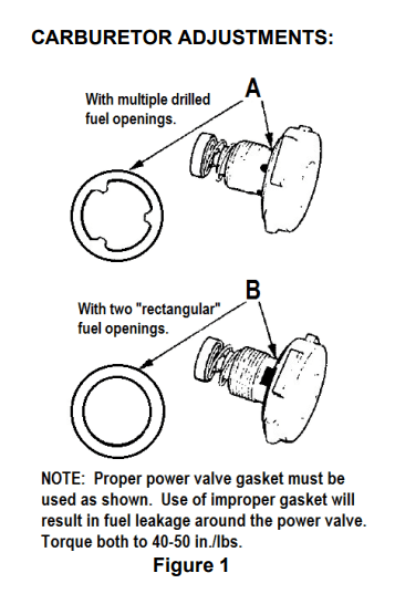

So im wondering if I could get a 650 or put a smaller power valve? I dont even recall what size power valve was put inside. Would a smaller power valve help that?

The 750 is not too big. If the pv is leaking internally, it could present those symptoms.

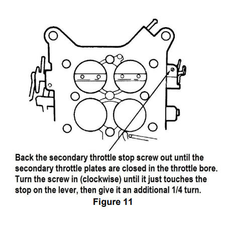

These guys are in the right track. My first guess (also) is the throttle blades open too far so that you’re idling on the main fuel circuit and not the idle circuit. I believe there are slots inside the front barrels that should not be un-covered. Six pack guys often drill holes in the throttle blades to get more idle air flow with the throttle blades more closed (to cover those slots)
Drill holes in the throttle blades.
You can try adjusting the secondary throttle blades open more at idle, which may be enough.
Also make sure you have the correct power valve. Big cam may cause low vacuum at idle which will open the power valve and be too rich.
is the primary blades adjusted by the idle screw? If not how do I adjust the primary blades? I do recall there was no screw at the bottom for the secondary blades, the hole was empty. I only realized after that there needed to be a screw there but I wasn't sure if secondary mattered at idle? Being no screw there the blades would be fully closed. Could be one of the reasons? The fuel level in the bowls are good.
There should be a screw there. It could be a reason.

In my experience adjusting the secondary throttle idle screw can get you in the ballpark but is very touchy, maybe because there’s no idle circuit on that side.
So open it up until you can make adjustments with the mixture screws then fine adjust idle on primary side
ya ill try putting an allen screw so i can adjust it while the carb is on the car if i need to
Sounds like your power valve is leaking. Maybe a good cleaning while you are in there changing it.

the only thing i didnt check was the power valve when i put it in. i used the quick fuel 300-2 rebuild kit im not sure what power valve comes in that kit if anyone knows
? i tried to look it up but no reference. The jets at the time i was putting it back together i looked up what they recommended and i think 71 and 73 sounds from what i can recall. if there was no screw for the secondary wouldnt that fully close the the secondary blades? is the screw used to open it more ?

The wrong power valve does NOT cause a rich idle! A leaking PV will!

That cam in a 383 is going to NEED about 25* of timing at idle. Possibly more; less than that can cause your problem, which is likely the pri blades open too far. Increasing idle timing from the generic factory setting will increase idle rpm; this, in turn, will allow blades to be closed further so that the idle cct works as designed.
