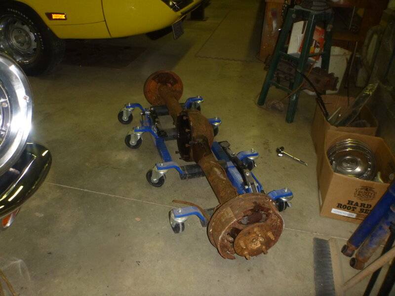

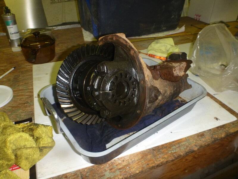

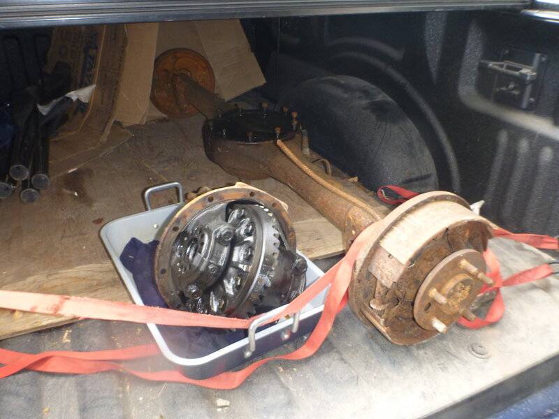

Search, find, buy and restore. Housing c/w axles cost me $675 and the 3.23 Sure Grip cost me $600. All the parts from Dr Diff to clean up and put brakes on it another $300 or so.
