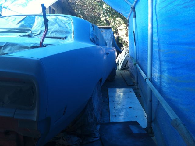

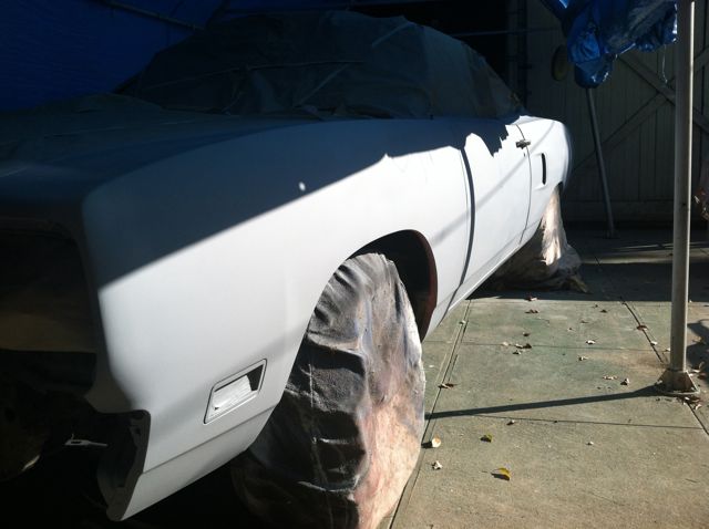

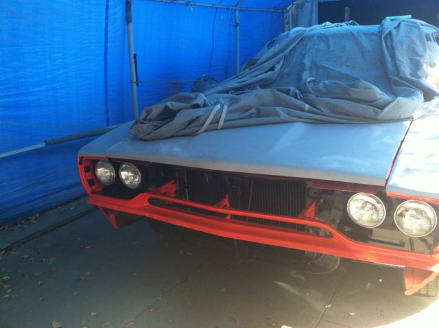

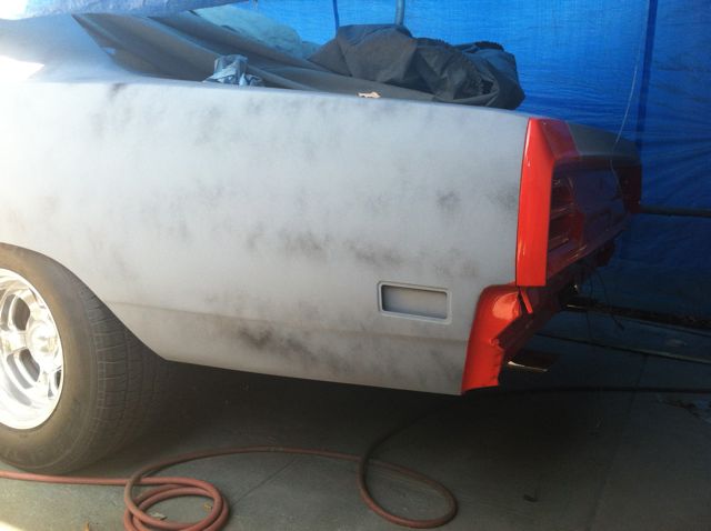

Latest on the Runner. She's in final primer now with a sanding in 180 grit (Do I have to change the name of the thread now?). The lines on the car look great now- especially the area around the side scoops. Also the underside of the hood and deck lid are painted - As much as anything we were checking the color, and those parts are off the car anyway. Next is one more guide coat and a final block and sand with 400 grit. THEN PAINT!
Sorry for the shadows in the photos. Oh, and the 1970 engines weren't blurry, just the photos of them...

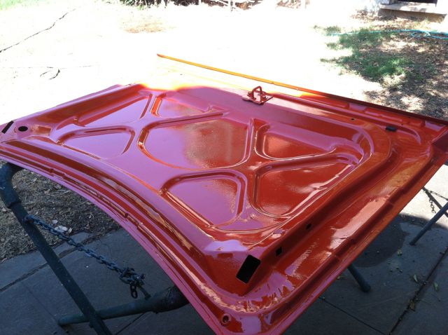

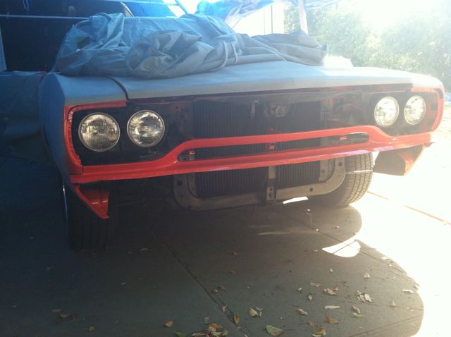

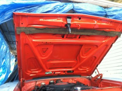

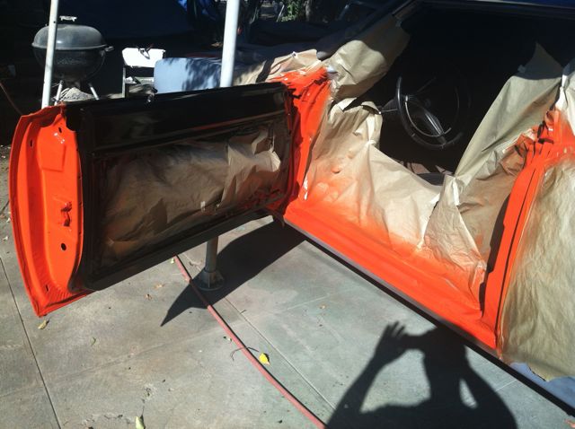

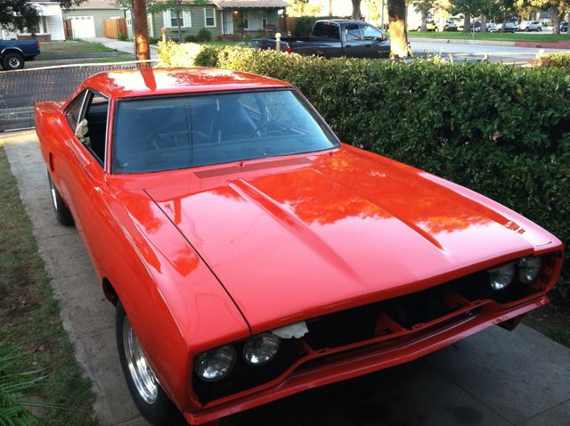

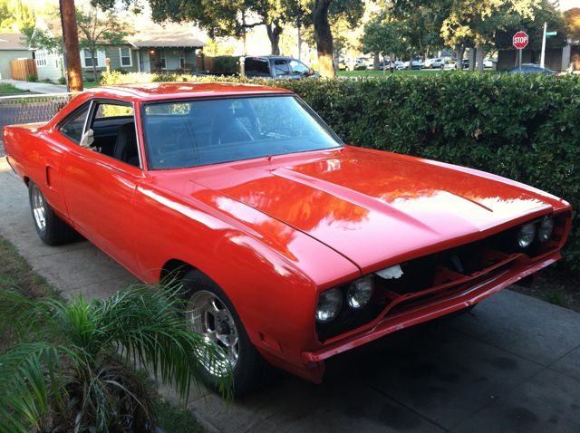

I'm getting antsy and I may be wasting your time with another update. But: LOOK AT THAT ORANGE! (I like to take all my photos under a blue tarp - half in the shade and half in the sun. It makes it kind of a challenge for the viewer. You should see my wedding photos...)
But LOOK AT THAT ORANGE!
These pics are of areas that are already painted AND clear coated, so that's pretty much the final color - albeit before color sand, buff, wax, etc...

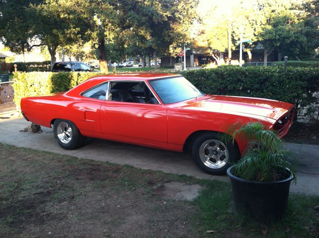

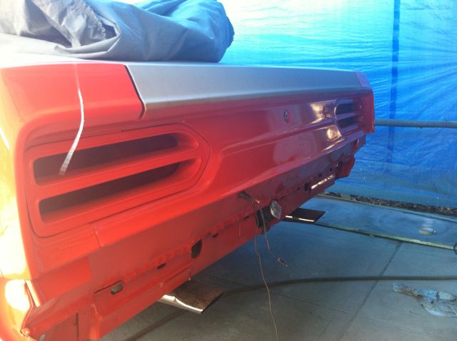

The car is painted! It took 5 coats of color and 4 of clear before it looked the way my buddy (the painter) wanted it. That's 5 quarts of paint! It still has another round of blocking with 1200 grit and then a final with 2000 grit, with time to harden between each. This is supposed to get rid of the little bit of orange peel that forms in the clear. Next we'll do the black Organosol stripes on the hood and add all the decals.
The color is unbelievable. The paint looks so wet I was afraid to touch it. It's crazy how different the car looks. When I first drove up I thought he had changed the wheels! Everything looks different...
Man she looks SWEET! Congrats on getting this car done in a relatively short time frame. I'm sure if you can keep it out of the weather it will hold up for quite some time. Just goes to show you don't have to tear one apart, down to a skeleton, and spend a mint, to have a nice ride. Good luck getting it all back together and keep us posted.
