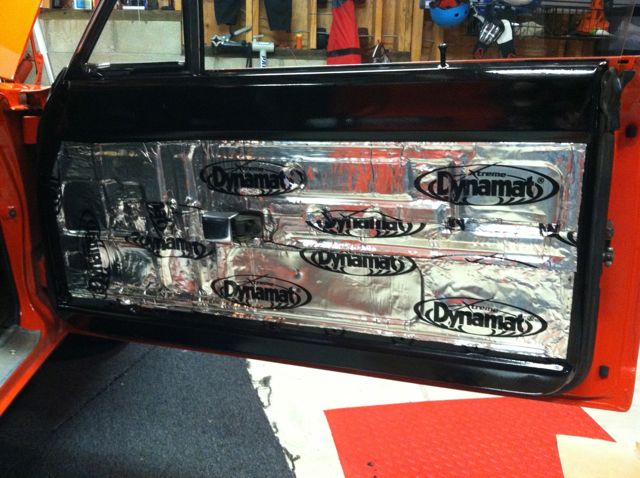

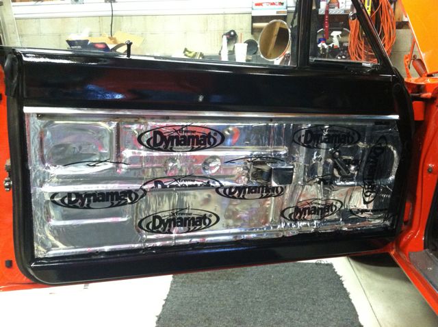

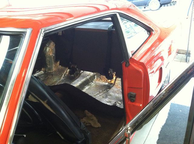

Here we go. Now that the paint is finished, I'm on a: "This XYZ is bugging the !@#$out of me" kick. The first thing that really bugs me is the rattling doors, oh, and the noise from that cavern of a trunk. The door lock mechanisms and the window regulators just sit in there and rattle. And the trunk sounds like a bass drum. Enough.
I tried out two sound dampening products this weekend - mostly because they were available locally. The first is called STP, and I used it under the rear bench seat and on the rear fender wells inside of the car. The second is Dynamat Xtreme which is sort of the household name for this kind of stuff. The STP came in large sheets and I did the whole area under the rear seat (all the way forward to the carpet) and up the rear trunk divider all the way to the top of the fender wells. That was with $88.00 of STP. I bought the Dynamat as a "2 Door Kit" and it came with about 2/3 as much material as the STP did - for $99.00. It's definitely more expensive, but all in all I'd say the Dynamat is easier to use. It is more durable when forcing it into the curves in the sheet metal (less tearing) and it seems to mold into itself (smooth where edges overlap) better than the STP. All together I probably added about 40 pounds of insulation to the car so far. The doors were a lot more fun (sitting on a stool) than the back was - crawling around on my knees in the back of the car.
I haven't driven the car since I did the insulation this weekend but I am impressed with the improvement in the doors already. They close like the doors on a new car - heavy and solid. Thunk, not crash/rattle.
Would it have been better to roll that Dynamat on the inside of the door skin? There's access holes to get your hands in there, right now you're blocking these holes with the mat, right? Not busting your balls, just wondering...
Hey Donny,
I had intended to do as you describe originally. Then when I bought the Dynamat Door Kit, I saw that the instructions actually recommend mounting the material on the inner door skin - as I did. The cost of doing that is preventing access to the inside of the door. To overcome this I reworked a lot of the inner door workings as best I could in advance. I then figured that I could always cut away the access holes as needed in the future and replace w new Dynamat patches. It would cost some money, but I don't expect to be inside the door panels TOO often.
The benefit is that the material isolates you from the sounds INSIDE of the door. To me, it's the rattling of the door workings that was most annoying, and boy is it gone now. Six of one, half dozen of the other I figure. Only time will tell...

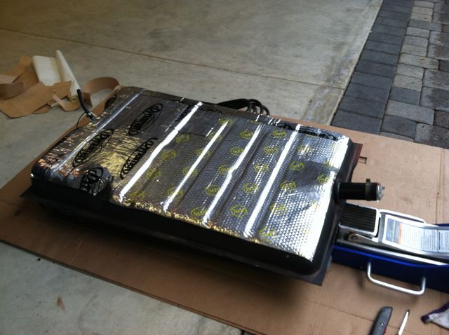

Well I'm still on the "Things that drive me nuts" path, so I dropped the fuel tank the other day to get rid of an annoying rattle between the tank top and the trunk floor. See I decided to re-use the 40+ year old mat which goes in between cause it was "kinda cool". You should never do this. It will just fall apart and slide out from between - and it leaves an awful rattle at idle between the two pieces of sheet metal. But not any more! I know I know. Dynamat is heavy. But it's QUIET!

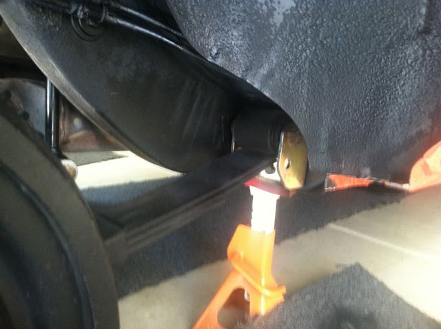

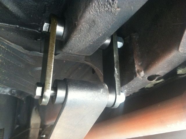

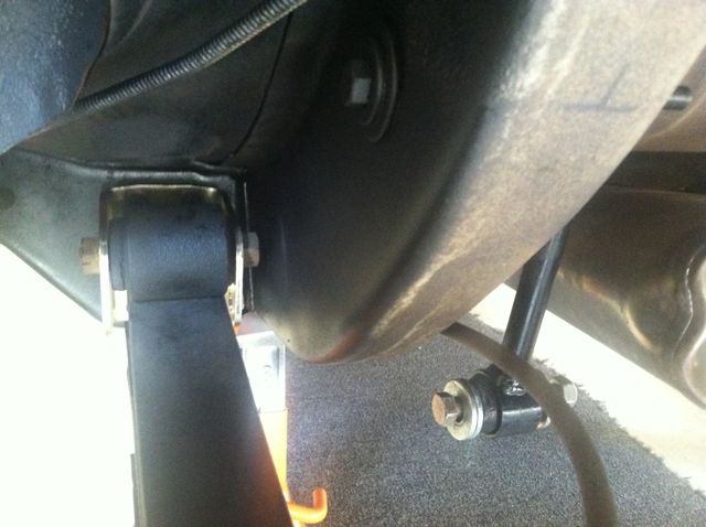

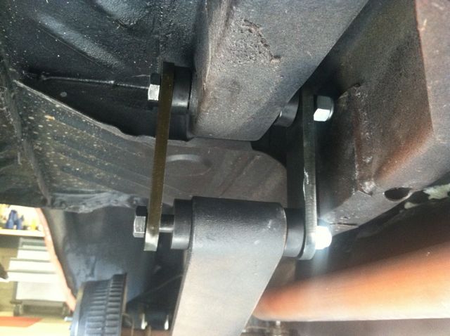

And then I got on with my plans to try to build a car which can perform in the Silver State Classic - while staying ON the road the whole time at 100+. I recently added a Hotchkis rear sway bar which you'll see (disconnected) in the pictures (my only non-Firm Feel suspension part - too good a deal to resist) and my next move was the addition of two-position rear spring mounts and shackles from Firm Feel to go with my Firm Feel front end. Both sets of parts (Shackles, Spring Mounts) go on easily, but the spring mounts DO require disconnecting both the sway bar and the shocks to allow enough play in the axle to remove the mount from the spring. As you can see in the photos, you have to remove the spring mount from the car WITH THE SPRING STILL ATTACHED as the bolt which holds the spring runs from the inside (where it is "pinned" by the frame rail) to the outside.
The pictures of the shackles were taken before I tightened the bolts, so they appear (and are) loose.
Using the upper spring hole on the Firm Feel spring mount gave me a drop of 3/4 of an inch measured at the rear axle (Firm Feel says it's good for 1 inch) but that could be at the rear bumper. I haven't actually driven it with this change. I'm hoping for free-er rear spring travel with the new parts...
Note the piece of 3/8" steel bar stock welded to the outside of the frame rail in the last picture - pretty sure someone had a trailer hitch welded on there once!

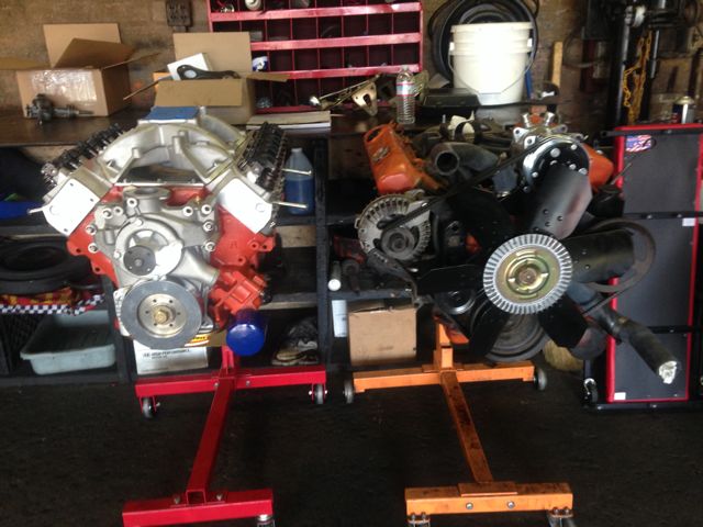

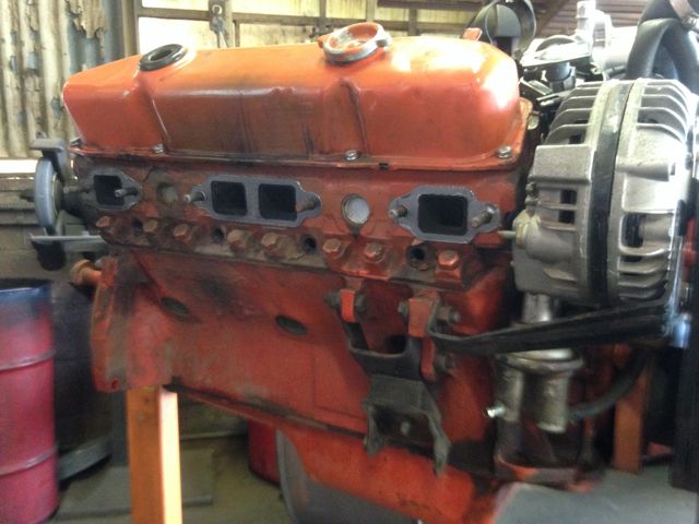

I've been off this thread for a while and working on my "Road Racing Engine" thread, but time for an update on the build.

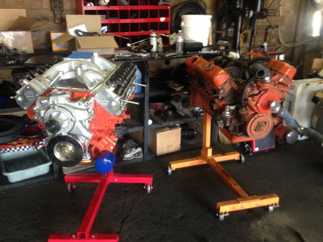

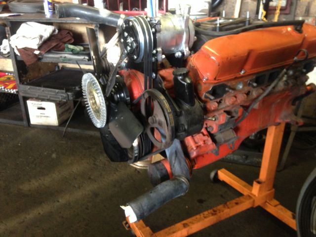

It's out with the old and in with the new. Here's the engine that hasn't been out of the car since '96. It looked better in the car!

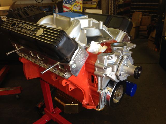

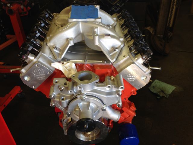

And for those of you who haven't been on my other thread, the new one going in:

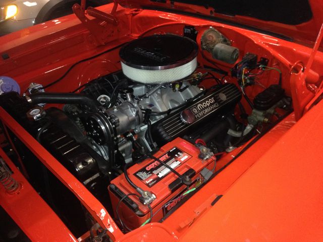

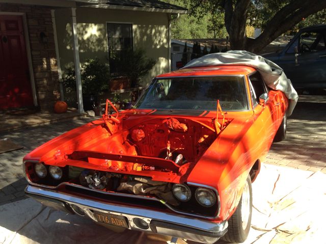

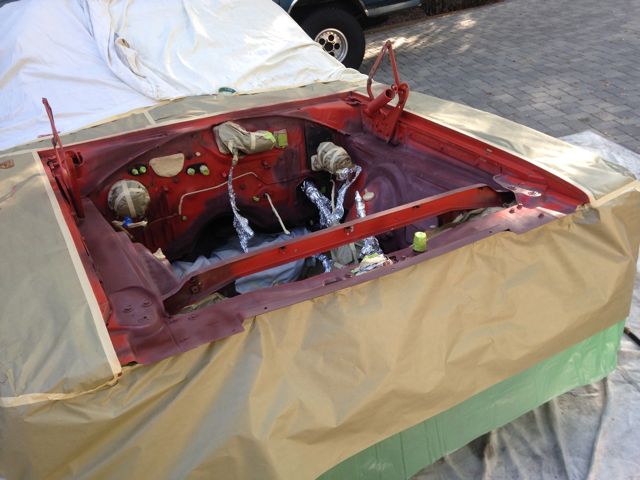

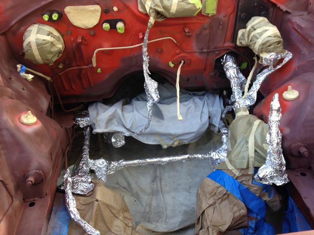

While I have the engine and trans out I took the opportunity to clean and reshoot the engine bay. Boy there are a lot of parts in there when you have to remove or tape them all. A buddy of mine helped me with the painting again - like everywhere else on this thread... I hate painting! I had spent hours last night taping plastic around every little wire when he showed up this morning with the best painting trick I've ever seen... TIN FOIL! It'll wrap around anything, stay without tape, stop paint and it comes off with just a tear. Take a look in the pix. GENIOUS!
We used red primer because the high-dollar orange paint doesn't cover very well, and the red "hides" under it better than gray primer did.
Yup. That's what it looks like in California in mid-November. Sort of like Mid-February, and mid-May, and mid-July...

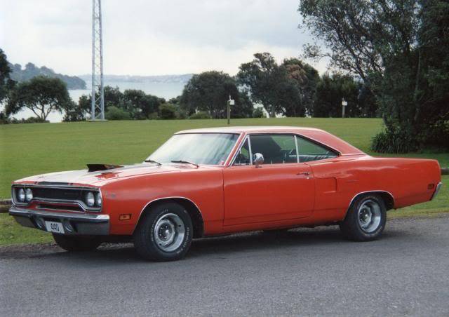

This was my '70 Roadrunner - 440ci, 4 speed, bench seat, tow bar and loads of fun back in 1987;
I'll share some resto pics on that car some day soon :)

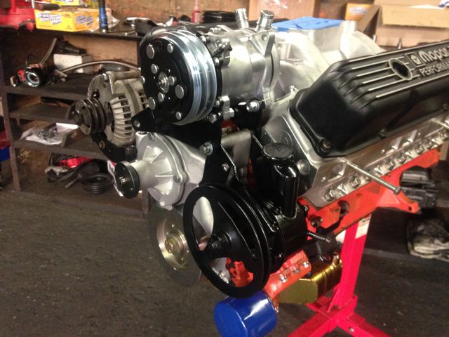

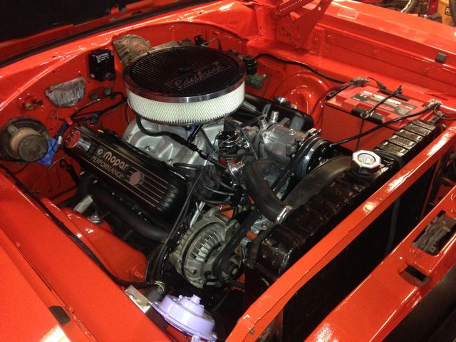

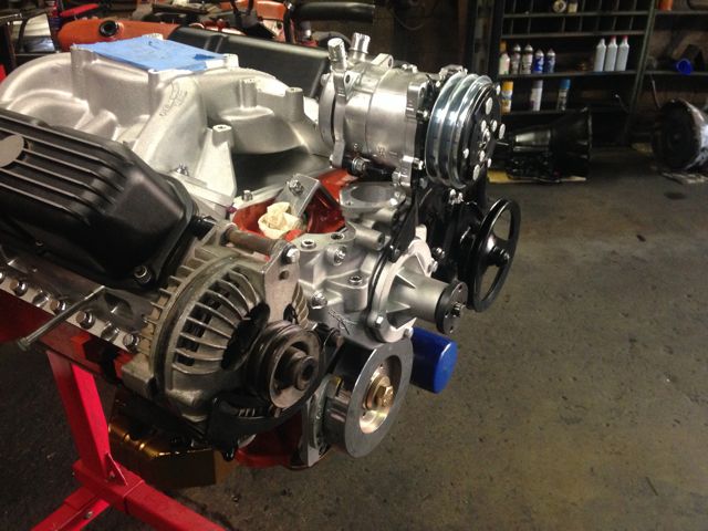

Here we go. Moving the factory stuff over to the new motor. Pretty soon she'll be "disguised" as just another dressed up 383 - with a 493 stroker hidden underneath! :icon_madu::icon_madu::icon_madu:
Yeah. I know. I need a new alternator. But I didn't want to add that project on top of this one...
