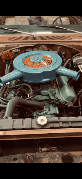

So I just swapped out my original 383 for a 440 with a performer 4 barrel and installed my air cleaner and pretty sure it’s not going to fit under hood. Just wondering why GTX came with 440 and same air cleaner and it fit. Is it my intake? Performer to tall?

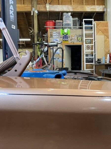

A standard Performer isn't very tall, Performer RPM is tall... How much curvature does the cowl have? Look straight from the top of the radiator to the cowl..... It's not uncommon for the air cleaner to sit higher than the fender tops but the hood has more curve/bulge that you think....

Okay I will check in the morning and try just surprised how much taller the air cleaner was I hope your right! Thanks

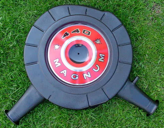

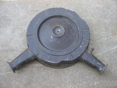

I think you have a 68 air cleaner, pretty sure the 67 carb has the smaller neck, 68 is the same as modern Holley's & Edelbrocks... first Link is a 68 air cleaner.
https://www.nicksgarage.com/aircleaner/68_383c_04.jpg
Second link is a 67 air cleaner... Notice the stamped ribs.... They are slightly different...
https://www.nicksgarage.com/aircleaner/67_440ds_03.jpg

I can't seem to find my notes from when I went through intake/hood clearance at the moment, but I believe an Edelbrock Performer RPM is almost 2" taller than a stock cast intake. I had to use a 1.5" drop air cleaner base along with a shorter element to get the hood closed.
I'm no air clean expert, but here are some observations:
1) The 440 Performer is 3/4" taller than the factory 178 intake
2) The original GTX air cleaner was pretty close to the hood. It left an imprint in the hood pad
3) Not all air cleaner bases are the same, and I think a "383" base will sit higher than a "440" base.
4) Some performance dual snorkel lids are taller than others.
You can get it to work, but you'll need to match up the parts.
