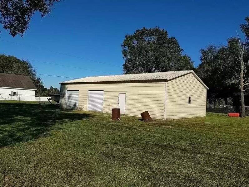

I'm closing on a house next month that has a 1500 sq/ft garage/workshop. Now that I have some room to work, one of the first things on my list to acquire is an air compressor. The shop is wired with 110, but there is no 220 service in it (at this time). I am looking for a compressor to run air tools and maybe a sand blaster or paint gun for small parts and pieces. I am not stripping/painting a whole car or looking at any other big jobs. Recommendations are greatly appreciated.
